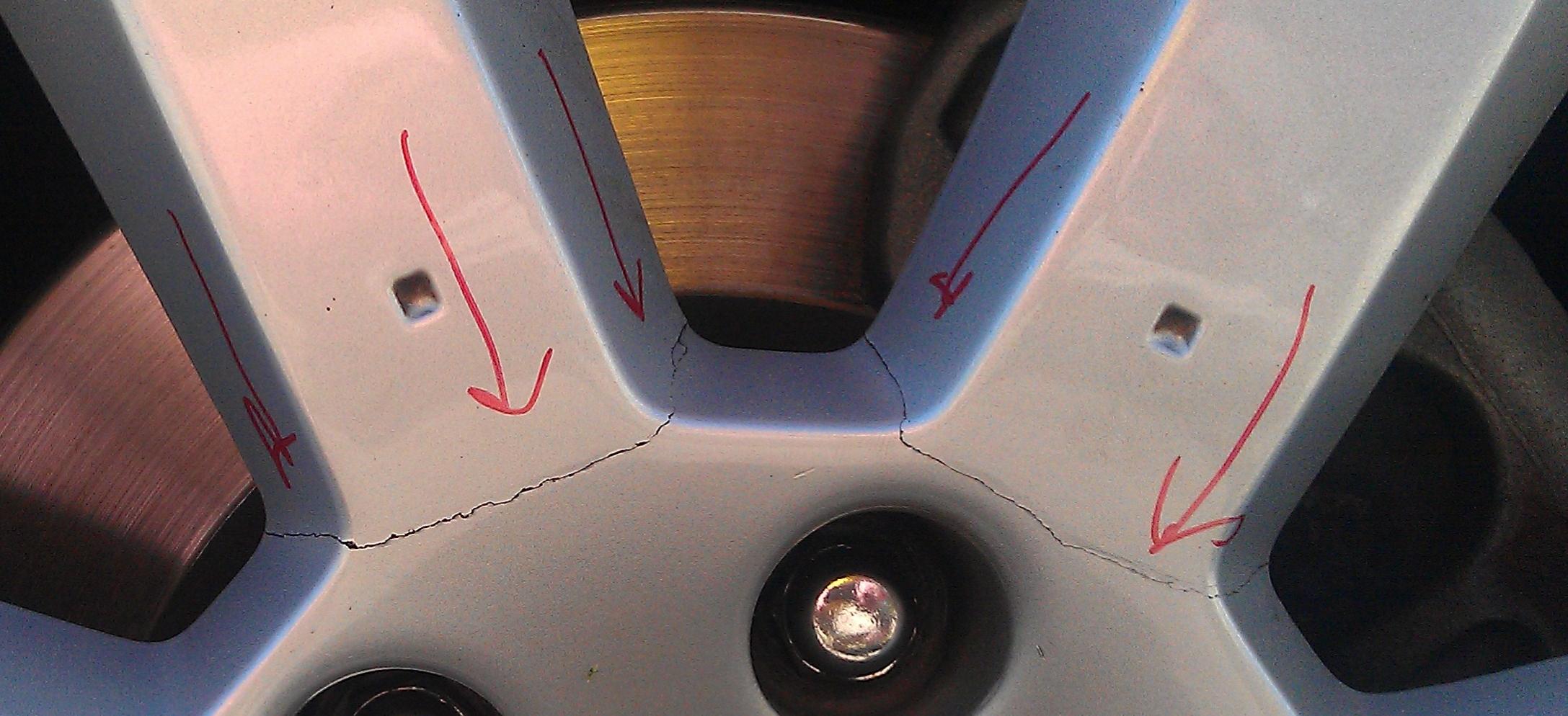

OEM wheels cracking.-imag0029.jpgOk i put a picture on here. My car hasnt ever been on a dirt road. Nothing stupid has ever been done. No 4wheeling. No Dukes of hazzard. just drive it on the road.

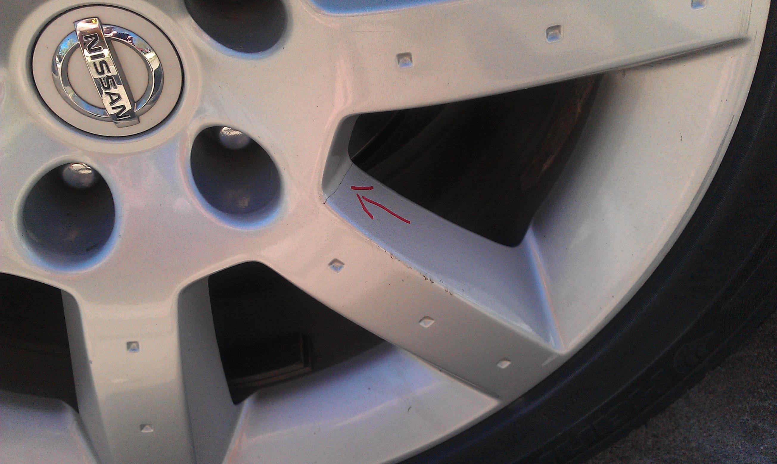

OEM wheels cracking.-imag0027.jpghere is the back wheel also.

When I said "off road" I meant like hitting a curb sideways or sliding off the road onto a soft shoulder. You'd be surprised what will damage the suspension. Same kind of stuff can damage the wheels. The fact that you have multiple wheels damaged is unusual.
Looking at the pictures, my guess would be damage from some sort of impact. Two adjacent spokes failing from stress seems almost impossible. At least NHTSA is willing to analyze them. If they give you results, definitely post back as I'm curious as to what they determine.

I havent ever seen a wheel fracture ever to tell you the truth. No impact. I am the only one that drives the car. As soon as i get an answer I will let everyone know. I doubt that it will be in favor of any Nissan owner. I do think that its funny.. if you look at the Chrome wheel that broke out in the picture. The cracks on mine are in the exact same place!
