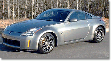

my first set of aftermarket wheels, in the 8 and 9" sizes. They were tucked in just a little too much for my taste though. This is with stock tires.

can't tell you, but they BARELY cleared the brembos. do the stoptechs stick out farther from the hub than the brembo's? thats where the clearance issue would be. (in other words, are they thicker than brembos?)
