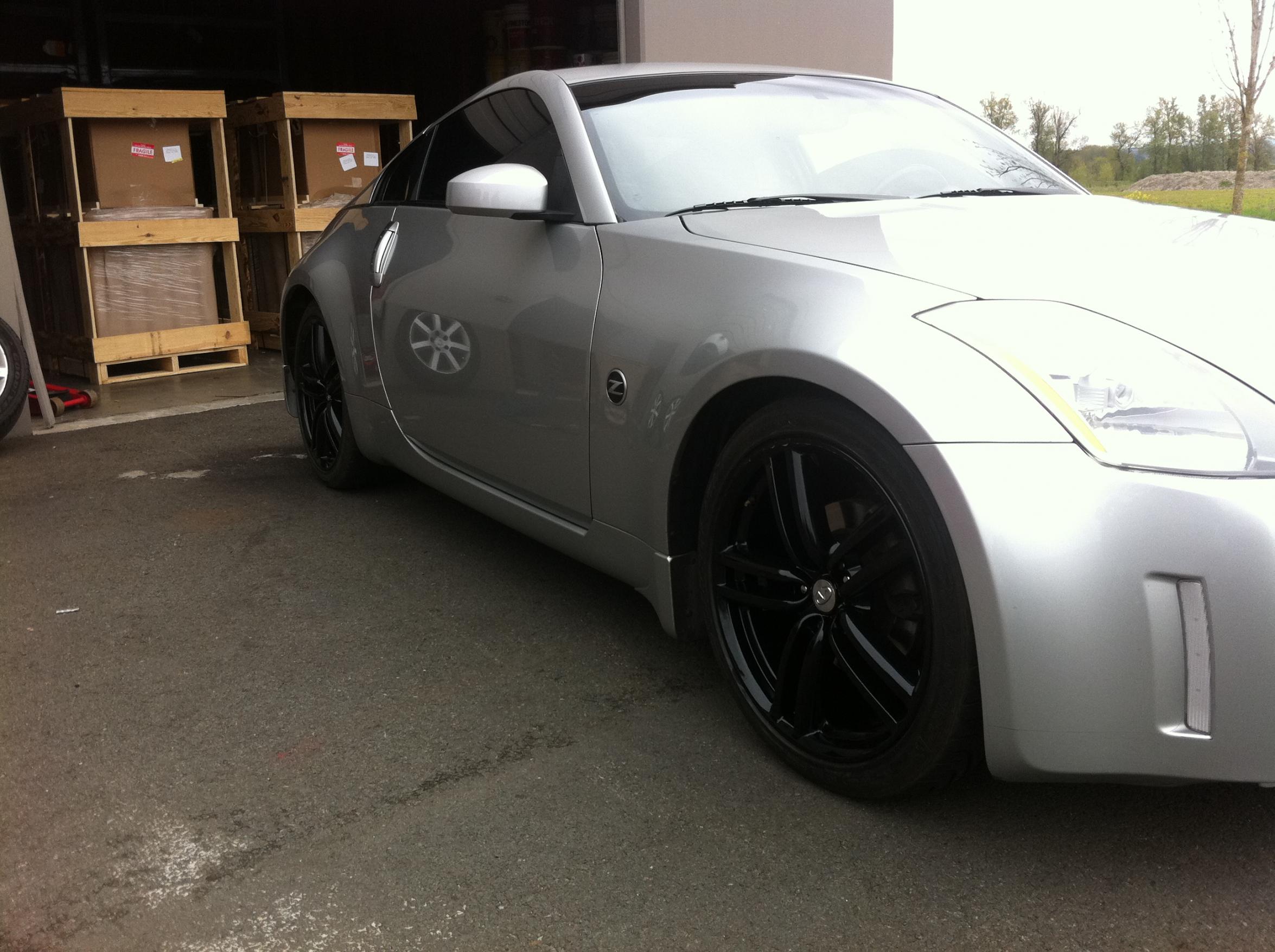

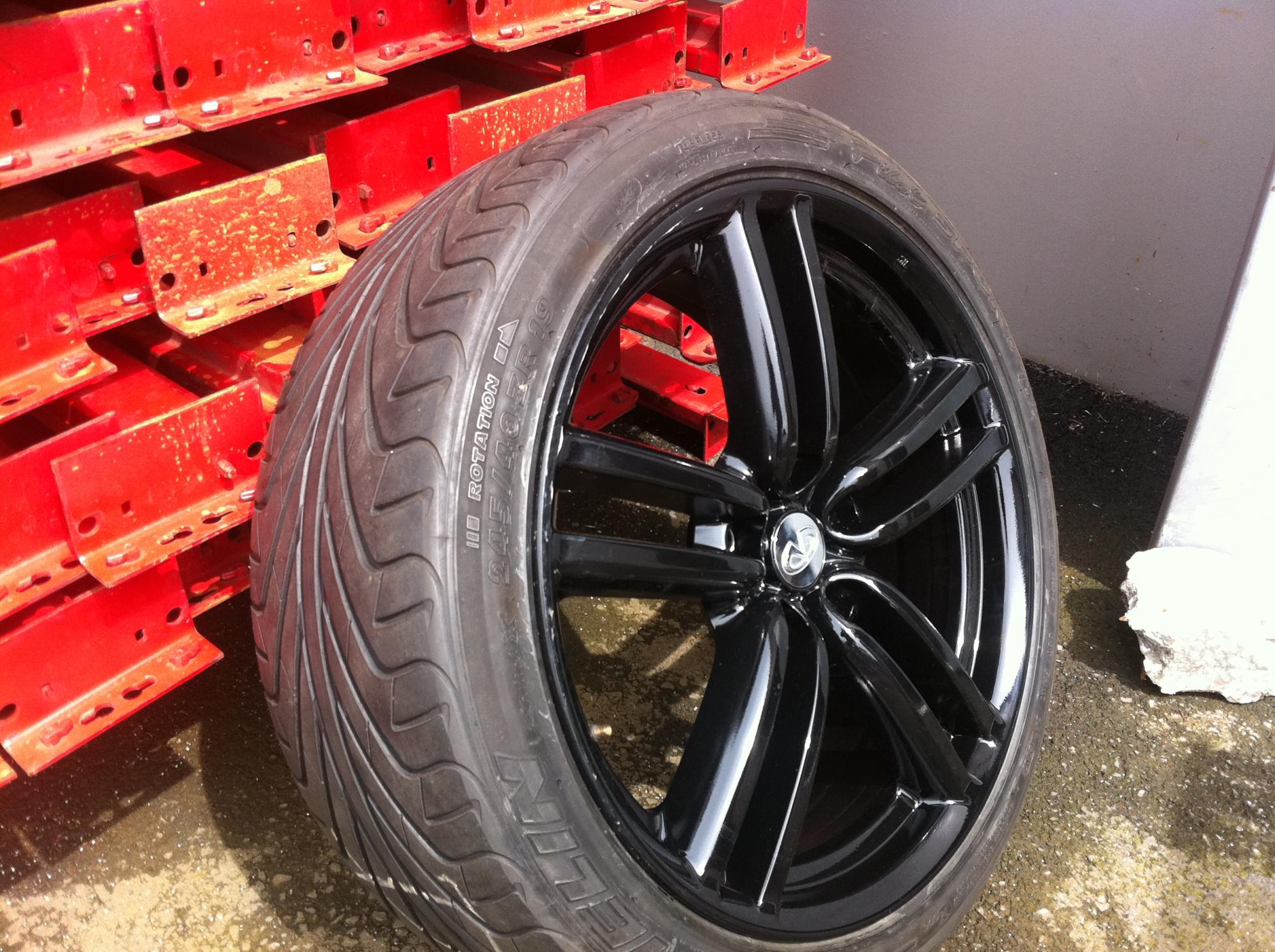

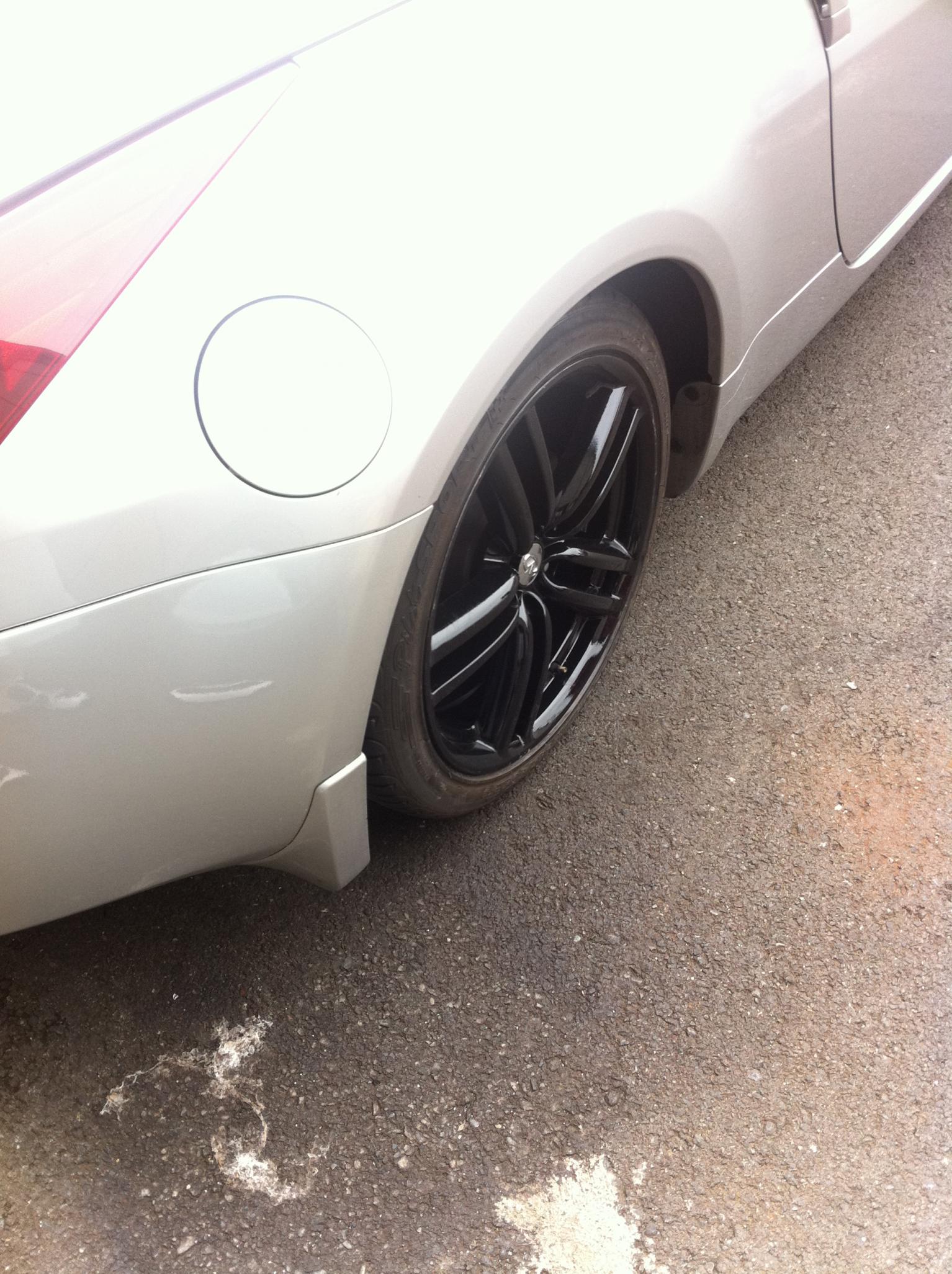

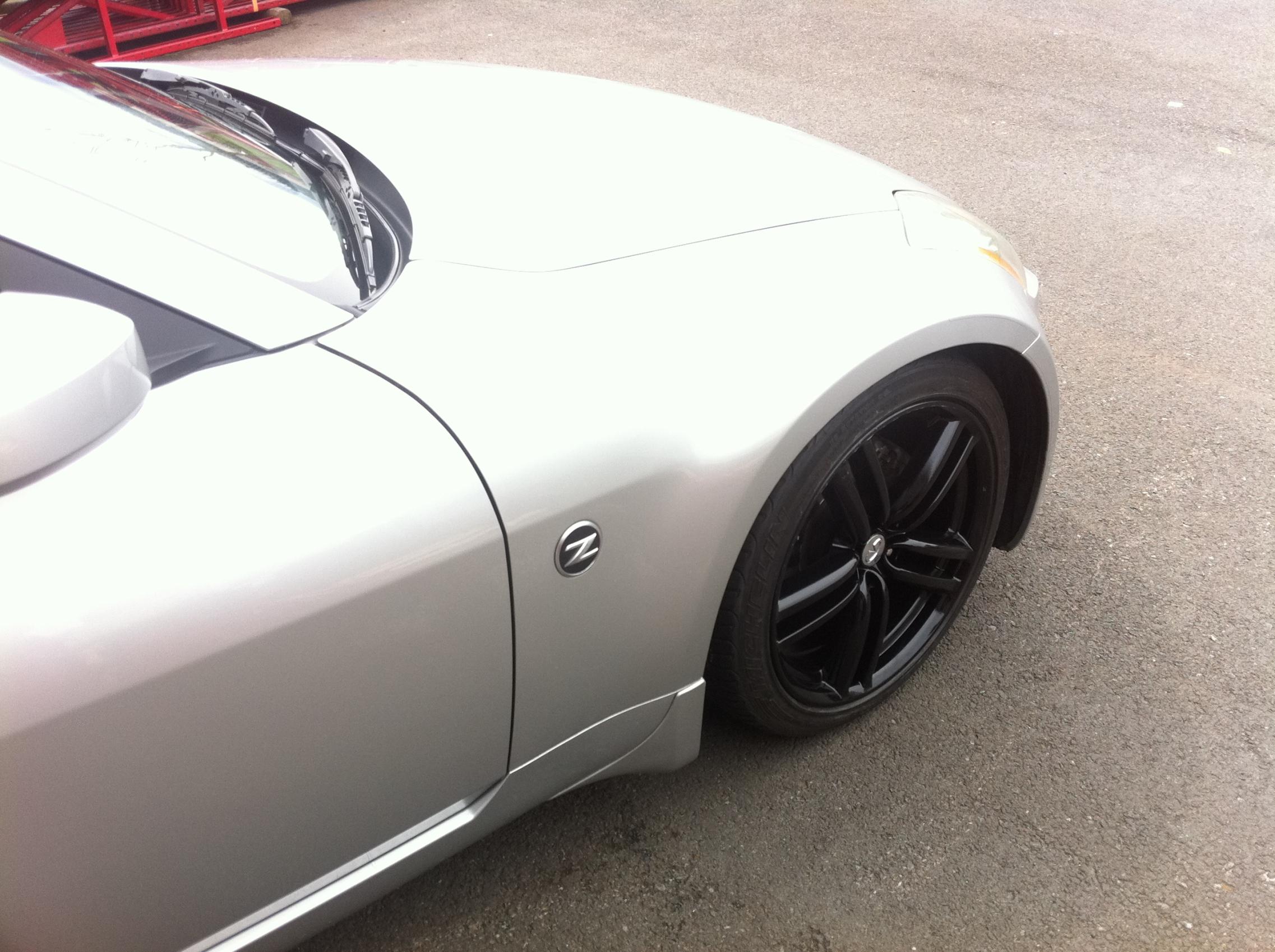

The offset is really high (+50) on these 19 x 8.5 wheels so I'm throwing 20mm spacers in front and 25mm in the back. These are the Infiniti M35/M45 sport wheels. Found these wheels for 600 on craigslist and could not pass them up. Previous owner effed up my stock 17s. They are painted black with 3 clears coats. I think I could sell them for double the cost I paid for if I don't really like them but I tried them on when I went to look at them and they look pretty nice, just tucked in quite a bit with out spacers. What do you guys think? I have pics of the wheels before the spacers, they should be here on Wednesday so I'll post pics later. I also have gf210's and Tokico Blues on the way.

I think you need 38mm spacers.

For a nice flush look, you'll need a net offset of around +10, give or take a MM. It depends on your drop and if you do or do not want to roll your fenders. I have 8.5 width in the front with a +11 offset and it looks good. not super flush, but close enough. I'm only dropped on tein s-techs (about 3/4 of an inch).

Are you started the Hellatucked club?? even with those spacers it will look bad....

Hellatucked club, haha. I personally think some staggered deepdish looks the best on the z. I'll try them out for a minute and see how they look. It will push them out to +25 rear and +30 front offset which I understand is not much farther out than the stock wheels. I think I can make money on these wheels because they are flawless and I was reading that a good set goes for 1500 so we'll see. Someone with a G will probably want them. They look great in person. I'm not putting them on until the spacers come because it looks retarded.
