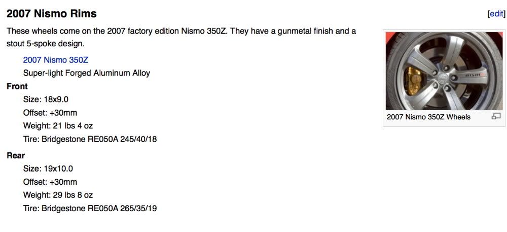

Welcome. Nissan has done all the homework for you. Here you go.
