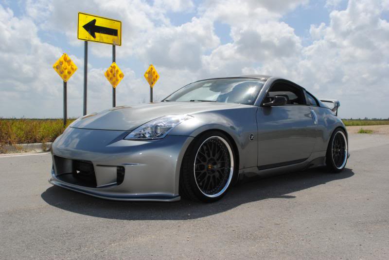

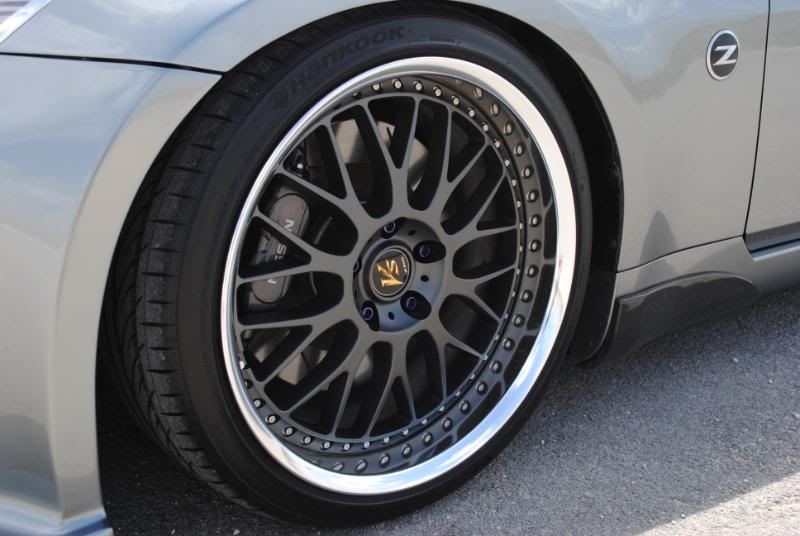

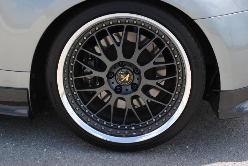

Your's will have a larger lip than mine... post pics of your brakes.

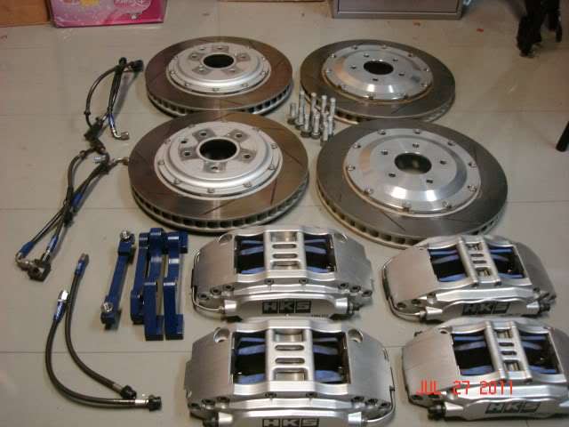

Just post a pic of the brakes so we can discern which one's you have either way... you can do the VSXX + BBK set up if you use spacers, otherwise your SOL.
