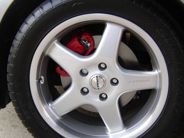

G-2 system is undoubtedly the best. Here is a pic of my calipers with the red G-2. You can get the paint from Tire Rack for about $38.00
Les

I brushed the paint but didn't use the brush that came with the kit. I used a small artist brush and the paint seemed to flow much smoother. The main advantage of the G-2 kit is you don't need to remove the calipers to do a good job.
