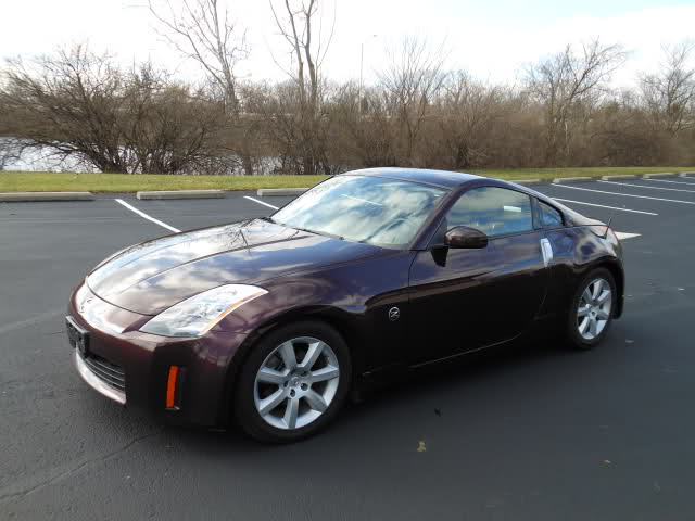

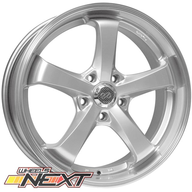

Alright so I've been searching to buy a pair of wheels for my car. I have looked through all of the options. I have a brickyard so I tested out all the different tones of rims such as gunmetal, chrome, black, and hyper silver. I have come to feel that hyper silver pops the most on a brickyard. I also read that the stock wheel for the 350z is 18in for the touring. Granted, I have never seen my car in person due to being overseas so I can't get a good look at how the car sits. I believe my car to be stock. I am currently looking at the Enkei Falcon's in hyper silver, but even after searching I am not completely sure what "offset" refers to and what spacers do exactly and if I would need them? Basically what I am saying is that I am completely clueless even after searching for a few days. Opinions on the wheels them self, if 18 inch is good or if I should pay the extra 300 dollars and get 20in, the spacers needed (if any) and any other details to make my shopping from overseas easier. I appreciate any help given. Thanks

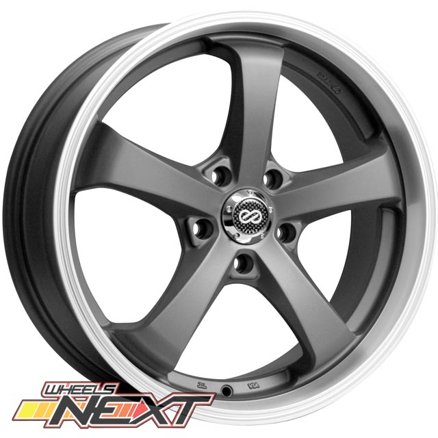

Here are the gunmetal ones as well.

Let's get some wheel guys in here! More than likely those wheels offsets wont be low enough for you. Don't press that buy button yet.

Just looked them up, walk away and look for other wheels, very narrow, offset sucks etc etc

I believe this is in reference to a PLUS offset...the distance the wheel is moved out towards the outside(nearer to the edge of the fender well).So,the larger number of the offset,the farther the wheel is moved OUT.
Your tire size won't work.The Z RUNS A "STAGGERED" set up.The rear tire is a bit taller than the front(about 1/2").Also,the rear wheel is wider.The OEM size
for 18's is:225/45/18 front,245/45/18 rear.If you are staying with 18's(depending on the new wheel width)an upgrade that would work is:
255/40/18 front,275/40/18 rear.
