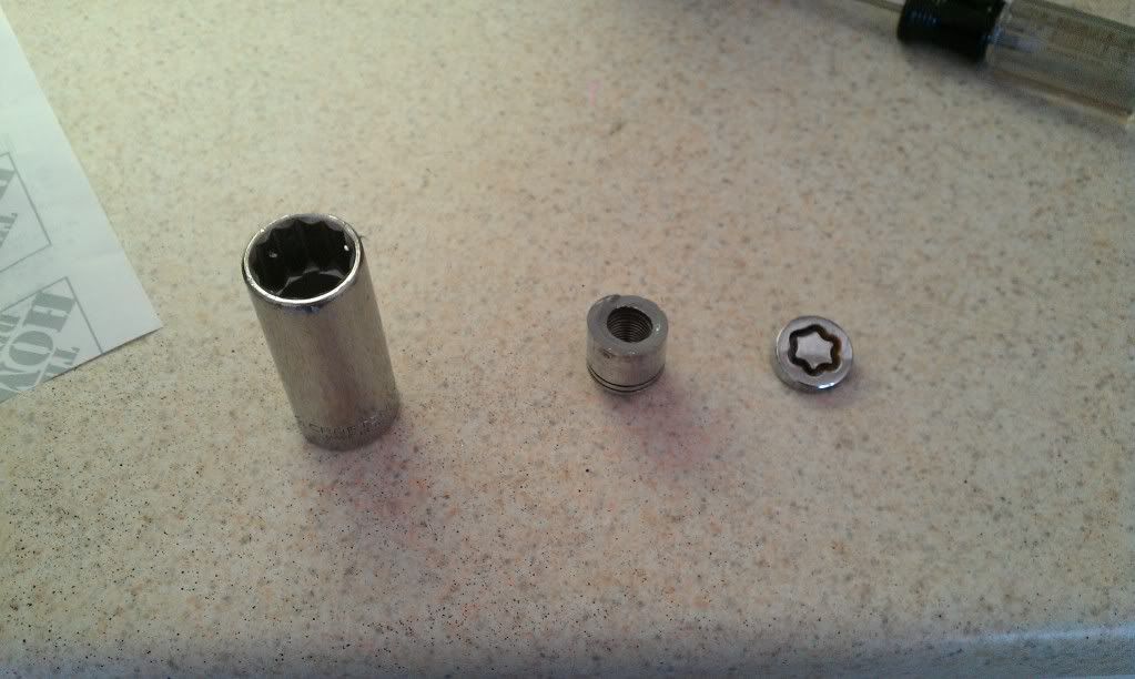

After closer inspection, here is what appears to have happened: the threads on the wrench adapter thing stripped, but only on the section of the lug nut that was threaded onto the stud. The end of the lug nut, which was empty inside, remained locked with the teeth of the adapter, and sheared off. As you can see in the pics, the threads on end of the lug show where it twisted as it broke.

Thanks everyone for your advice. I ended up pounding on a bunch of different sockets, trying to use a special tool with a swirl pattern, and taking it to 3 different shops before finally resolving the issue. In the process, another piece of the nut sheared off, and the remaining bit was worn down to a nub. It was possibly cross-threaded, because it never did come off.
Specialty Z has earned my respect by being the only shop willing and capable of sticking with this PITA of a job. They ended up drilling out the stud and replacing it. There were some scratches to the inside of the lug nut hole in the wheel, but I am responsible for most of them, and they are minor.
Here are a couple pics of the carnage. The first is the lug which is now in three pieces, and the second is the drilled out stud.
