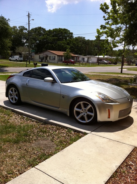

i did mine too with engine enamel but i have a couple notes to add.
1.)if you do not sand then use a primer, when you have new tires put on the rims, the machine is going to take the paint off the rim the shop should tell you this before they change your tires.
2.) sand before you paint. if you have any damage on the wheel if you sand it down you will hide most of the previous damage.
3.) make sure you get the engine enamel rattle can that sprays from any angle it will prevent a ruined paint job due to tilting can to far and no paint being sprayed.
4.) buy some wet sand paper (1500 or 2000) and sand the paint before you spray clear or final coat. this will remove any of the mistakes you made and leave you with a nice flat surface to apply your final coat.
5.) wait about 24 hours before putting your wheels back on or driving. if you try to put the wheels on before you will remove paint when you tighten the lug nuts, its going to happen if you dont wait. (use electrical tape around your lug nut wrench to prevent damage to the painted wheels)
6.) the more coats while using progressively higher wet sand paper in between the deeper and smoother the color will look on your wheels.
7.) if you are scared to change the color remember the silver your stock rims were painted is just a rattle can away, or if you like hitting curbs... sanding and silver paint will make your wheels look brand new.
8.) these paints usually require 7 days to fully cure so be easy on them for the first week.
its amazing what can be done with a rattle can of black paint.
