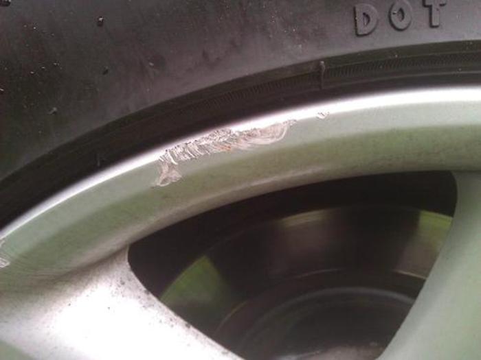

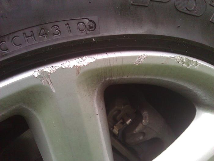

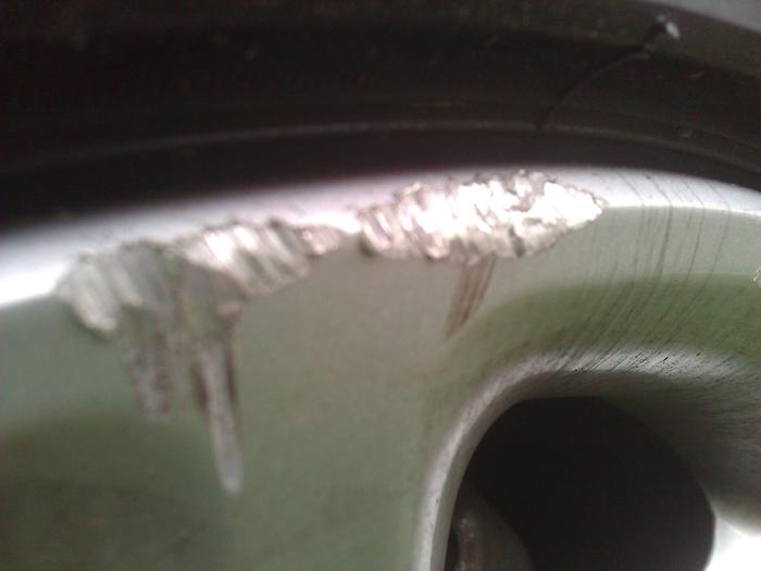

Hey guys! I uploaded three pictures of the damage that I... Foolishly caused. Oh and..

What are your suggestions now that you guys can see the damage?

could of gotten an 07-08 model for that price. But if you prefer the DE engine that isnt a bad deal if its everything you wanted. So as long as your happy nothing to worry about. Curbing doesnt look too bad any wheel repair place should be able to make it look brand new
