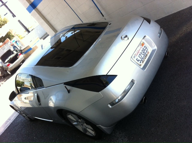

So yes I'll have a 04 Touring with the 17"s..hahaha laugh it up!
IMO, so far my car looks pretty damn clean!
ANYWAYS, I'm trying to get that "flush" look I keep seeing, my question is what size spacers do I need?

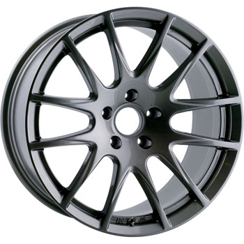

terrasmak- I'm not into the five spoke so much, but I know what you're suggesting.. I'm really diggin those 5Zigen ProRacer ZR+250 in hyper gunmetal!
They have 17x9 if that works, but I see no offset and won't I need new tires?

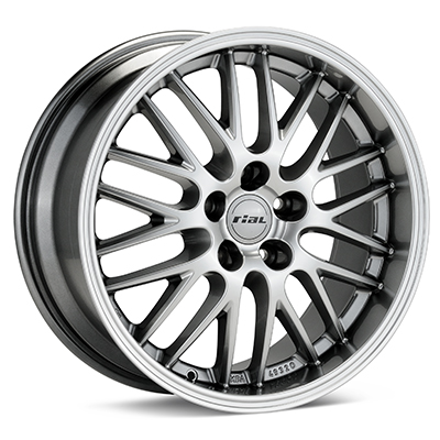

These Rial Norano's, there 17X8 w/ 35mm offset f&r look REAL tasty, I have to call discounttire tomm and cancel this previous order ASAP

http://www.5zigen.co.jp/english/prod...l/zr_plus.html listed on the website. 17x9 +27 all around would be what you need. Then run a 10 to 15mm rear spacer when you get a chance. Then when the tires wear out, buy 275/40-17 all around.
I would go for 18's unless you autocross or hit the roadcourse.
