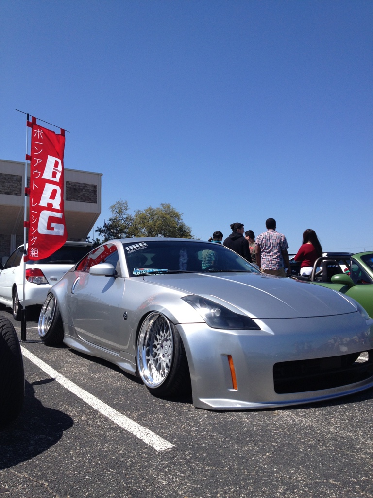

My main concern is the rim sticking out of the tire.. I do not want that. I want the tire well to be more dominant. Is that the +15 at the end of the set of numbers? So +20 will have more tire on the tirewell? Or opposite?
I DONT want this....

You ain't about that life, don't hate.

LOL, I wanna talk so much trash... But i'm new.. So.. let me have it.

^^ OMG ... Not a Hater... just trying to catch my breath

In person slammed cars are awesome...( I jizz when I see them).
But online they look stupid to me..
Then again in reality they are useless driving wise.. that's what really matters.
