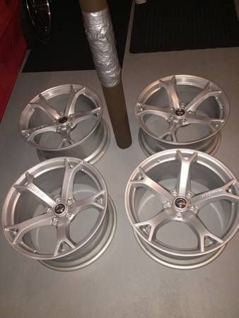

Hi guys so sucks that the gtr rims got sold, then by luck I came by used 370z Nismo rims powder coated new for 1k but with a 4 hr round trip so my next question is there anything I should watch out for to be genuine not some replica here a pic from the listing
19x9.5 and 19x10.5 ,
Never bought used rims before thanks for any input
I also would like to know why there are different rears 19x10 and 19x10.5 when I was searching the internet

The rears are 10.5", the 10" you've seen have probably been typos.
When you look at used wheels, just make sure they aren't bent or damaged, look for any previous repairs, weld repairs on a forged wheel can weaken it and render it much more susceptible to future damage.
I'm not aware of replicas of those wheels, so they're probably authentic, but they usually get powdercoated when they had to refinish them due to some sort of damage. Maybe just curb rash but look them over and see.

One thing to know is that you'll need Z34 lug nuts to go with those wheels. They use a different lug seat and shank to secure the wheels. They can't be adapted to use the Z33 acorn-style lug nut.

Another thing to consider is offset, do you want to run soacers or no? It is my understanding that these have high offser and will look sunken in on the z33

Z34N stock wheels are always 19x9.5/19x10.5. Period. No deviation from model year to model year.
However, there are NISMO "aftermarket" wheels for Z34 (non-Nismo) that can throw one off..... LMZ5 S-Tune wheels. These are spec'd 19x9, 19x10.
And, don't forget that Z33 Nismo wheels are spec'd 18x9, 19x10 and people selling these on EBay never make the distinction that these are for 350Z, NOT 370Z.
On fitting any of Z34N wheels to a Z33: front wheels are +40mm and will NEED 20mm spacer to work right (can be mounted without spacers and clear brakes and suspension but scrub radius and turn in will be totally funked up and steer like a boat); rears will be fine at 23mm.

Well, maybe.... 15mm+ spacers are bolt-on by necessity. Given that, there is a requirement for any wheels used to have recesses in the hub/spoke areas to accommodate the original studs/lugs sticking out of the spacer. Good news is that most good aftermarket wheels (and most OEM - standard or Rays) have the needed recesses.
Of course, YMMV, dependant upon your particular lug setup.
If it's still an issue in the rear, you should still have room to run spacers.... A 10mm slip on might be perfect with your ext studs. Most likely need to do some calculations between stock and lengthened configs to make sure.

Thanks for the information gonna go check them out this wed one thing worrying me is information on how powder coating will weakens the rims

Powder coating won't weaken wheels. Nothing in the process has the ability to affect them metallurgically.... It's merely the application of a charge to the piece to be coated and applying the coating with opposite charge.

If an inexperienced powder coater does them and lets them bake too long the heat can weaken the strength of the wheel.

Wellll, if a powder coating shop is going to cook your wheels for the 9-10 hours required to effect any real change to the tensile strength of the alloy in your wheels, yes, you took it to the wrong place. Oh, and you'll know about it for sure as the coating will have flaked off well long before the wheel deforms or loses any structural integrity.
But none of that is even likely to occur as the shop would need kiln like temps to do that. Keep in mind that aluminum alloys won't change their internal structures until close to melting point, in this case, somewhere North of 1,000 degF.
