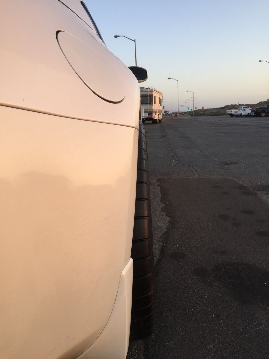

Do you have any pics? I'd like to see what that angle looks like.
Chris' car: https://my350z.com/forum/media-share...l#post10822080
