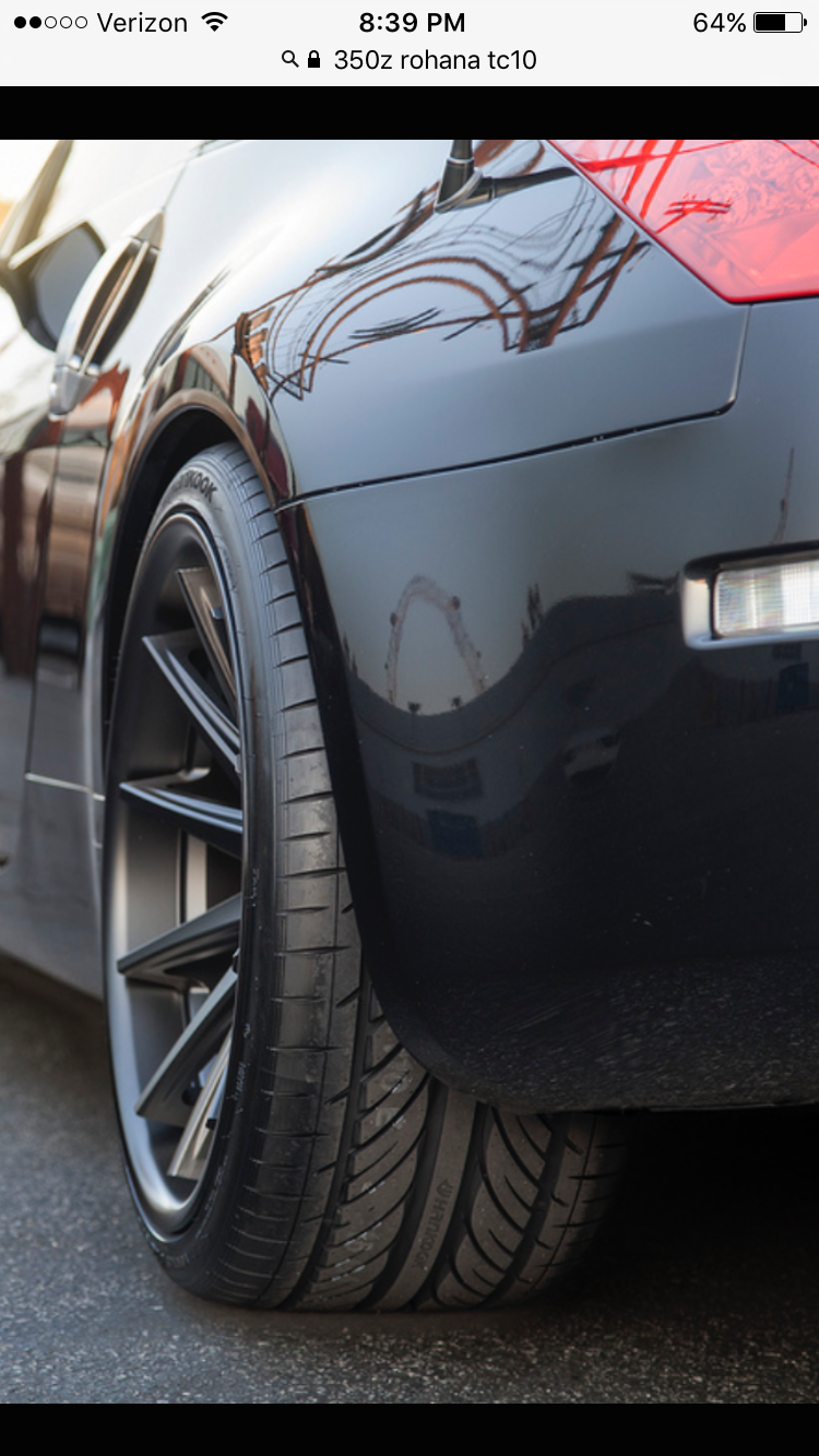

Thank you very much! Is it bad they are large spacers in the back? I attached a pic of something that I'm looking for. Is there a reason I would have to get different wheels?

No, you don't NEED to get new wheels, just a recommendation maybe down the road.
What I would do is mount your tires up, put the wheels on the car with no spacers. Measure how much space you have to bring them out. It will be somewhere in the 20-30mm range (30 if you plan to roll the fenders).
Then use the tire calculator found here: https://my350z.com/forum/tire_rim_calculator.php and play with the offsets to see how much spacer you need to add. It will probably be in that measured range from above.
But I caution you that adding too much spacer to the car with unrolled fenders will have you scrambling to find someone to roll 'em. Ask me how I know..... after 10 sets of wheels with nary a single clearance problem (even lowered) because I ran wheels in the +22 to +25 range, I found myself in that predicament when I finally went with the RPF1s in +15 offset.
Not a huge deal but beware.

Yeah definitely don't want to roll the fenders or anything haha. I guess I'm just looking for the safest amount I can do eithought sacrificing drivability or reliability.

Fender rolling is easy and will take you less than an afternoon. I recommend doing it personally.
Adding spacers is always going to add some level of "danger" to the car as it isn't a direct connection between hub and wheel. A quality space will eliminate some of the risk, but it is still there. Larger spacers = larger risk. You will more than likely be fine, but that is why we recommended getting wheels with widths and offsets that better suit the car
