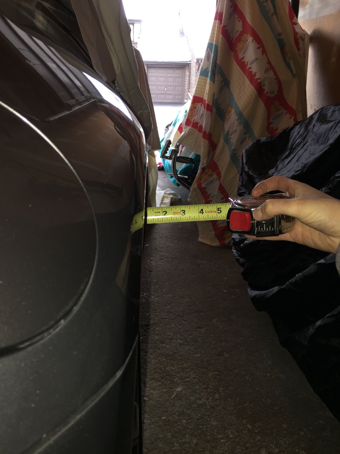

Is this the type of poke I'll be expecting?
Somewhere in that neighborhood I'd guess.
But here, do the math... https://my350z.com/forum/tire_rim_calculator.php
Never mind, for kicks just ran the #s...
Front will stick out 58.4mm from OEM, Rear, 80.75mm. Now go get a steel rule and visualize for yourself.

Do I measure from the most outer part of the rim. If so that's what I'll be looking at (3.18 inches, just before the quarter mark)
Yep. Wheels with those types of size/offsets are typically for widebody/feder flare applications.
