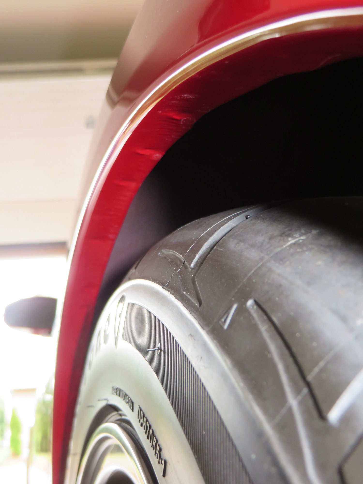

Originally Posted by Zkiwi
Thanks for the report. Would you do me a solid and photograph up and under of the rear arch so I can see where the rim and tyre sits please?
Old Jul 24, 2018 | 02:26 AM
Zkiwi's Avatar
Zkiwi
Joined: Oct 2017
Posts: 17
From: NZ
Sweet!
