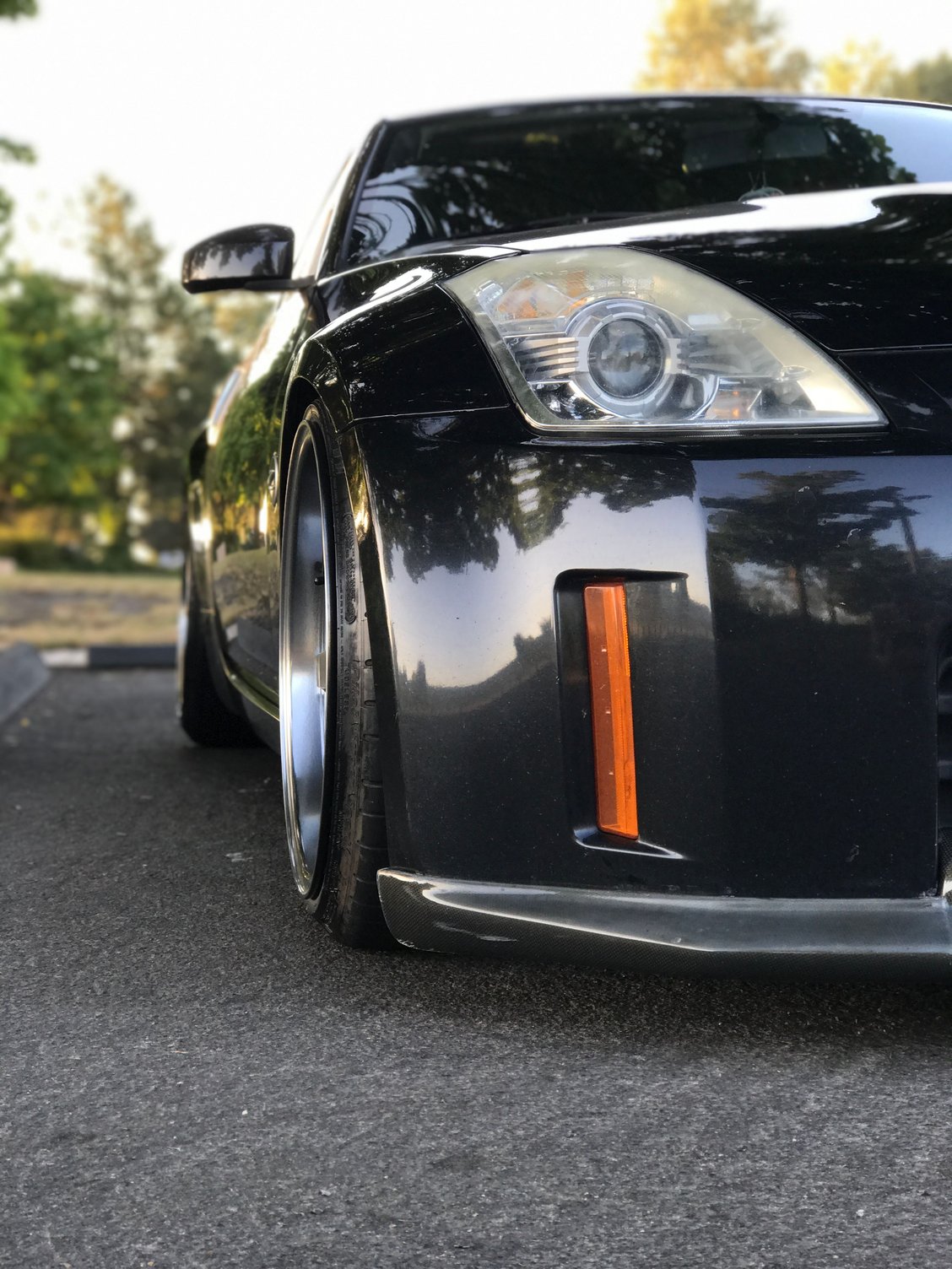

This "flush" conversation is pointless without talking about your ride height. The two pictures below are the exact same wheel & specs. Only change is the ride height. The natural camber from the car being lowered will effect the appearance of "flush"
Nice compare. Only thing that would fluster me is the change in steering response. Notice much diff on curvy roads/track between the two camber "settings"? What is the front at when dropped like that?
The lower picture is fully aired out so I definitely could not drive like that. At ride height the front camber is only 2 degrees. Aired out I have no idea. So whenever I drive, the steering response remains constant thankfully.
Ahhhhh, yeah, forgot that your car is on air.... thought they were before/after suspension mods pics. (And in a way it is. ) But again, great perspective on this.

top picture is 19x9.5/10.5 +12 and +15. Bottom picture is 10.5 all around +22
