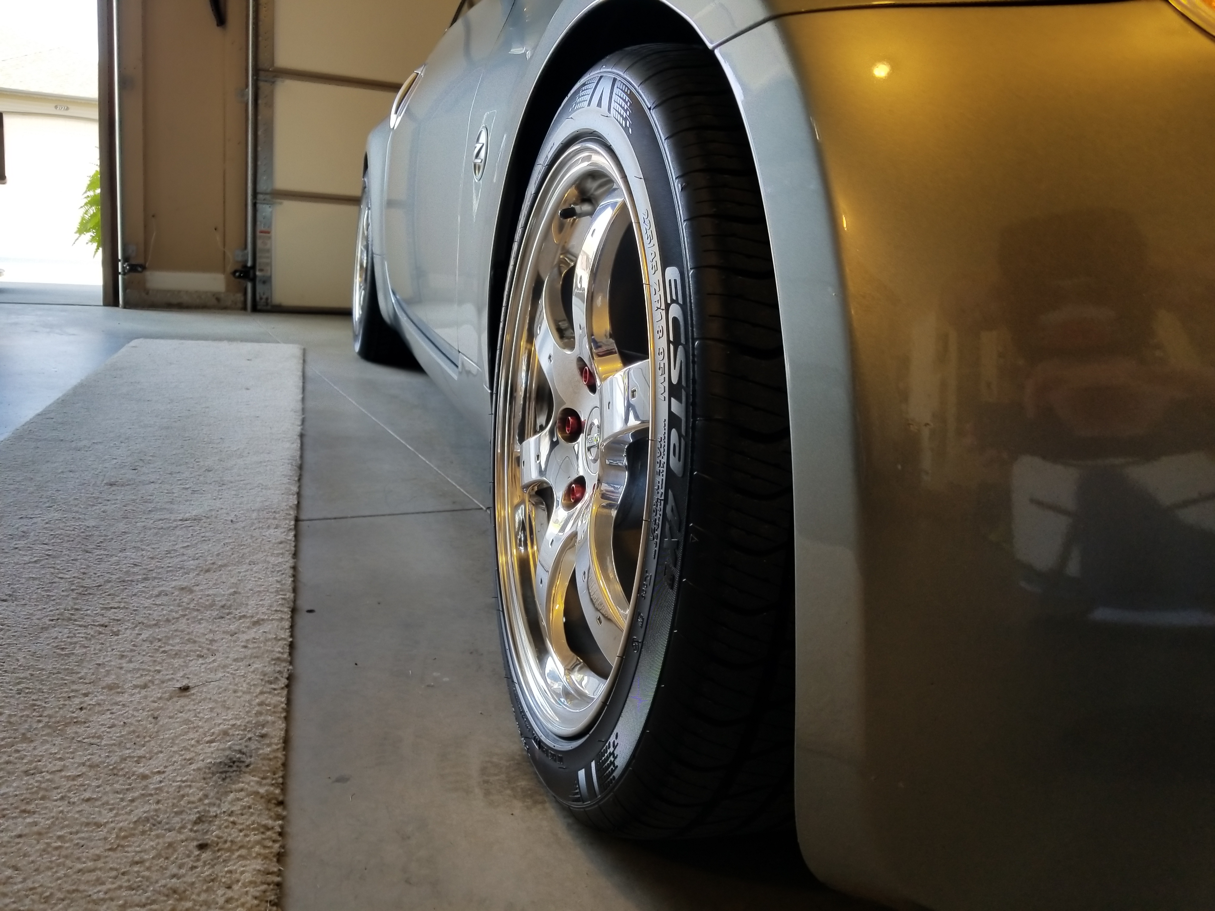

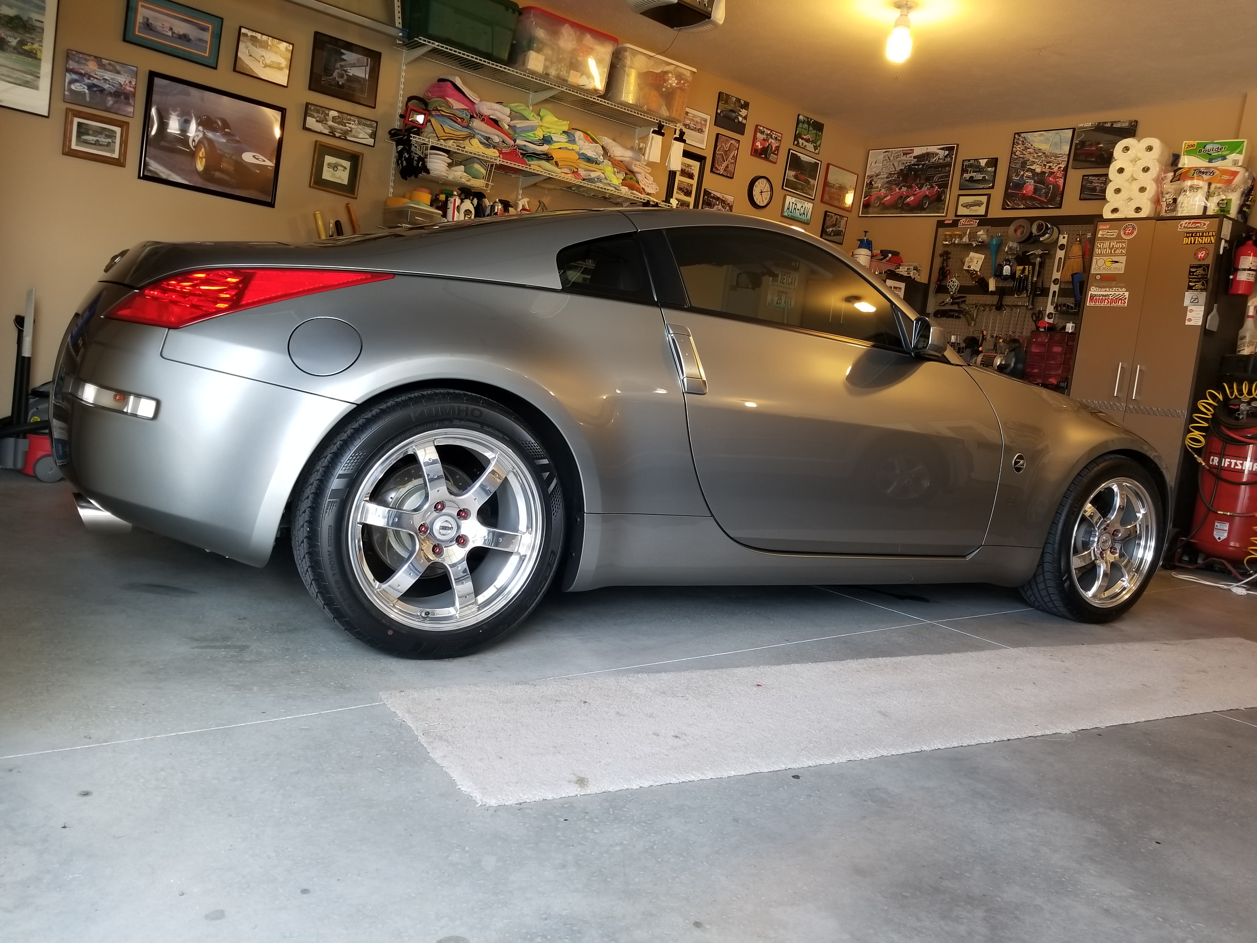

Zero offset... Your mounting surface would be centered in the wheel.
You can visualize what this would look like by looking at any of the pictures of people with stock wheels and 30mm spacers. About what you need for flush fitment.
