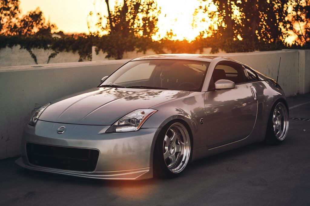

op wants to be like this
which reminds me of this

these are the wheels only hes running 11 in the rear and 10.5 up front +15 all around

This guy is on varrestoen es6 11x19 all around +15 with a 245 tire these are the wheels i really wanted but there sold out contacted varrestoen they told me i had to wait 5 months before they get a new shipment

Sounds like your mind is made up -
Is there anything that anyone on this forum can say that is going to persuade you away from putting a 245 tire on a 11" wheel? If not, just do it ...
If you like the performance aspect of your car now it'd be foolish to think those attributes will remain if you change your tire/wheel setup.

No one is worked up about it, just that 245 is a totally unsuitable tire size for 11" wide wheels. There's a "rule" that one should follow and that is to apply a tire size that is at least as wide (tread width) as the wheel and not to exceed 120% else performance drops off. Likewise, not a good idea to go below 100% of the wheel width but can do so down to about 90% without too much performance offset.
Yes, one can mount a tire that is outside of this range. But it doesn't make it right.
S'far as running 11" all around, well, it's been said already, you run the risk of creating more understeer (if you size the front tire correctly) in an already understeering pig. Not a major issue that can't be overcome with proper suspension tuning.
Will they fit? Depends on tire size and offset. I'm going to GUESS that +15mm 11's are going to scrub the fenders at lock but do not know for sure. That's with the proper tires (for the wheels), say, a 285. 245s stretched will probably fit up front without interference but that's the point, no performance gain stretching the tire to make it fit. FWIW, I see a lot running 10.5 square with 275s, if that helps.

Its a mild aggressive setup. I have 19x10F/11R +10 on 275/35, has a bit of poke but nothing over the top. I'm not slammed or have excessive camber. Fronts will poke out too much on x11 +15 IMO.
