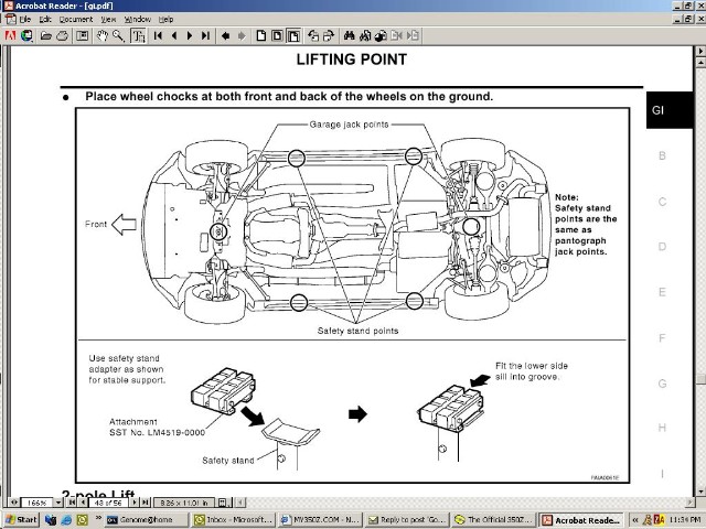

For you guys who have done this before, where did you guys put your floor jacks for all 4 corners to lift the car. I just received my G2 paint for my calipers and i was wondering where was the best place to put floor jacks and where they would be safe. ???

You'll find a drawing with the appropriate points to rest on jack stands in your owner's manual.

ok, now that fdao has taught me how to post pics, here you go.

Now, I see that Nissan recommends putting in the spacers on there.....where would be buy them? my jack stands just have metal on the top....I wouldn't want to crush anything with the wrong part resting on the car!!!
Also, does anyone know where the jack points are for the car??? Using a floor jack and not the Nissan jack.... The frame in the front looks pretty beefy so that would be a good place, but in the back, there doesn't seem like there is much.
