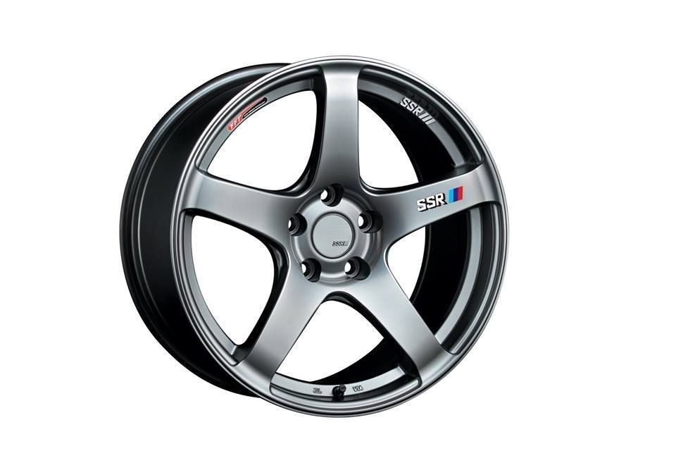

Don't even worry about it, even if you do track the car. Enkei builds solid wheels and even though they're not as light as, say, their own RPF1, pretty sure that anything coming out of the Enkei Racing Line of wheels is going to be a solid performer that isn't going to break on the first off road expedition. I only made that weight comment because I'm spoiled. Laff. The heaviest wheels I own are 20.5 lbs/corner (both Nissan/Rays products). And IMO, a nice set of five-spoke wheels look amazing on a Z and these new PF05s are great looking. I mean, how does one improve on a basic five spoke? Well, Enkei did so with this new one.
Although now that I'm looking at it, it looks just like an SSR GTV01, another favorite.....
Oh well.....
