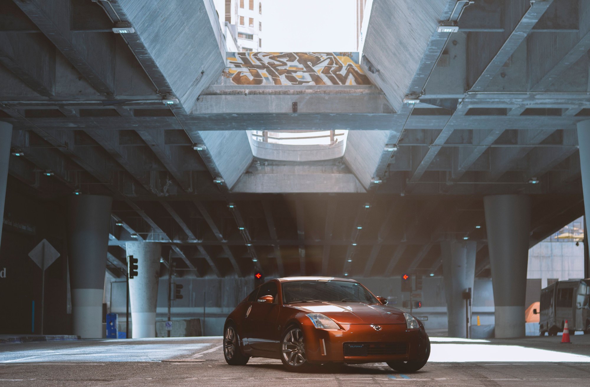

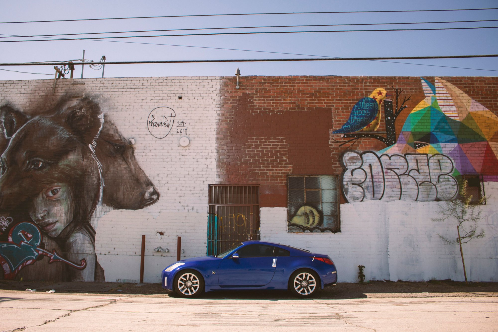

$350 for the wheels. $80 to swap TPMS and 2 tires from old set. Ended up selling the old rims/tires for $250. Not my favorite look but can't beat the price.
Last day in LA photo shoot
More lower? .5" drop in rear already.
What if La Mans Sunset?
