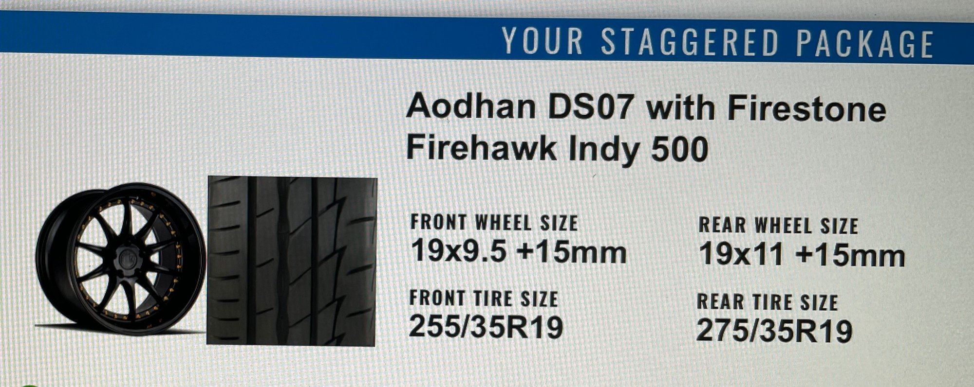

Default Will this fit on my Z with no modifications, roll or rub on stock suspension.
I am looking into this, will this fit on my 2003 Z.
I'm fairly certain you'll need to roll the rear fenders. Only reason I ever rolled mine were when I went with a set of RPF1s at a modest spec 18x9.5 +15, they rubbed on bumps and driveways. That was AFTER the car was lowered so they might fit at stock height. I had a set of 18x11s on my car before it was dropped BUT with a +25 offset. They fit fine.
