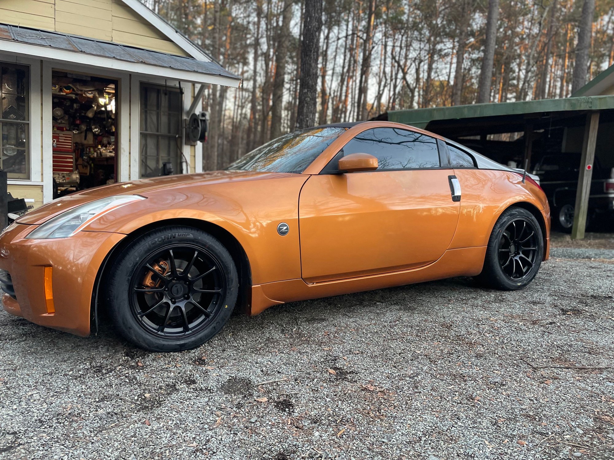

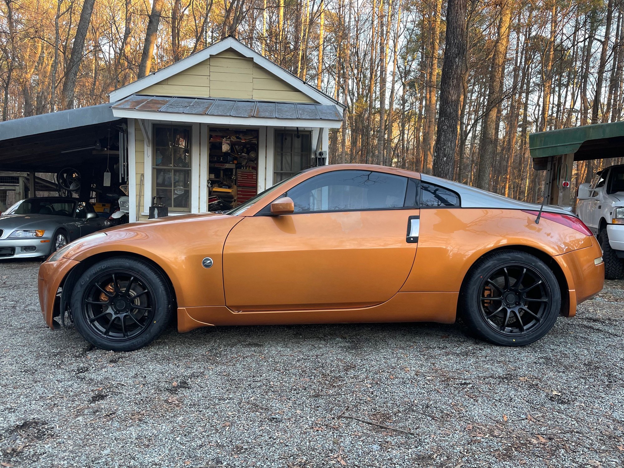

If anybody cares how these turned out here's an update: No spacers installed yet, but I'm actually very happy with the fitment overall. Still planning on spacing the front when my Kics hub centric adapters come in.
looks amazing ! love it
