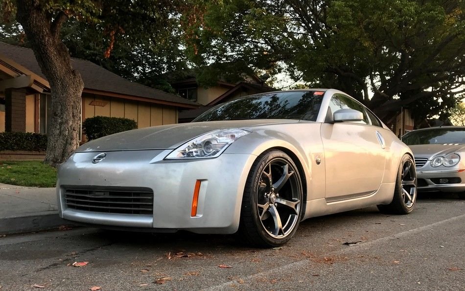

Picture just to set the stage. Factory ride height, factory Track wheels, 18x8 +30F 18x8.5 +33R with stock size tires- Not an aggressive fitment of course but an amazing stock set up. These wheels are forged, light and stiff. Only "downside" (but hardly) is the widths, which keep you - practically - at stock tire widths. (Although others here have run upsized tires - 275/40s even I think - with no ill effects.)

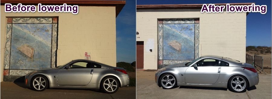

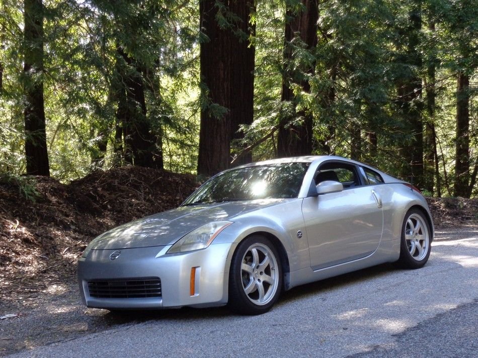

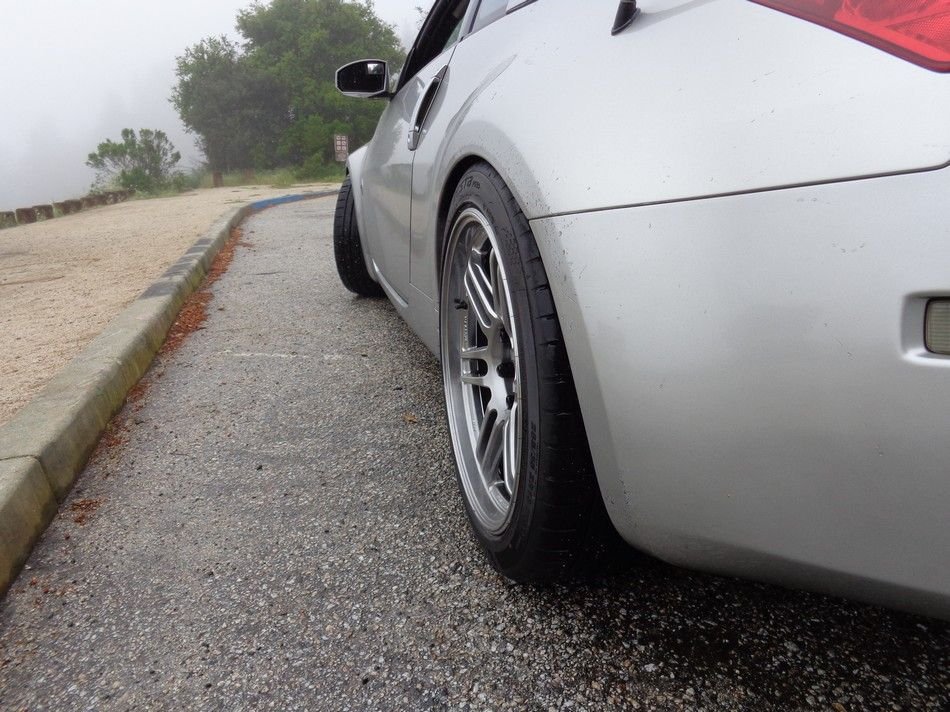

Pics below are all of a couple of my cars. Note that most (unless noted) are on 19" wheels. Dimensions (width and diameters) are essentially the same as stock. a 235/50-17 nearly equals 245/45-18 nearly equals 245/35-19 so overall grip is similar and all comments are relative and inconsequentially different. My preference is sharp reflexes with quick turn-in response, hence 19s with their lower sidewalls to minimize flex.
Stock ride height. Volk GT-C (forged centers) 19x9.5 / 19x10.5 with closer to stock offsets around +27 and 245/35, 275/35-19 (These were my first aftermarkets on this car so, conservative)
Remaining pics are post lowering - very conservative drop of -19mm (only -15 when on Bilsteins but -19 with my Koni Sports)
Enkei RPF1 - 18x9.5 +15 square with 245 & 275/40-18 (roll forged) - this was the lowest offset I put on the car originally but despite narrower width, the lower offset necessitated rolling and sealing of the guards (fender lip). Pretty whack but that 5-7mm was enough to give me interference. You mentioned your guards were already rolled so you can pretty much not worry about this.
Nismo LMZ5 S-Tune wheels (forged) - for Z34 so the offsets had to be manipulated with spacers on the rear. 19x9 +23F and 19x10 +40 rear but spaced down to +20 Tires: 245 & 275/35
Just a note here, these were my favorite Z wheels of alll time. They are forged and despite 19" sizing, only 20F-20.5R lbs each! Coupled with the lightest, Max Perf grade tires I could find, this was the most amazing set up I had (of the over 20+ sets) on any of my Z33s. Super responsive! If I remember correctly, these were sub-45# total per corner.
Also ran a couple of sets of Nismo V1s from Z34. 19x9.5" +23F, 19x10.5 +40R (spaced down to +20R) with 255/35 & 285/35 tires. Nice wheels but not nearly as light (~20# and 23# F&R respective) as the S-Tunes. Included here for size consideration.
Next 2 pics: These were probably the most aggressive natural (no-spacers) fitment I had. AME TM02 (an Enkei company) 19x9.5 and 19x10.5 - all +22 with 255/35 and 285/35-19. These would NOT clear without rolled guards. But since they were rolled before this, hey.
These were my "forever favorite" wheels after the LMZ5s - Volk Two Pc. (forgot actual name) 19x9.5 +25 & 19x10.5 +28 but spaced down to +8 in this pic. 245/275 tires.
So, the point of all this pic whoring (there's more but I'll spare everyone) was to just give you some visual idea of what to expect (and make me miss my 33s

Possibly the first thing you need to decide is "to lower or not to lower". The Z33 doesn't really *need* lowering but, IMO, is at least aesthetically pleasing. But there are trade-offs of course. If you decide not to lower it, going lower offset (+15) is easy but I still think +20 to +25 is fine.
You be the judge (or...."How much difference do you discer?" Ha!)
Post pics of your car when done!
