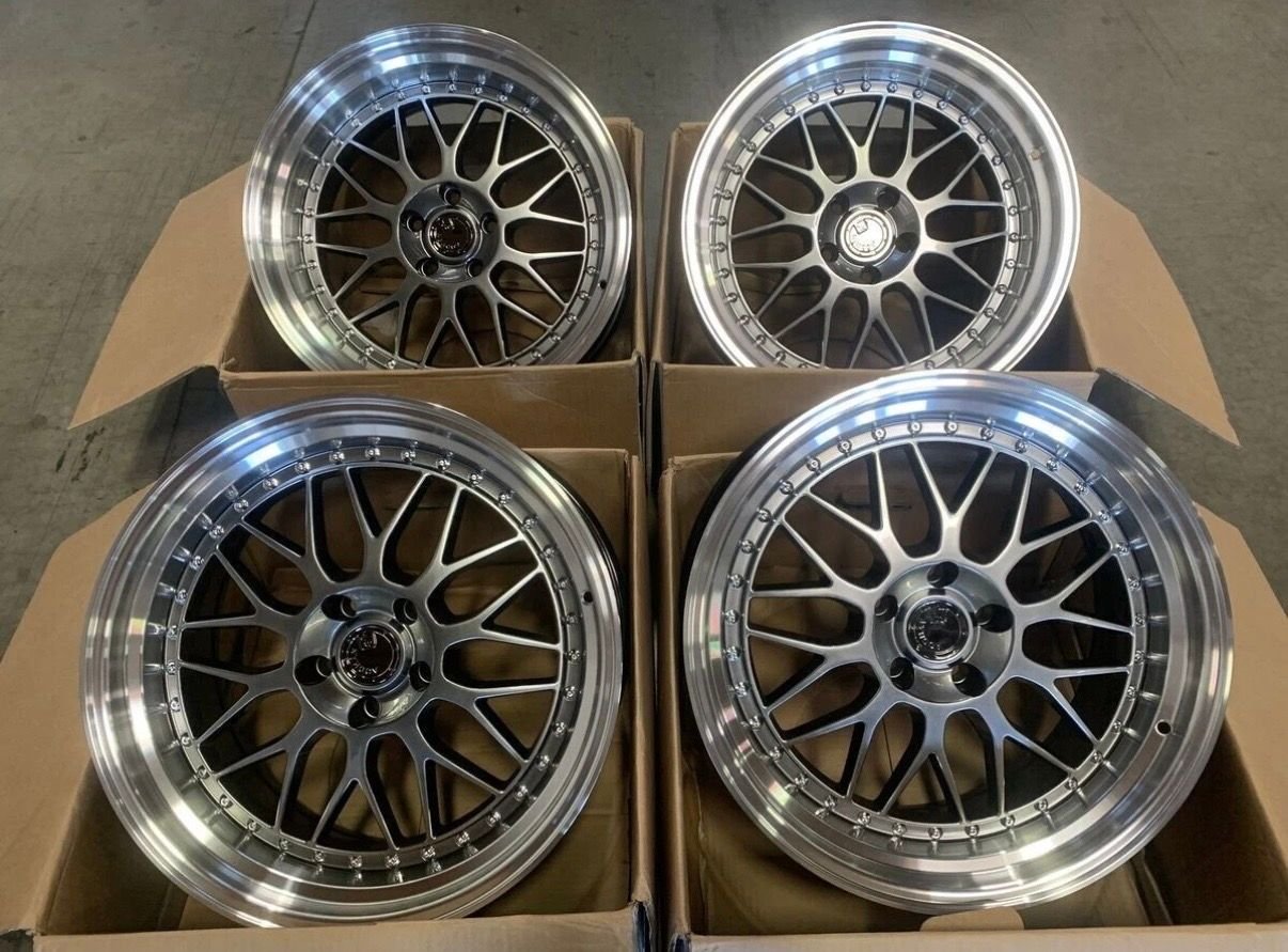

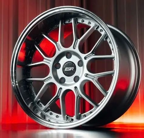

It's a pretty timeless wheel design for sure. You might be able to find a similar wheel design by a different manufacturer with the proper sizing if you're committed to that particular look.
There are more BBS LM replicas out there than any other wheel. Just about every low-mid wheel mfgr has one. ESR, MST, come to mind as well as countless other no-names.
Aodhan
ESR
Small differences just so they wouldn't sued; but you get the idea.
Caveat emptor: some of them are not worth buying. A friend bought a set that, at the time, sold for like $550 for a set. They were about worth what he paid for them. 🤮😆

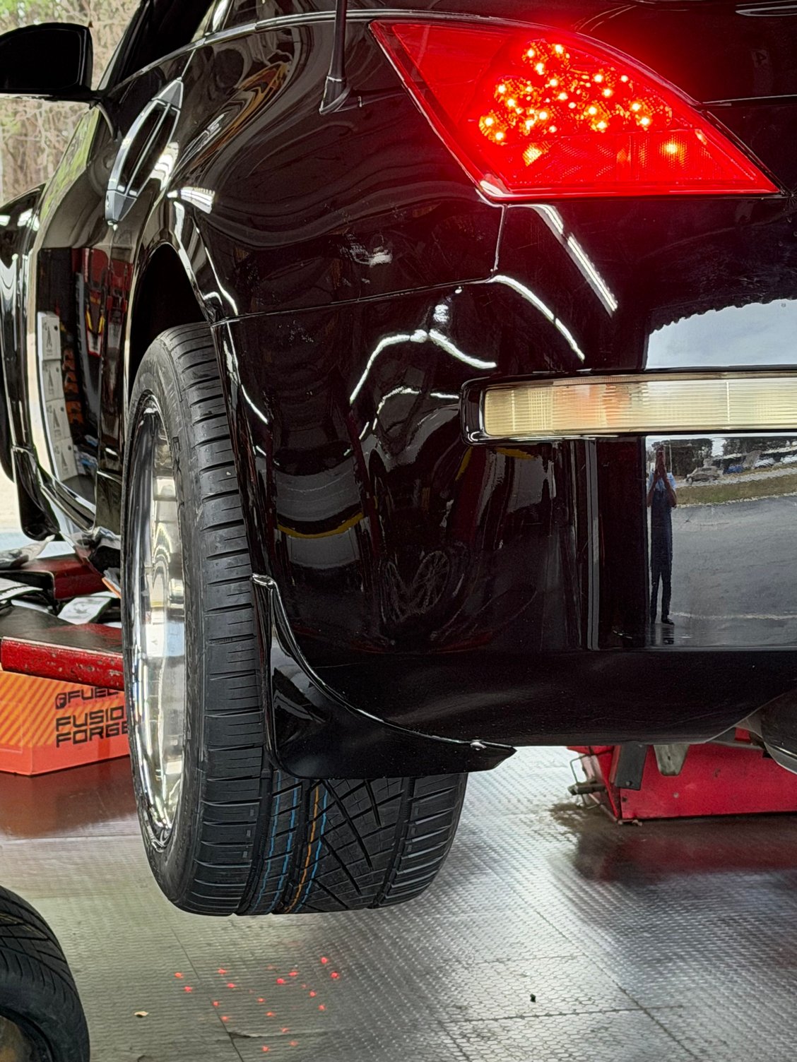

After looking around at quite a few wheels in this style, Volk, ESR, Aodhan, Work, Vors, JNC, just to name a few, I think I have come to the conclusion that I am probably just going to get the XXR's and run spacers. It is actually quite funny to me that the cheapest, probably worst quality, ones look the best to me. Although I am not going to be thrashing the car around so it'll be fine.
Also to the fact of my conservative driving, I think having spacers on for the life of the car will be fine. The most I will do is cough* the speed limit cough* so I think I am just going to settle on this sub-optimal, but working, workaround.

Alright, I think I have finally finalized what I want.
The smallest bolt-on I could find was a 15mm, granted maybe I didn't look hard enough, but based on proportions that sounds about right for the minimum. Which I might be able to pull off on the back, since it would bring me to the equivalent of a 18x10.5+16.35.
The setup I have chosen is:
F: 18x10+25 245/40/18
R: 18x10+25 265/40/18
*spacers not included in the specs
Correct me if I am wrong, but I shouldn't have any VDC issues with a difference of -1% in the front and -1.3% in the rear, with an overall +2.4% difference between the front and rear, which is a -0.3% difference from the stock f/r ratio. The diameter difference between the front and rear is 0.6" which is closer to the 0.5" recommendation I have seen than the stock 0.7" difference. There aren't any issues I am glossing over right?
