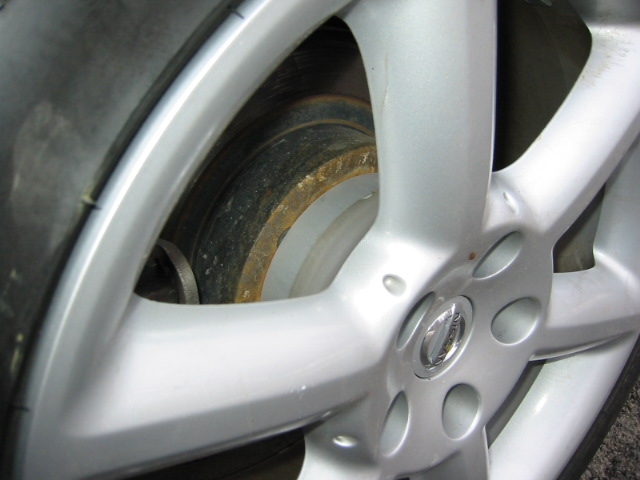

This might help. I added H&R 25mm spacers to the rear last night. It was indeed hub centric. In fact it was quite tight, requiring the bolts to pull the spacer down.

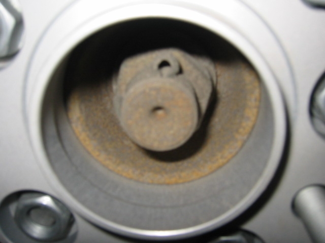

Here's an inside shot to show just how snug it was. The spacer also felt to be wheel centric, although not quite as snug.

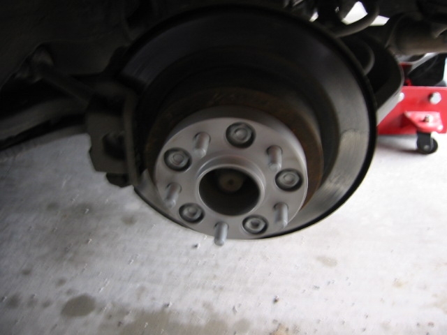

A pic of it within the wheel.
