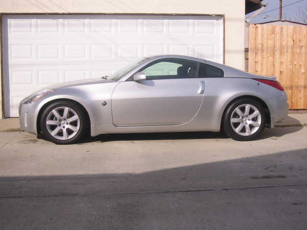

I have just a base, stock 2003 with the 17" wheels, nothing fancy, daily driver. Picture attached.
Lowering isn't exactly a priority for me, though I suppose a bit lower never hurts the looks. My prime concern is killing the dreaded bounce.
You've listed three options above, and correct me if I'm wrong, but Koni shocks are hard to come by (???), but if you can find them they are roughly $600 for four? Coilovers probably aren't what I'm looking for. Lowering spirngs are probably the least expensive route to take and would also lower the car a bit as a small bonus (though as I said, that's not my prime concern).
Is this correct? If so, what exact product do you suggest, price, where to purchase, etc. ?
It would be nice if the dealer would address this problem (and I do see it as a problem), however it's my understanding that this isn't exactly covered. I bought this car used recently, and it's really the only thing I'd like changed (aside from the dash cupholder which seems to be stuck, but I don't drink in the car anyhow ).
Any guidance would be appreciated...
