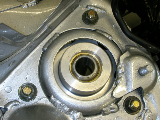

We have upper front and rear shock mounts that we use for our 350Z's in the GAC
Drop me an email and I can send you some pics.

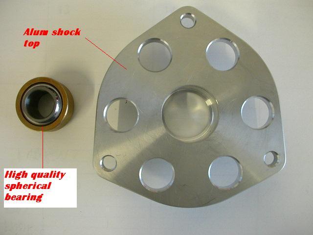

Here....

We have the shock tops in stock and the bearings are on the way. We would just need to know the diameter for the shock shaft to get the bushings that slip into the bearing.
We will have these available that fit the new Konis.

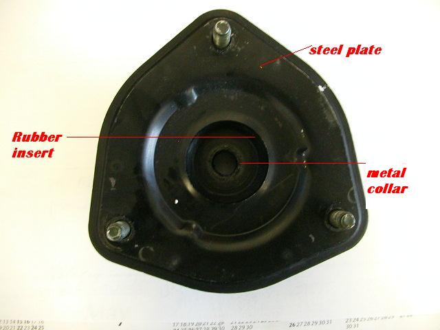

Here is the OEM front upper chock mount.
2.2 lbs.
Its the same theory as switching any other OEM rubber suspension bushings and going to a solid Delrin with Alum insert.
Helps suspension response and eliminates the "slop".

350EVO front shock top.
0.5 lbs
The bearing allows for smoother movement when needed VS rubber insert......
Its purely performance.
