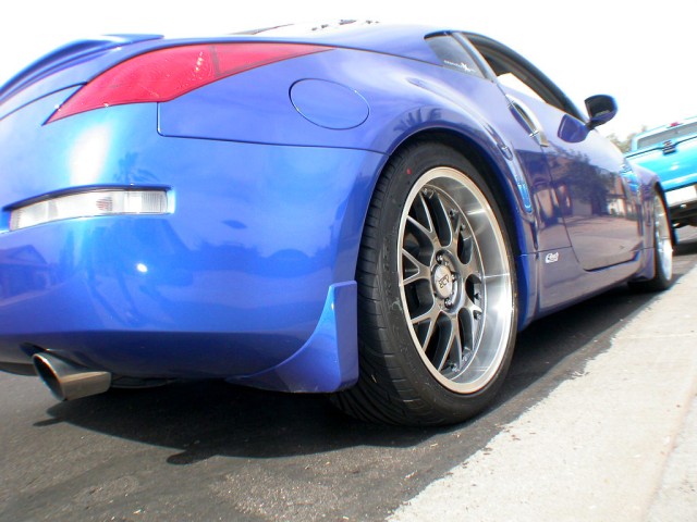

first of all, im so sorry that im using this picture for example..
but, this guy has 19 x 9.5 wide on rear.
and its not fitted. its still small, u know?
Do I have to get, at least 19 x 10.5 on rear to make it fit right?
Thanks for respond!

Originally posted by Daewoo
yup!
ummm... no
it's the offset on that wheel that makes it sunk in... read what I said above

lemonjihwan: no problem... everyone is a wheel/tire newbie at the beginning ... when you're shopping for rims for the Z... there are at least 3 stats you should be most concerned with, from a sizing perspective (another important stat is rim weight, but I won't get into that here)
1) Rim size - do you want an 18, 19 or 20?
2) Rim width - do you want an 18x8.5, 19x8.5, 20x8.5 in the front? 18x9.5, 19x9.5, 20x9.5 in the back? (and so on...) Typically for the Z, you'd want staggered widths for the front and back... meaning if you run an 8 in the front, then run a 9 in the back. Rule of thumb is +1 to +1.5 inch width from the front to back (up to 10.5 inches, after that your wheels will rub your fenders). This of course is preference... there are plenty of people running the same widths front and back with no problems with appearance or driveability
3) Rim offset - determines how much caliper clearence you have, and how sunk-in your wheel will look. Click here to learn more: http://www.tirerack.com/wheels/tech/offset.htm
Because the Z is a RWD car, most of the wheels being sold out there are not in proper sizes for the Z... you'll notice that most wheels have offsets in the +30 to +40 range to accomodate hondas, mazdas, VWs and so on... which fit great on FWD cars but will look WAY sunk in on a Z... so make sure you are shopping for rims with lower offsets in the range of +10 to +25
My original suggestion still works, but because it sounds like you're looking for something agressive, I'll change my numbers a bit... if you're looking for 19x8.5 and 19x9.5... look for offsets in this range, and you'll be happy
19x8.5 -> about +15 to +25
19x9.5 -> about +18 to +27
