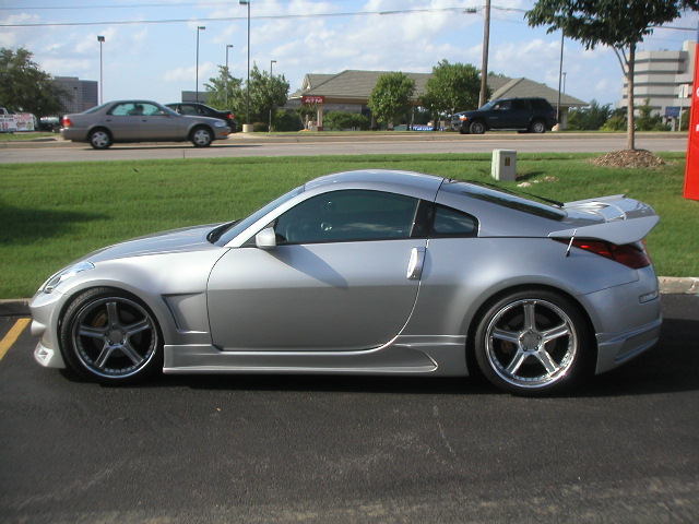

if you only lower your car 1/2 an inch youdont need a camber kit. here is a pic. of my car w/ 20x9's in the front and 20x10.5 in the rears. i lowered the car 1.5 inches and there is no rubbing .

Whoa...now that is nice. So did you have to roll the fenders? What springs are you using?
no fender rolling. and i have h&r springs
