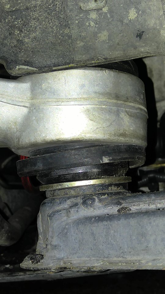

In the past 2 weeks this clunk has been getting worst. Getting it while tapping on the brakes coming to a stop. Clunk comes on at low speeds on bumps/dips in a straight line and while cornering left and right. Clunk is from driver side front wheel area.
I got alignment today to see if it could fix the issue but still loud and clear. I've looked under the car for bushing failure but none.
I have (all under 1 year, however noise has been progressing in the past month with the past week being the worst):
Hotchkis sways
whiteline end links
whiteline shock bushing
whiteline LCA bushing
Whiteline Compression rod bushings
New ball joints from concept Z
However i'm thinking the issue is from my compression rod bushing (replaced with whiteline a few months ago)
I've attached this picture for you guys, is it normal for the bushing to ride up like this at one end? This is taken from wheel well driver side front wheel. looking in at the compression rod bushing

wow i was looking at my post i posted and saw that the compression rod is actually touching the frame piece. could that be the issue?

It's normal to ride that that, poly in this location is a bad idea. If it's touching it could cause a clunk.
How low is your car sitting ?

Yeah get rid of the compression rod bushing and put in a SPL solid one

eh. i got it fixed finally. wasn't any bushing at all. was because there was a slight bit of play in the radius arm not seating all the way into the steering knuckle (opposite end of the bushing end).
