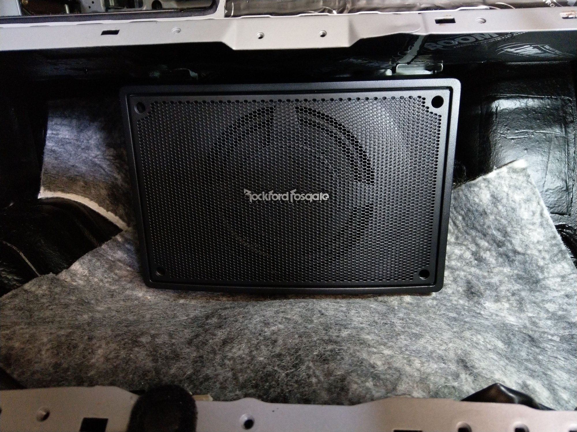

This is mine attached to some pre-existing tabs.
