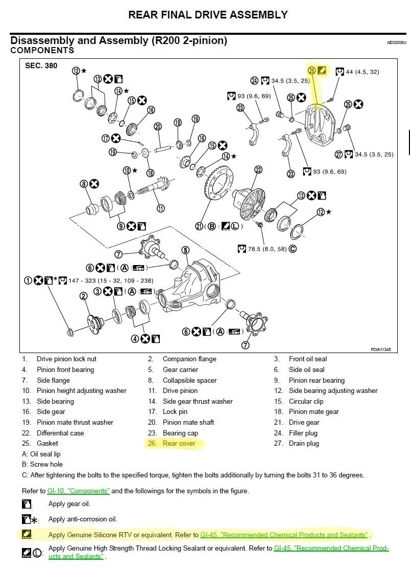

2005 350Z with OEM 8 hole cover.
I believe the Fel-Pro Part # is RDS 27275 but not 100% certain. Might just do a drain and fill but if we decide to pull the cover, want to be prepared.
Thanks!

Sealed with RTV from factory.

What Dark said, I didn't think these differentials used gaskets, just straight RTV.
FSM Screencap.
Cheers!
-Icer

Old May 16, 2024 | 11:26 AM
JSMCO's Avatar
JSMCO
Joined: Apr 2024
Posts: 87
From: CO
Thanks for the input guys.
We ended up just doing a drain & refill. The old fluid that came out looked pretty clean so opted not to pull the cover this time.
