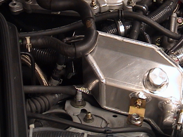

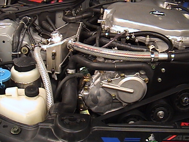

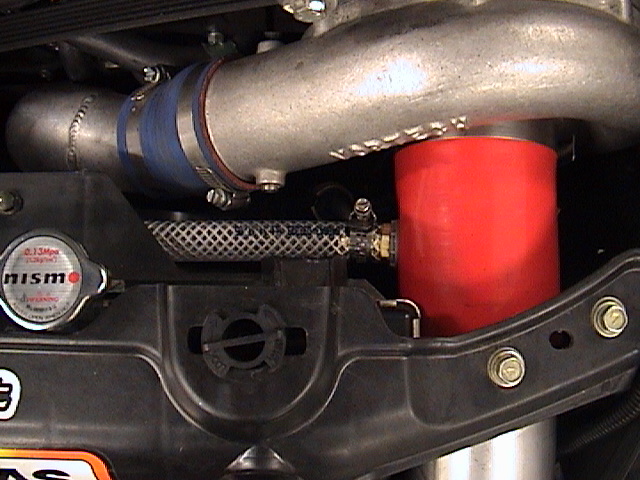

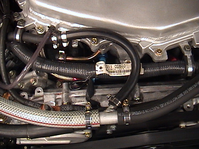

Here a few Pict's. of the ARC modified AAM oil catch can. The overall fit of the can is very nice, I don't have a strut brace so I don't know how it fits under it. I had to pull a few mods. because of the Vortech, like routing the right side valve cover vent line differently. I also added a 5/8" barbed port on the silicone charger intake, so the catch can will be under constant vacuum.
Looks great I think.
Kevin
