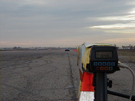

Arrived 9:00 am and started the testing process which consisted of 60-0 stops, 80-0 stops and 100-0 stops. Car was monitored by a radar gun for speed and stopping distance. Gun was hooked into a laptop. The also did J turn tests.
Braking runs started on factory original brakes. We did four tests of each. Then we did the J turn braking. That consisted of going into a 1/2 circle turn at a predetermined speed (approx 47) and slamming the brakes. Measurments were taken after each stop. This information is proprietary to Stoptech so I cannot say more on the J turns. The J turn data will not be available for another 10 days or so as they are crunching my numbers and will also crunch the other Z car numbers.
Needless to say, all the above test were performed first on my original brakes and then on the stoptech brakes. These tests were run with the 13.1" Stoptech Brakes. The 60-0 stopping distance decreased dramatically (much better) with the new brakes and the 80-0 and 100-0 tests were also better but not as great an increase in stopping distance. I was told the main reason for bigger brakes is the ability of the Stoptech system to stay cooler over repeated use and stop more consistently (which they did).
The testing also consisted of disabling the anti-lock brakes and testing which tires locked up first. Front or rear. On both factory and stoptech brakes the front tires locked prior to the rear. (the way it should be!)

This is how the day went.
