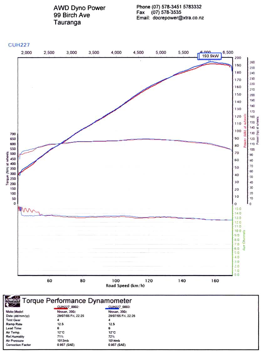

Just got my car dynoed..
Z33 Fairlady Z (JDM car but I don't think Z33 got any difference between JDM and other regions)
Fujitsubo cat back exhaust
AAM plenum spacer
Simota drop in filter
Coolant bypass
I am happy with its curve, very linear

I thought I had pretty good eyes, but I cannot read that even when its blown up. Mind giving us the numbers?

looks like 260hp @ 6500 maybe.......cant tell.

hard to see...

What dyno was used?

194kw (260hp) at 6150 rpm.
I do not know what brand that dyno really is.. it is a popular one in new zealand though.
it might be a bit off from dyno machines in usa but i do not think it will have too much of difference as it is sae corrected value. it was around 270hp before correction.
And running on 98 octane pump gas.

why did you do it in 4th gear?

we do it in 4th gear because its got 180km/h speed limit.

Unless you tune your car to run better off higher octane gas then 91, it will not see a difference. I think those numbers are fairly high.. But just my guess.

Dang~~ 4 mods and 20-30 horsepower gain... Hmmm..... impressive or something fishy?? If it's true, very nice!!!

so?
4th gear isn't 1:1
When I dyno'd mine, we went right up to 231km/h before we shut down

where did you see that?
Unless you can compare a baseline done in 4th gear you can't say its a 20-30 rwhp gain
I remember reading a post where someone dyno'd in 4th and got much higher numbers than everyone else was getting
It also depends on what kind of dyno was being used
Not trying to slam you bleunetizen...260 rwhp is possible with those mods, but if you dyno in 5th I'm guessing you'll see 250 max. Again, dyno dependent.

I do not really think i gained that much power from mods. and we CANT use 5th gear. All JDM cars got speed limiter that cuts fuel if u go over 180km/h. But however, those numbers aint bs numbers because there were many other modded cars on that day- s2000 with 215hp at wheels, dc2r with 185hp at wheels and etc.
I am very satisfied with my result because it is very well balanced. very even torque all over the rev range peak power doesnt mean anything to me, its the drivability that is important to me. Its got nearly perfect a/f ratio too, nissan japan must have done a really nice job mapping the stock ecu.
