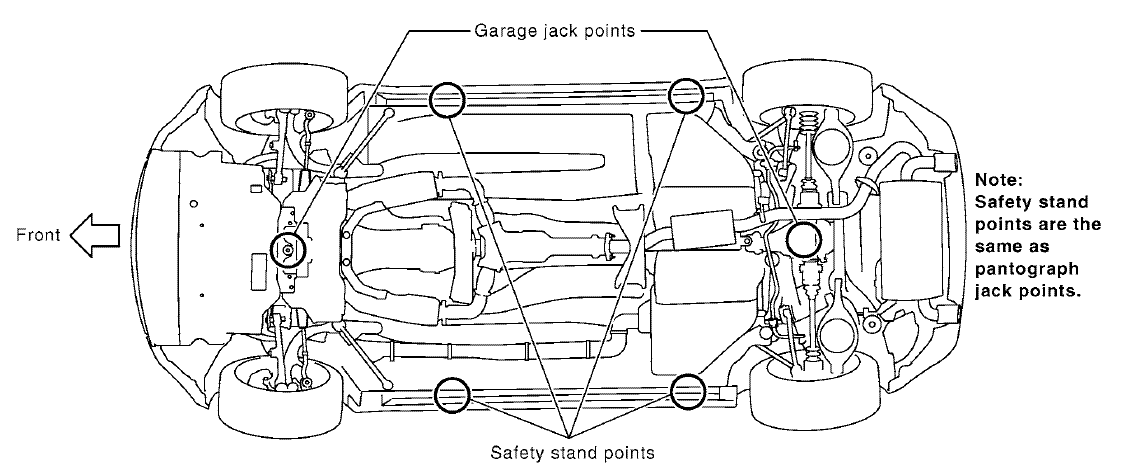

Originally Posted by Z1 Performance
jack locations -
front - right behind the front wheel, under the lower control arm. There is a pancake shaped disk - perfect to jack from.
rear - I use the rear diff...be careful to put it on the pumpkin side, not on the rear cover - especially true for those of us with the NISMO diff cover
Jack Stands - front - I gor right under the lower control arm, works perfectly, no nicks or damage at all

Originally Posted by vo7848
I would imagine this hump would be directly behind the plastic skid panel?
Yeah it is hard to see and I am at stock ride height and I still drive up on some spare boards to get my jack underneath it but it beats having to jack up both sides. I will look for the image from the service manual I made or I can post it for you when I get home.

Sorry forgot to post it last night.
Attached Thumbnails Where's A Good Place To Place A Jack Under The Z?-jackpoints.gif
SWEET! I printed this diagram out. Thanx.
