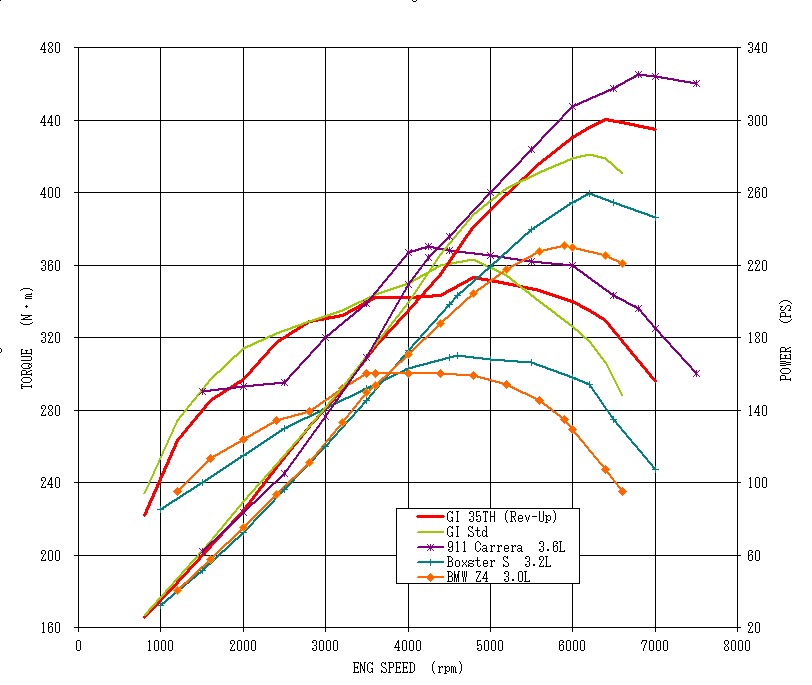

Have a look at these comparative dynos.
The 287hp engine has more torque from tick over to 5300RPM above that the 300hp engine has more torque.
If you normally drive your car above 5300 to the redline then the new engine makes sense. If you prefer to not thrash it then the 287hp engine makes sense.
Interesting that both engines makes more torque up to 3500 RPM than a 911. As for boxster S and Z4 best to laugh at them
Paul
