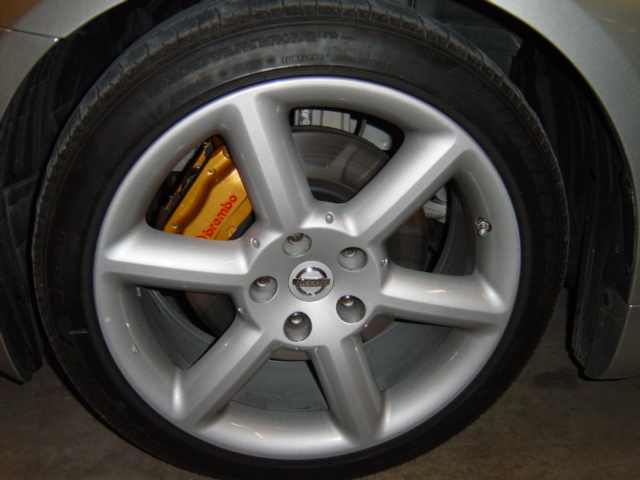

Always wanted a Track when I pre-ordered, but ordered a Touiring wanted the leather/Bose. Oh well things haved changed, and I am one Happy guy now!!!

bought the Rims , bought the Brembos from a G35 guy, and Walla!!!!!

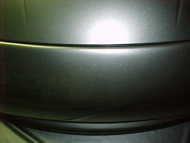

No Nissan Badge

Default Isn't that a Nismo bumper?
Very nice!!!
Old May 14, 2003 | 03:51 PM
88 Shrio Special's Avatar
88 Shrio Special
Posts: 244
From: Atlanta
Yep. Had the Nissan badge removed here in the staes. Total body time includes badge swell filled, several sandings of front end , primed, and painted 4 hrs. It is PERFECT!!!!! Dannny Muir is the MAN!!

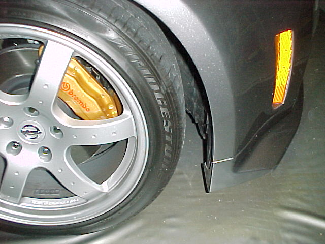

It does look great! I did this mod about 7 months ago. Here is an old pic.
Looks good 88 Shrio Special!!
dan
