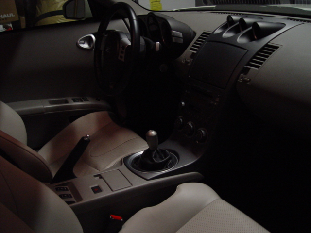

but i do love my titanium nismo ****.

Hey John- I meant to ask you- how the hell do you keep from burning your hand on those really hot days? I know the top of my stock shift **** gets extremely hot - enough to burn if you touch it for even a few seconds.
