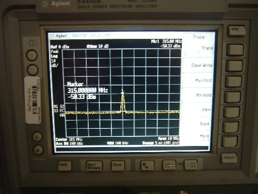

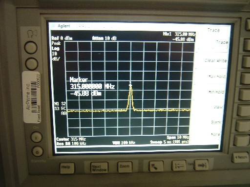

Well, I decided to test this, I pointed my remote at an antenna hooked up to a spectrum analyzer chin vs no chin and found a 4dB increase in power using the chin thing method.
This however has nothing to do with your hair, it is a 315MHz signal so most likely you are giving the antenna a pseudo ground plane and refective surface.
No chin...

hmm, once I get the photo small enough for the page to accept it, the quality sucks....let me try again...
Old Jul 28, 2003 | 02:44 PM
Mikestro's Avatar
Mikestro
Posts: 2,560
From: San Diego, CA
no chin
Old Jul 28, 2003 | 02:45 PM
Mikestro's Avatar
Mikestro
Posts: 2,560
From: San Diego, CA
on chin....

Your head has a different dielectric constant than your hand. More liquid and more bone. Any beefy portion of your body would probably load the antenna enough to improve the performance, it just so happens people used their chin, probably cuz it is up high to give better "line of sight" to the receiver in the car.
It is kind of like when you grab your antenna on your radio and your reception improves, you are capacitively loading the antenna. The antenna in the the fob is <2 inches and is a loop. However as you might guess, this is not an adequate length to make a 300MHz antenna. Which is why the transmitter is putting out +10dBm but when I measure the output on my spectrum analyzer, it is -45dBm. Even a crappy antenna should be -15dBm assuming 0dBi gain and range loss of 25dB.
I could go into a lot of detail but suffice to say it is a really bad antenna. I have a prototype that is doing much better than the stock antenna.
