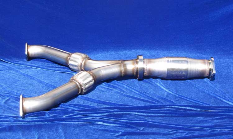

AHHHHH I see I see.
but do you mind if I ask the purpose of this?
to keep back pressure or something?

It's to keep a cat in the system, helps for emissions testing etc, and a lot of people don't like the smell of raw engine fumes.
Besides, it *is* better for the environment

So then why not just run a cat where the factory one is located? Like a Berk?
instead of the ART pipes?

Because the ART pipes don't lose the same power/torque as regular test pipes. On top of that, as confirmed by a few tuners, there seems to be some benefit from moving the cat away from the engine.

all exhaust responses are spot on with my thinking! with the xyz pipe you can get 3 different attachments that bolt right up, a high flow cat, a resonator, or just run straight pipe. I chose the hfc because I wanted to run test pipes and after some research (yes the search function does actually work here ) found that the art test pipes were pretty much second to none so I called up concept z performance and talked to joe and told him what I wanted and asked him if he could make me a deal and he did! put my order together and I should be receiving it soon. The reason I chose the hfc option is because I would still like to have a cat on my car (for legal reasons being as how I live in PA) but since the test pipes were going where the stock cats were originally obviously I couldn't put one there. That is another reason I chose the xyz pipe in fact, so I could still have the hfc and utilize the benefits of test pipes

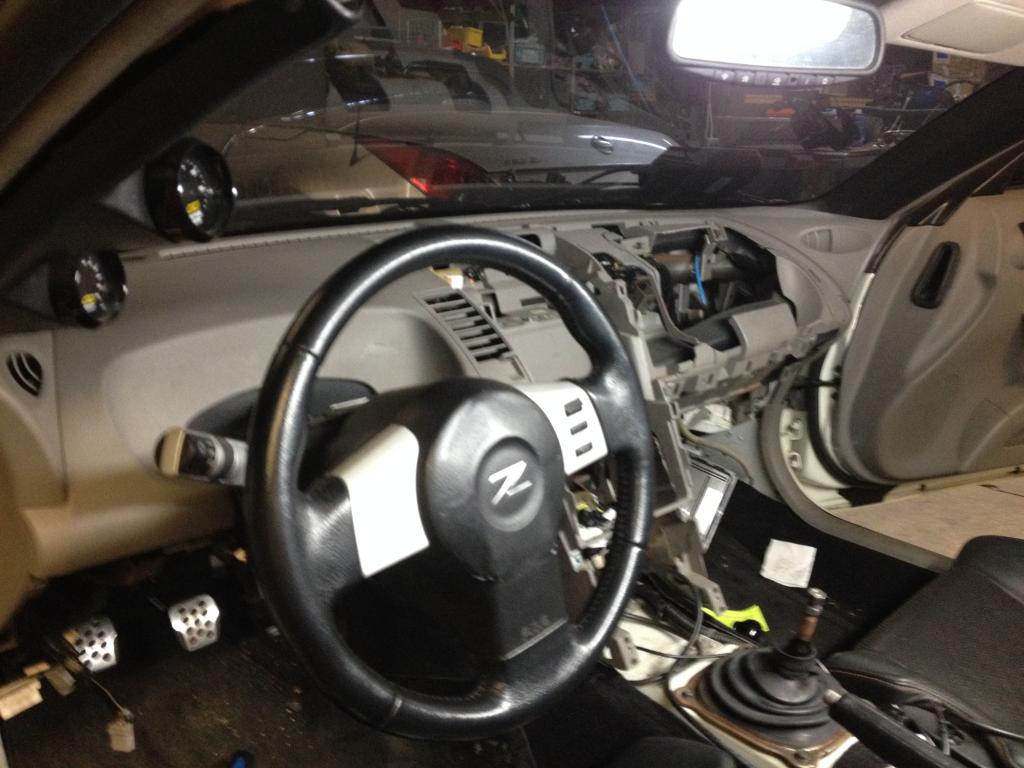

Went by the shop and swapped my dash out for a black one, I will get the door panels switched next time I go up there.

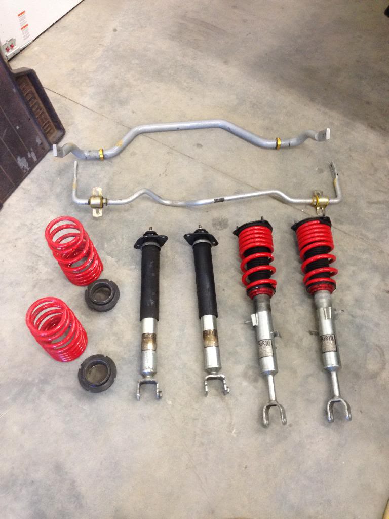

Installed h&r coilovers, whiteline sway bars, and my zeetoyz engine bay caps.

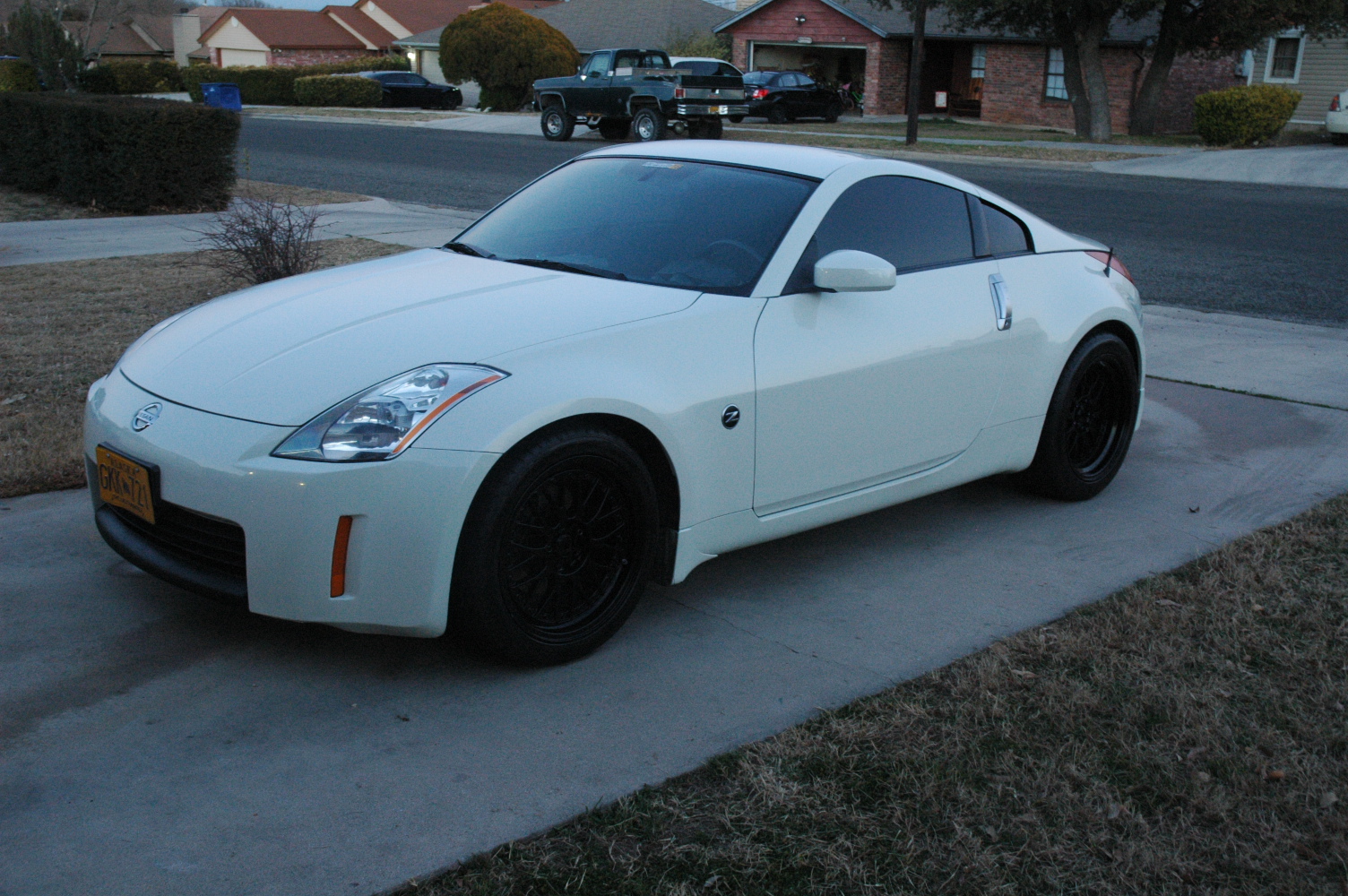

Default Just a simple wash
clean

Bmurray how you liking the whiteline sways? I am getting them put on this Friday.

Haven't really had a chance to throw it around any turns yet but just driving normal I can already tell it's stiffer combined with the coilovers too

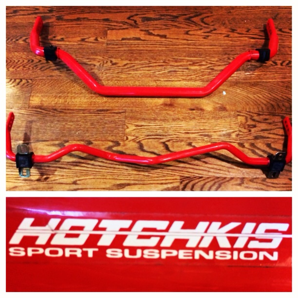

My Z got some new lingerie today Just got em put in, and put them on hole 3 in the front, 2 in the back. 82% stiffer than stock up front, 125% in rear. Handles like a dream, especially with the differential. No pics of the diff, that went in a few weeks ago. I replaced the bushings on the sway bars before they went in, and also installed 2 pairs of aluminum collars to keep the bars from sliding -- heard this was a minor issue with the Hotchkis sways since they're hollow and don't have welded collars. Install was a breeze, one of the best mods I've ever done, and the difference is certainly there.
Got a great deal on em!

How much did you get them for?

think that is how i have mine set
