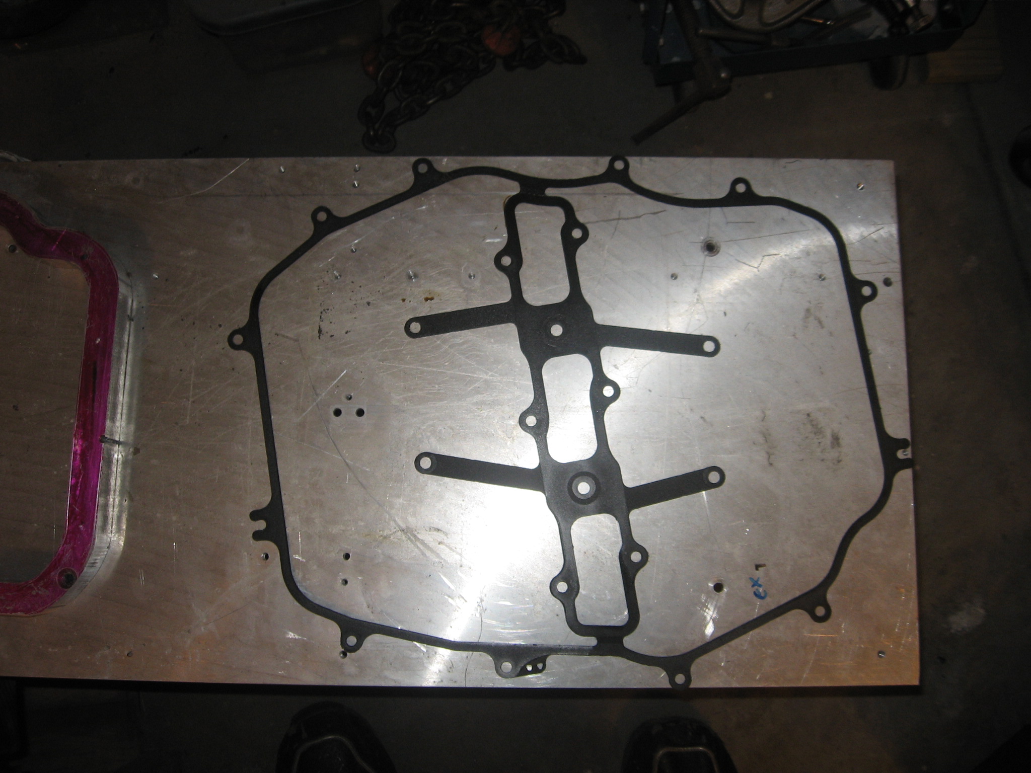

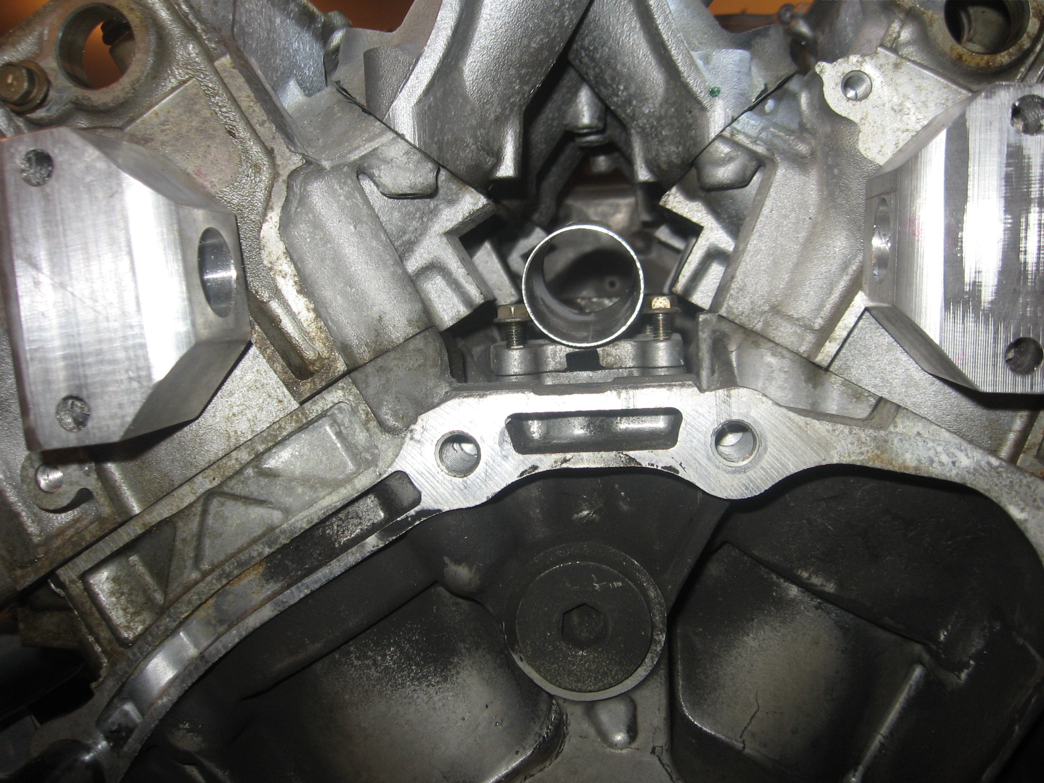

Whent to the scrap yard Wednesday and got some aluminum to make a oil pan spacer, intake spacer and get rid of the coolant cross over hose/tube in the rear of the heads.I need to get some 1 1/4 round stock to finish the coolant tubes. I"m running it down the center under the lower intake I need the room for a twin turbo set up. After I get it all wielded up I'll tap in some line for the turbo's and the temp sensor.(This is not a original idea of mine I got the idea from a post in the FI forum just put my twist on it)might start the plenum spacer this weekend. Waiting for some -10 fitting to plumb in for the oil returns, $40.00 in aluminum and 3 hours in the barn away from the in-laws a great day for me

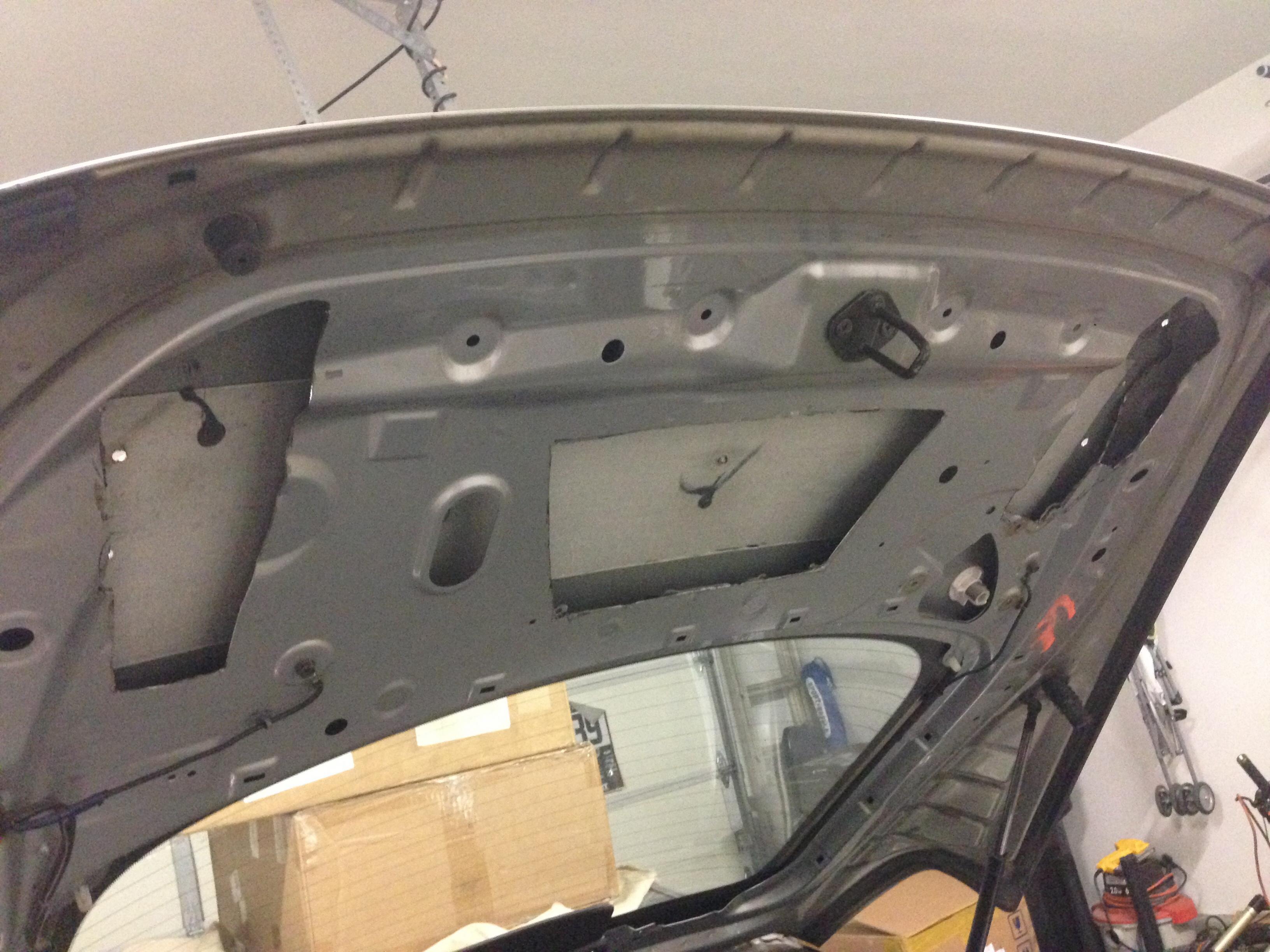

Putting in work to mount the new wing.
