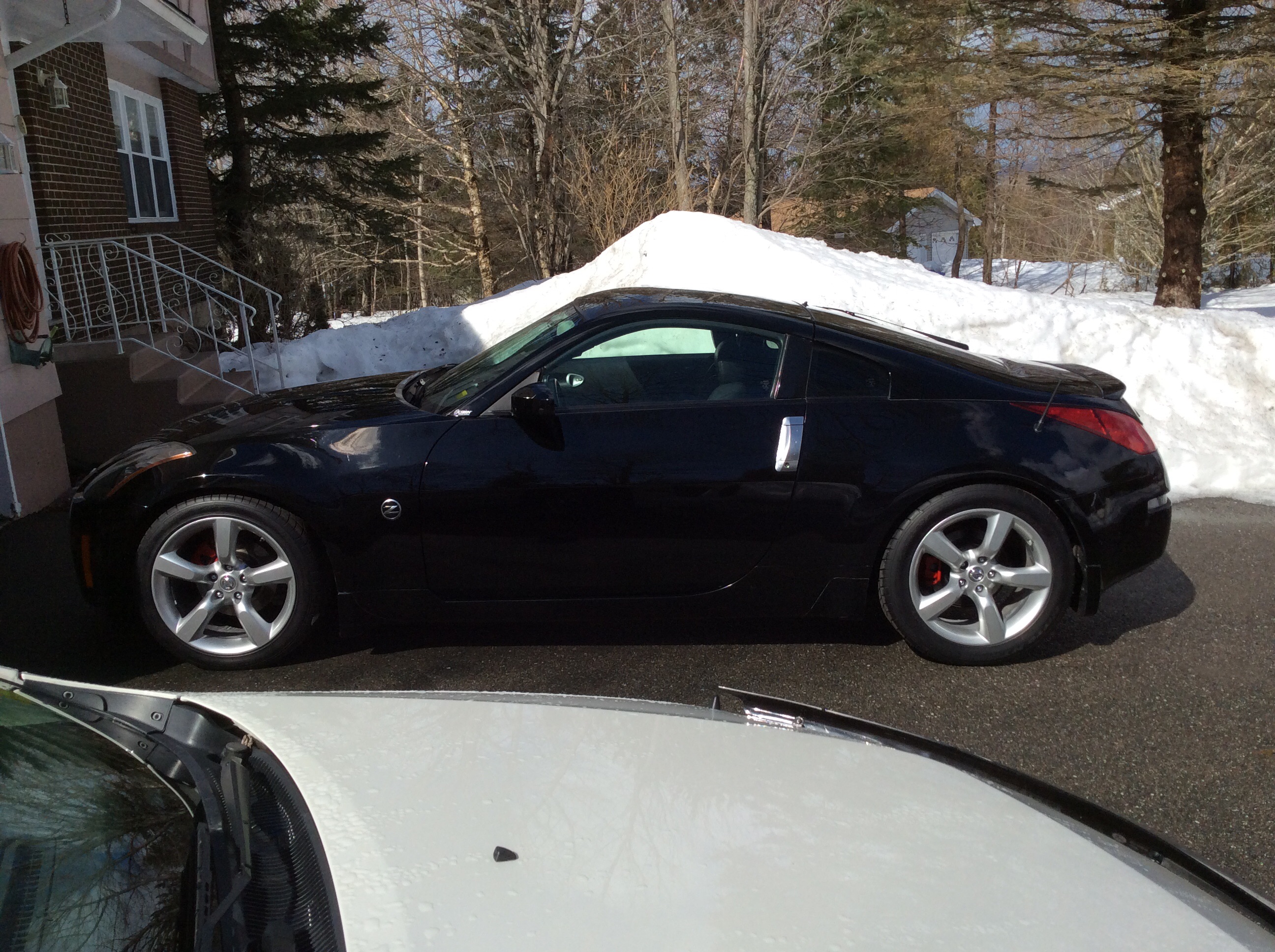

Backed the car out of the garage, finally!
Here it is April 11th and look at the snow. Won't be diving on the roads till the first of May!
Welcome to eastern Canada.

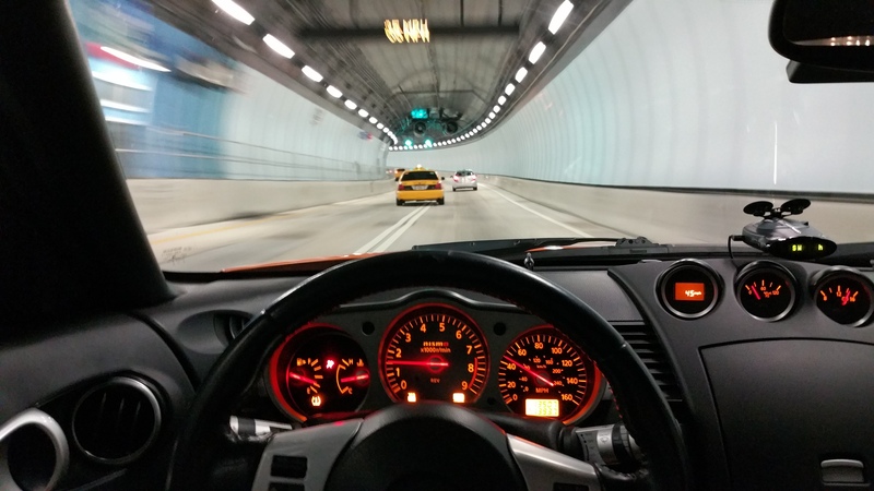

Took her out for a ride by the bay. Name:  20150411_111605.jpg

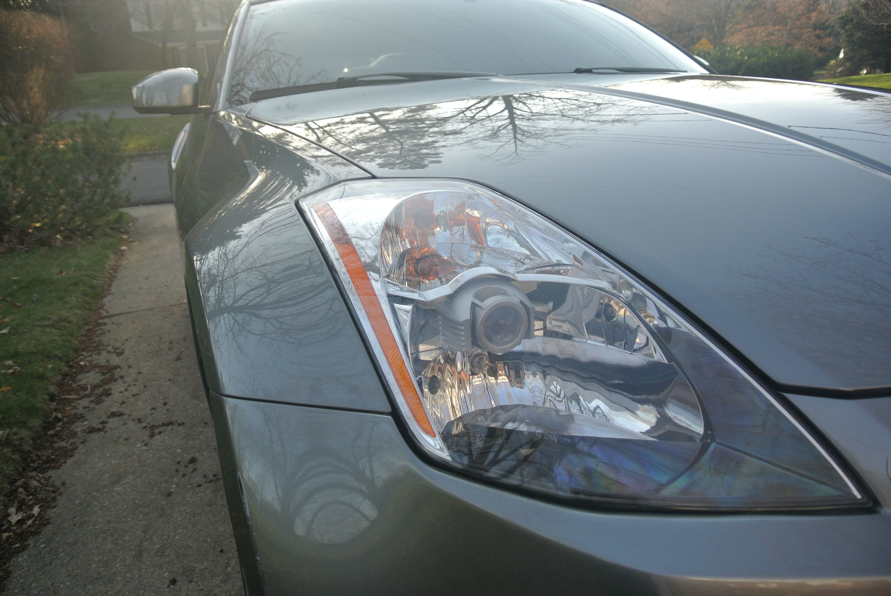

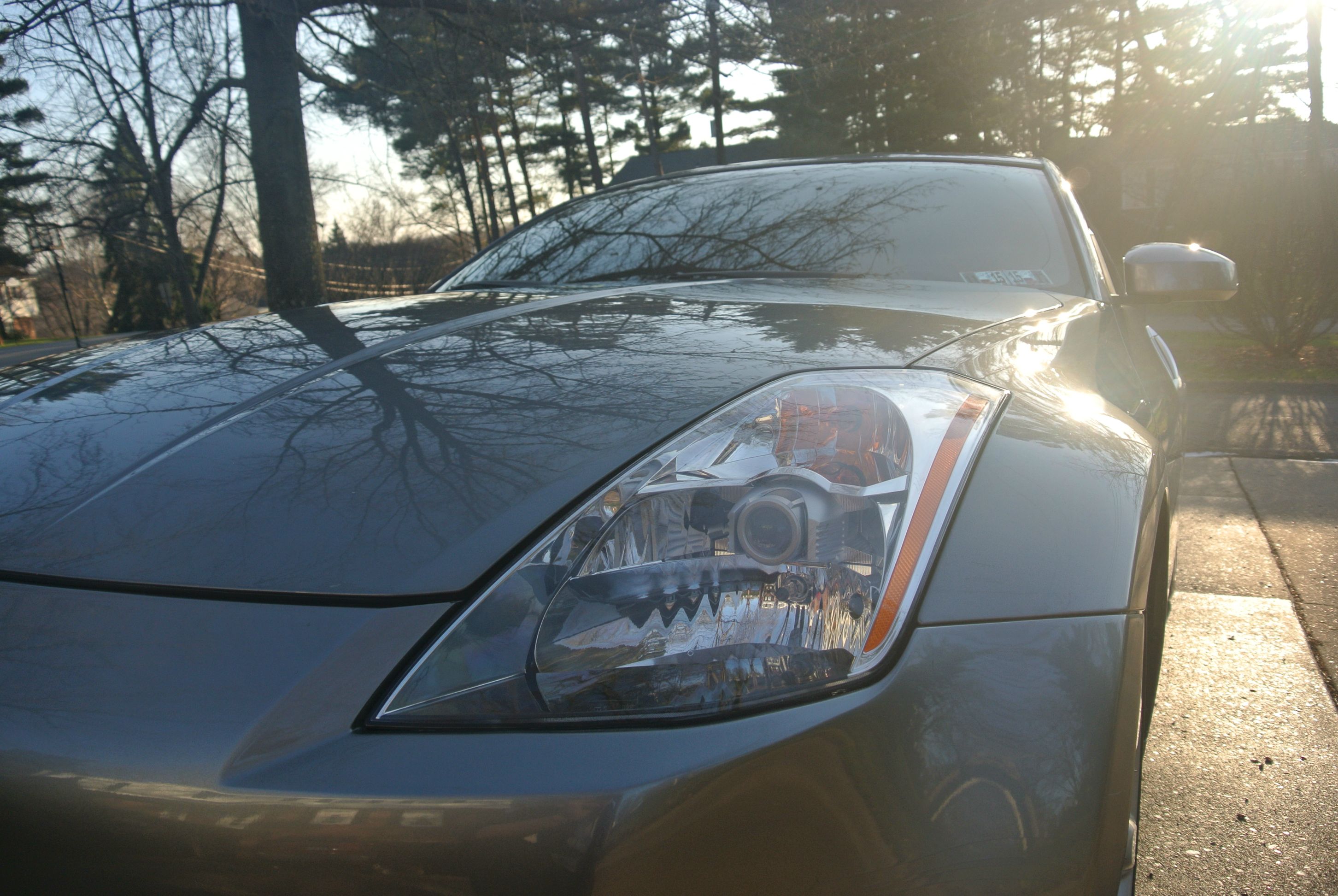

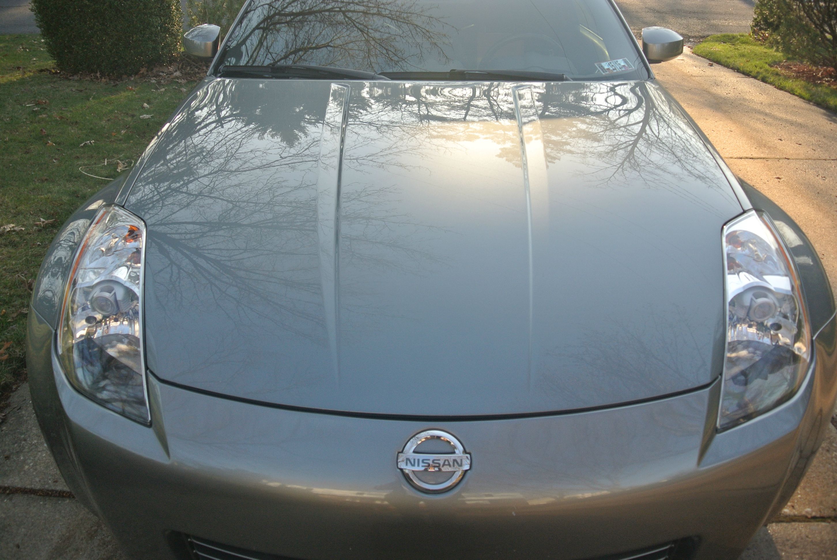

Inspired by the headlight restorations a few pages back I started work in earnest on my 2005 Z. Wet-sanded with 1500, 2000, 2500, and 3000, then polished with a porter cable. Megs microfiber cutting and finishing pads worked well using Menzerna FG400 and Sonax Perfect Finish respectively. I would recommend taking off the front bumper and/or removing the headlights altogether if you want to be able to polish the front corners and edges with a random orbital polisher.

Did you clear coat them?
