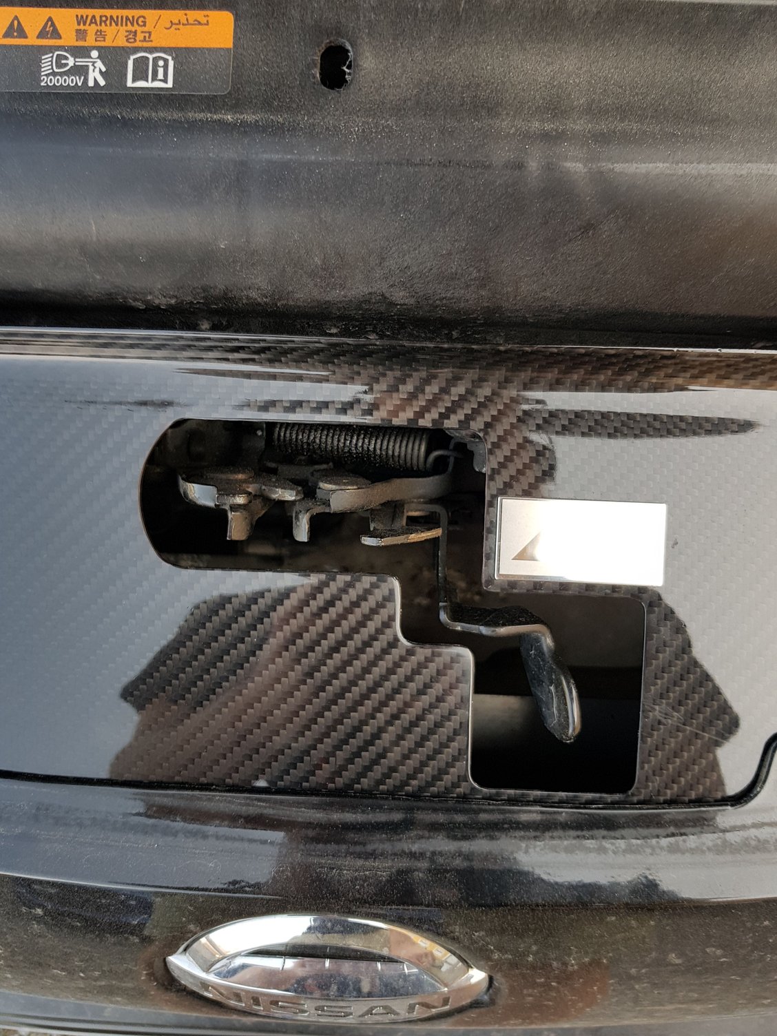

Can i ask you what kind of modification did you have to do to get the APR cooling plate to fit your HR?Mine looks like it wont fit around the plastic nub that holds the hood prop rod.

@Painterguy39
Correct, it wont fit without modification as it's designed for a DE. I think I have pictures of my phone somewhere, I'll try an get them for you if I don't forget.
I just measured out what needed to be cut and went wild with a dremel. You have to cut out a piece around the hood prop and also where the hood latch mechanism sticks through, the hole isn't big enough for the HR mechanism.
Cut smaller than you need and then grind out the last bit. And wear a suitable mask, carbon fiber is not somthing you want to breathe in.
I "sealed" the cut edges with a black marker, looks like it was factory molded.

Second this on photos, maybe I'll shoot you a message on IG, but I just bought one and encountered the same issue. Was wondering how well this piece takes to getting cut before I sell it to a friend lol.

@Painterguy39 sorry for the late reply. Here's what the finished cuts need to look like in order to clear the latch and hood prop holder thingy.

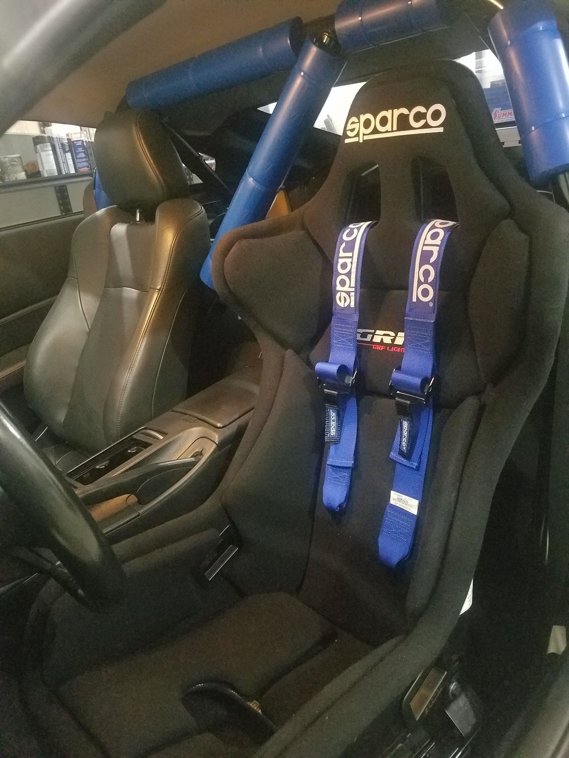

Got the harness halfway mounted in and bought some steel to make reinforcement plates for the anchors.

Hey another question for you, did the holes for the bumper clips line up also? Mine seem to be a bit off, i wanted to check with you before i begin trimming.

@BQPham I dont remember for sure if I trimmed them out or not. I remember them fitting sorta, like if you squint your eyes and only look at maybe 2 of em at a time they kinda fit.
DE bumpers might fit differently. Just trim away!
