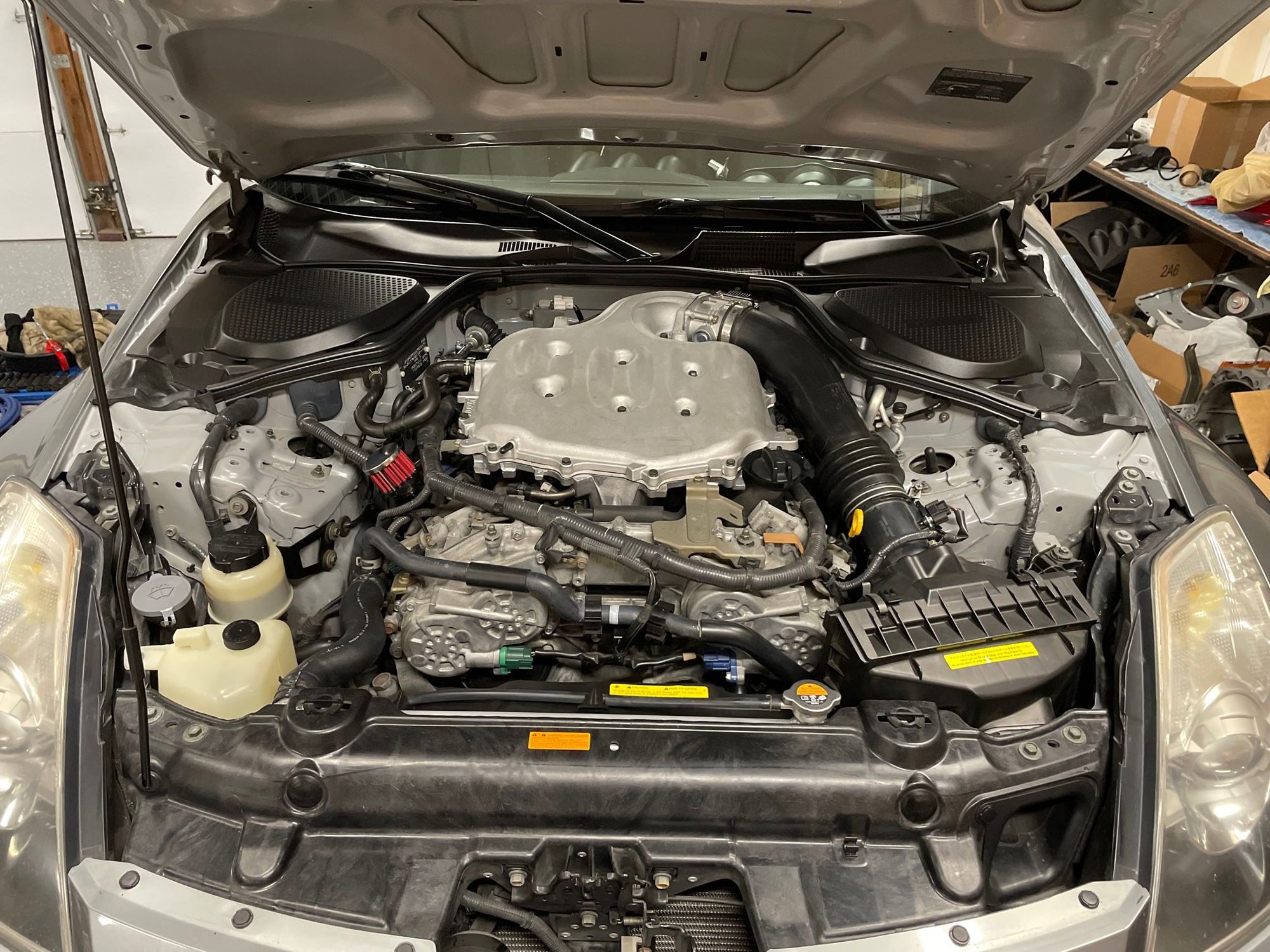

Once that work was completed, it was time to get moving on the MREV2 lower plenum swap/install. I pulled the parts off my old engine that I have sitting on a stand in the garage. All the main components were thoroughly cleaned with a brush and some gasoline. There was a small amount of oil in the gallery of the lower plenum, common on VQs. All the bolts were soaked in gas and brushed clean. The throttle body was especially dirty on the inner portion. Extra care was applied while cleaning the E-throttle. I used E-throttle safe cleaner to gently remove all the grit. The stock plenum on the Z was then removed and swapped over to my old engine on the stand and I proceeded with the mrev2 install, carefully following Motordyne's clear and well written/documented instructions. I'm honestly shocked that the main bolts for the plenum are held on with less than 10ft/lbs (100in/lbs).
Once the plenum was plumbed up, it was time to install the airbox + tube and prepare for the coolant flush and 1st start in 2 months. I used the Schwarben coolant refill tool to vacuum test the system and initiate the 1st fill with distilled water + Prestone Coolant Flush detergent. All went well with the refill. I used a 5 gallon bucket to act as my fill reservoir for the Schwarben pickup hose. The car sucked down about 2.5 gallons per fill. Not all was perfect though, as there was still some air trapped in the system, even with the vacuum fill. In hindsight, I suspect this might have been the way I used the tool. A small amount of air still gets introduced from the pickup hose. I'm guessing if you want a completely air-free fill with this tool, you need to 1st prime the pickup hose, close the pickup valve, then open the venturi valves to re-pull a vacuum before starting the fill. After using the Schwarben tool for the Flush cycle, I decided to go with the tried and true method of the Spill Free funnel and cracking open the bleeder port at the battery box firewall. This method takes longer, but at the time I thought it was the safer route.
Before engine start, I made sure to prime the oiling system by holding down both the gas and clutch pedal while cranking the engine for 15 seconds.
The flush cycle was run for about 30 minutes, intermittently blipping the throttle to cycle out air bubbles and break up any debris/crud. The drained fluid smelled like sewage and was murky with small particulates/debris, nothing crazy bad though (no black or brown sludge). I'm not sure what the smell was from, perhaps it was the Prestone Detergent. I've used this stuff before and don't recall that smell. To ensure I got as much of the detergent out as possible, I followed up with 3 rinse cycles using pure distilled water. Lasting about 20-30min each. I allowed for the engine to fully warm up and continued with the standard throttle blips while monitoring the temps at the heater vent and fluid levels at the funnel. All went smoothly. This was my 1st time going through a coolant drain and fill process on a 350Z and to be honest, it's really not difficult to bleed the air out. Just use a simple spill free funnel and make sure to crack the bleeder port when filling up the system. Warm up the engine (get the thermostat to open), and blip the throttle a few times between the fan cycles. Do this for 10-15min after the thermostat has opened and you should be good. You can tell when you've gotten air out by monitoring the funnel fluid levels and checking temp at the heater vents. If you get super hot air coming from the vents when the engine is sitting at idle you're good. If you only get super hot air when you rev the engine, then you still have air trapped.
Note: About draining the system, I did this while the engine/fluid was still hot. This was intentional, I wanted to get as much of the fluid out as possible while the thermostat was still open. I also didn't want to pull one of the block plugs for fear of stripping one of these out or introducing a potential leak point. This was calculated and done with caution. Since I was using the funnel, the system was not under active pressure.
After the 3rd rinse cycle (which was crystal clear), I topped off the system with the OEM Long Life Coolant. For good measure, I came back the next morning and ran the engine for another 20-25min doing the same thing, but this time with the radiator cap installed and the overflow reservoir connected and filled to the MAX line. No fluid bubble noises heard from the dash upon startup and the heat was working very quickly.

Engine bay after plenum swap and coolant flush cycles completed.

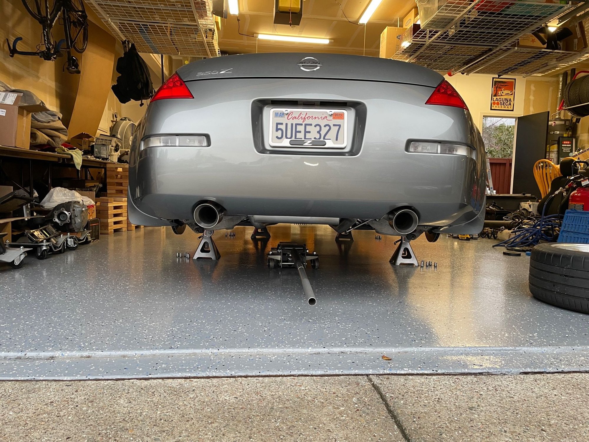

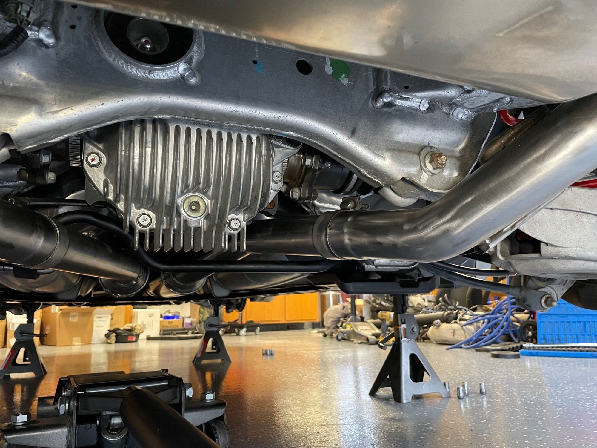

1) Fix exhaust leaks at the X-Pipe.

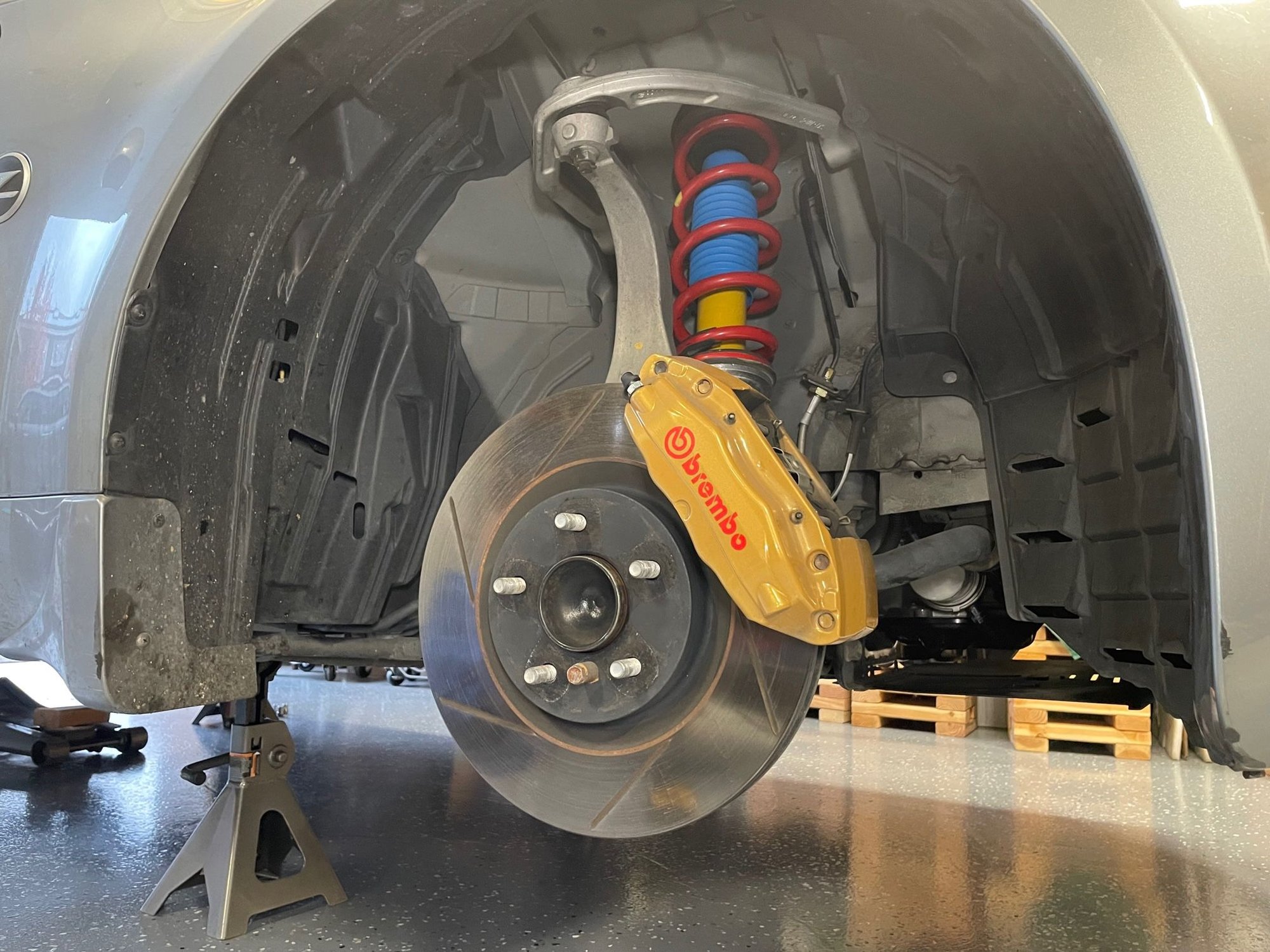

2) Install Bilstein struts + Nismo Coil Springs.
3) Road test shake down & Tune RJM clutch pedal.
4) Appointment scheduled at ZCG for alignment, tune, inspection.

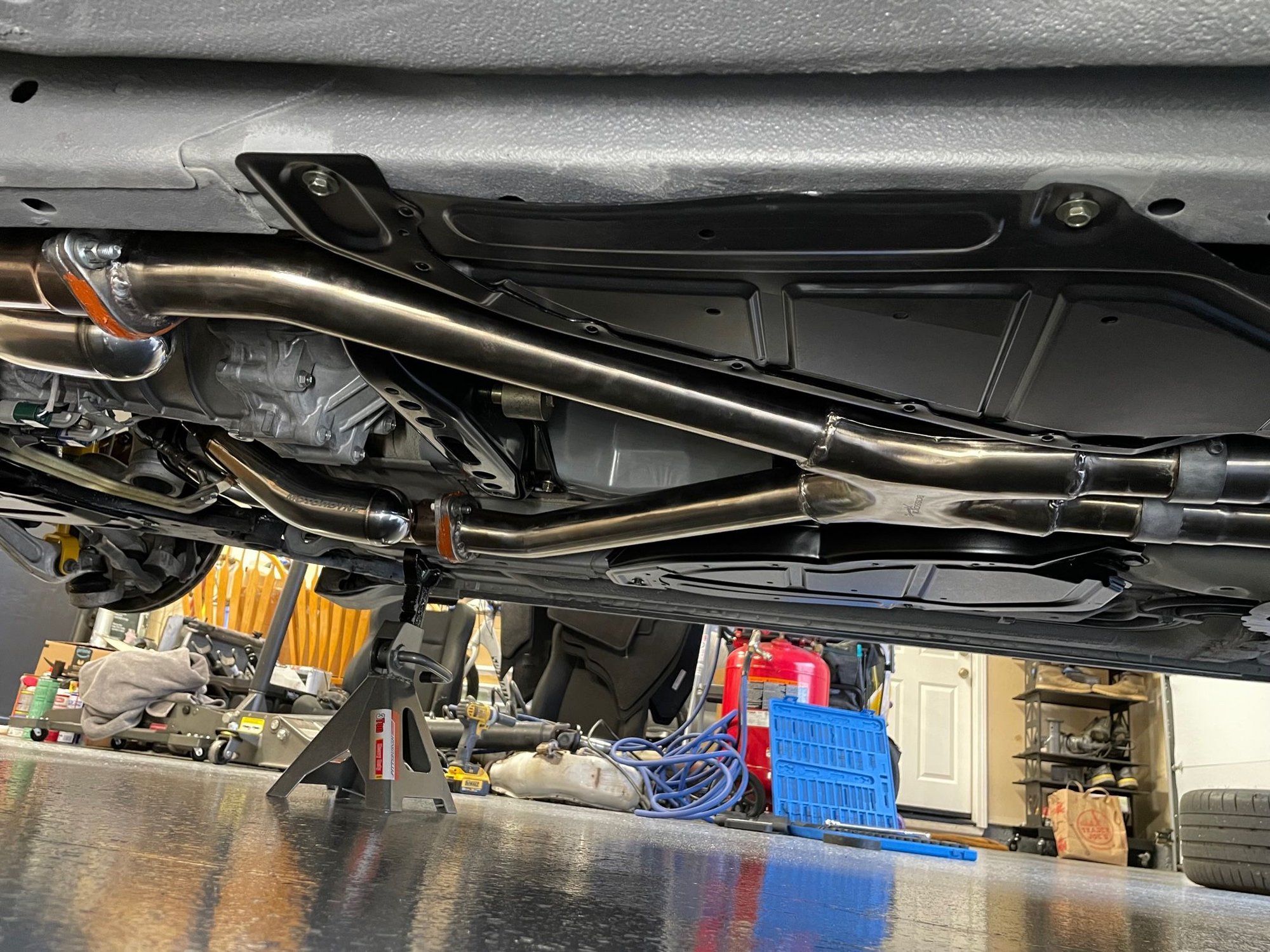

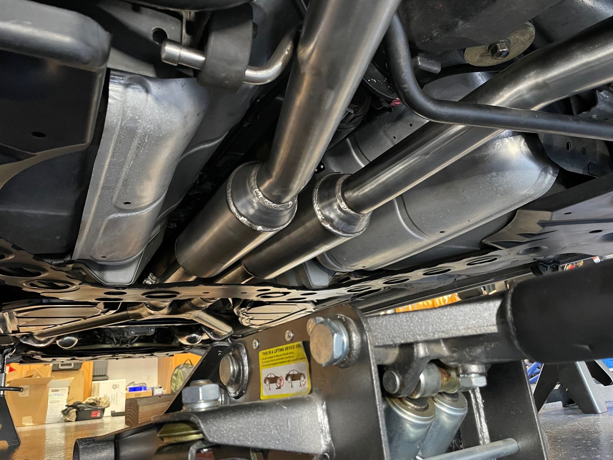

The exhaust issue has been fixed. I was able to save both gaskets and re-seal them using fresh Permatex Ultra Copper....a lot of it. This still doesn't address the alignment issues, but it's a good med-long term fix until I can get an exhaust shop to weld in some flex joints. Once that was squared away, it was time to get the old OEM struts and coils out and get the new Bilstein B6 HDs and Nismo coils installed. During this process I replaced the rear strut hat bushings with new sets from KYB. I also tossed the OEM paper gasket that's sandwiched between the chassis and rear strut hat in favor of a custom made gasket I cut out of a sheet of 1mm thick neoprene (good stuff, very durable). This will ensure rear-end creaks and noises from the struts have been eliminated. The overall strut & coil install went smoothly. I especially like how easy it was to "clock" or "index" the front struts thanks to the Bilstein lower spring seat design. The lower seat can freely rotate around the strut body. By comparison, the OEM strut lower seats are welded in place, same for the Koni Yellows I had in the past. This can make getting the upper hat bolts and the lower strut fork alignment a real pain, not so with the Bilsteins! I think I spent the same amount of time on the fronts as I did with the rears and the fronts have the added complexity of using a spring compressor.

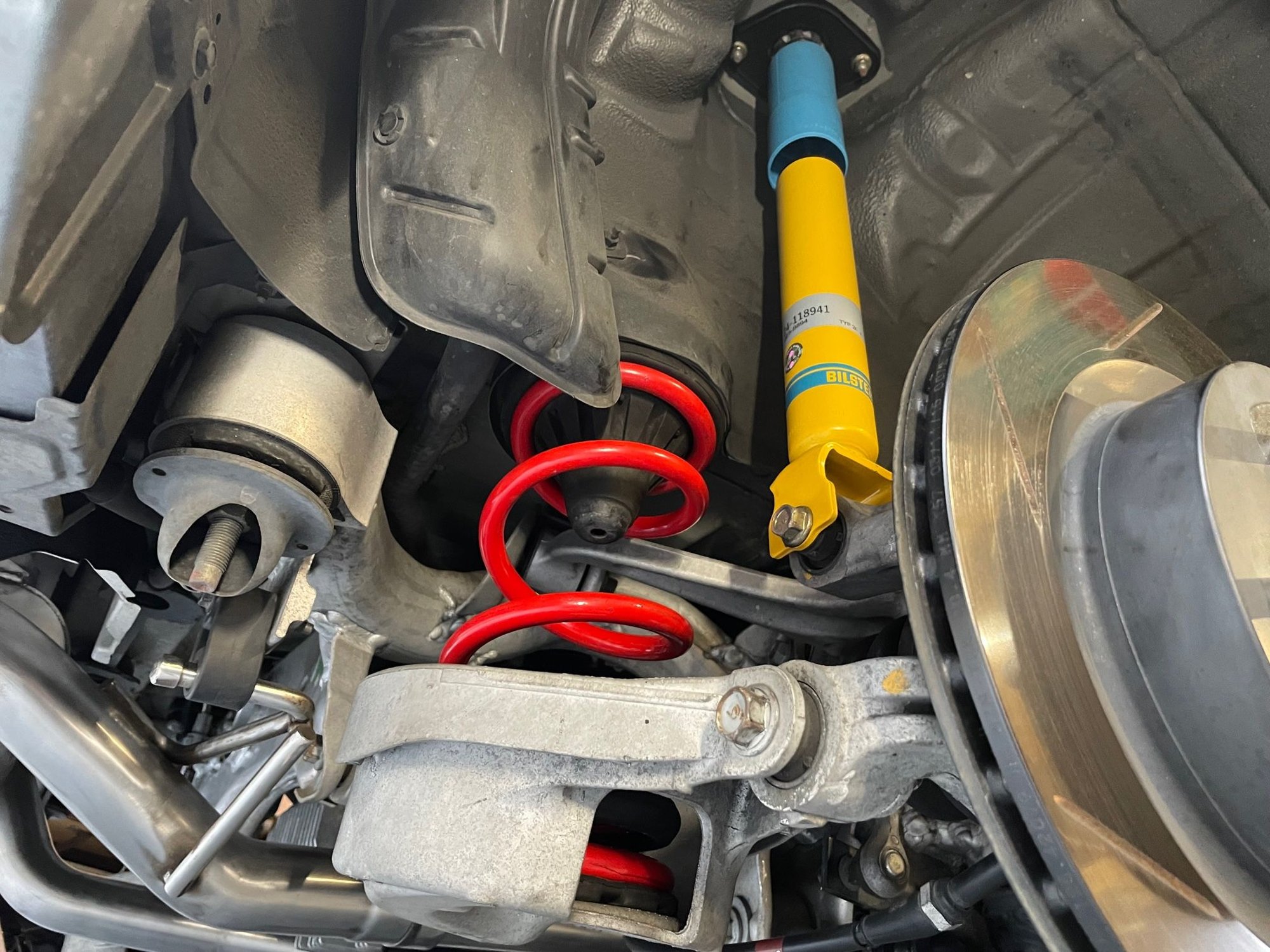

After the suspension work was done, it was finally time for a shake down test drive. Right away I noticed that the clutch pedal travel/stroke was very short using the pre-set RJM clutch pedal settings. This is not necessarily a bad thing, the clutch would still disengage without issue, but it did require me to push the pedal to the bump stop, this made the engagement point very low. More on this later. In short, the Z drives great. The new clutch and flywheel combo is a winner in my book. It's extremely quiet, virtually no cement mixer noises coming from the bell housing with the pedal out. Engagement is very smooth, zero chatter. I'm very happy with the 18.4lb flywheel choice, the torsional vibration (gearbox lash chatter) I was experiencing before with my Specialty Z flywheel was far worse. If you daily an NA Z33, this is an excellent clutch/fw combo. I'm also happy to report that the suspension and rear diff feel great. This combination of the B6s & the OEM Nismo coils is excellent. The car isn't bouncy or jarring at all, zero NVH issues, yet the chassis feels firm and planted in the corners and over bumps. It's really an excellent balance between performance and comfort. Bear in mind that I'm running stock bushings all around except for the rear differential (Whiteline). More of the OEM bushings will eventually get replaced, I already noticed the front LCA strut bushings beginning to crack. I'll keep an eye on the suspect bushings and replace as needed. My 1st test drive was short (maybe 15-20min) using country roads with plenty of bumps, elevation changes, and twisties. I was satisfied with the results and knew I needed to make adjustments to the RJM pedal, but this would have to wait until the next weekend as it was 3AM and I was exhausted from the suspension work.
FF to the following weekend. I decided to swap out the CZP PCV delete kit (you can see the filter on bank 1 valve cover in previous post) and replace it with the Mishimoto OCC kit. While doing some digging the week prior, I discovered a cache of brand new OEM PCV hoses and some front sway bar bushings. I had completely forgotten about these! When I installed the Mishimoto OCC, I noticed the PCV valve hose had really hardened. It felt like plastic and was already cracking at the intake manifold side. So, the crossover tube between the valve covers and the bank 2 hoses got replaced with fresh rubber. Next, I made adjustments to the RJM pedal. I dropped the AFP setting to something around 50% (Not an exact science), down from 100%. This lengthened the stroke of the master cylinder. I also adjusted the angle of the foot pedal so it sticks out slightly (closer to the driver) more than the other pedals. After that was said and done, I took the Z out for it's second shake down. The new settings of the clutch pedal felt more to my liking. The awkwardness I experienced before is gone. I was banging through the gears with confidence again! This time I was really able to enjoy the car while the sun was still shining. It feels like a totally different machine now and I love it.

Exhaust tips aligned nicely. Bumper looking fresh.
Muffler shot.
Rear end looking fresh.
Mid-pipes looking fresh.

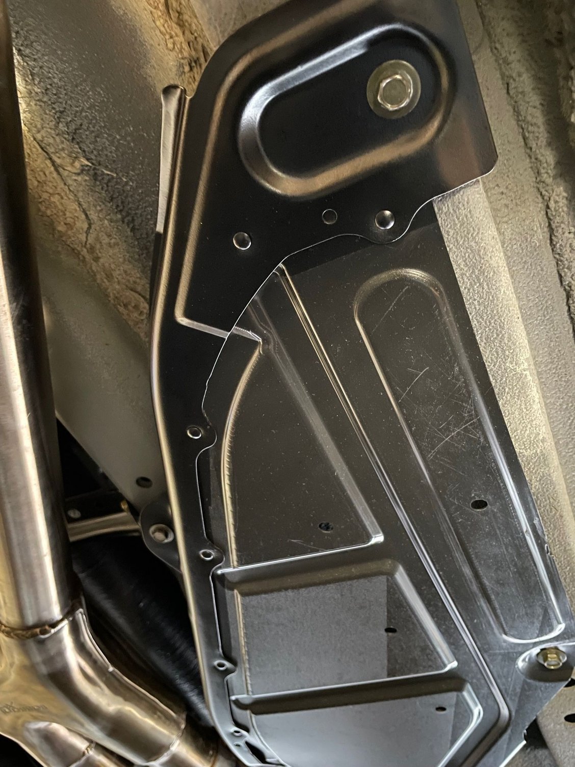

Troublesome X-Pipe now leak free thanks to RTV shmoo.
Undercarriage shot. Notice the flanges to X-pipe are staggered.
Re-conditioned W-Brace looking fresh.

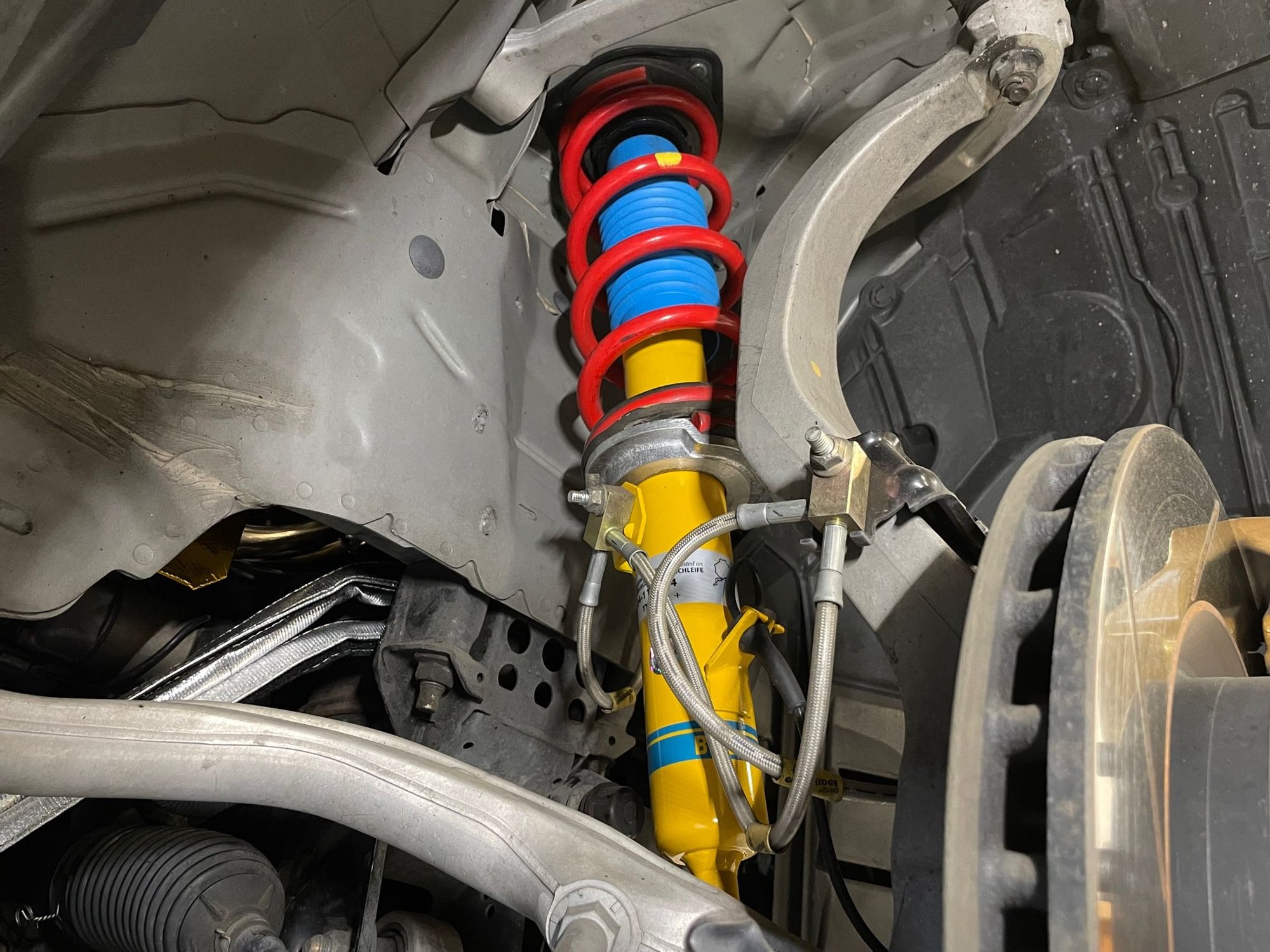

Front Right Bilstein B6 + OEM Nismo Coil combo. Looking very colorful.
Front Right again, better angle. Shows SS line routing.
Rear right corner.
Rear right combo, better angle.

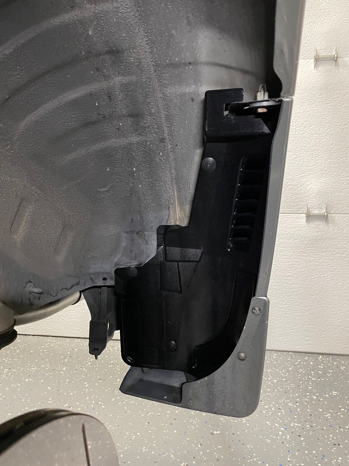

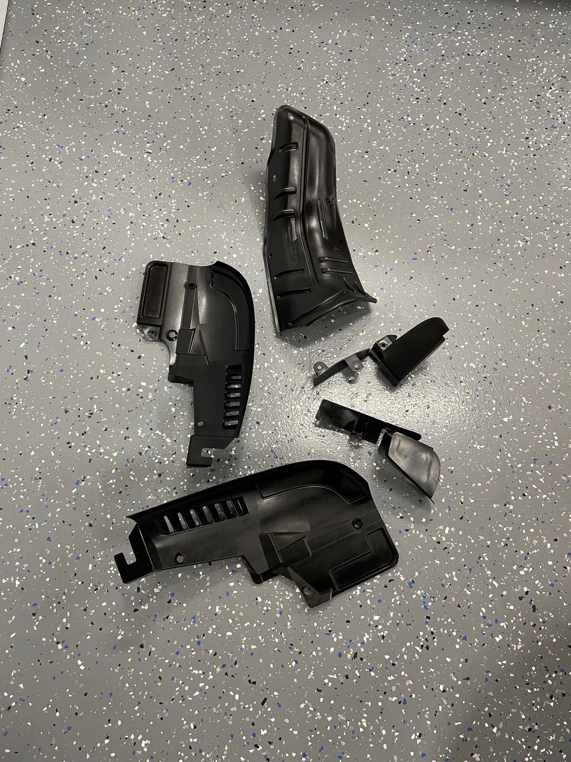

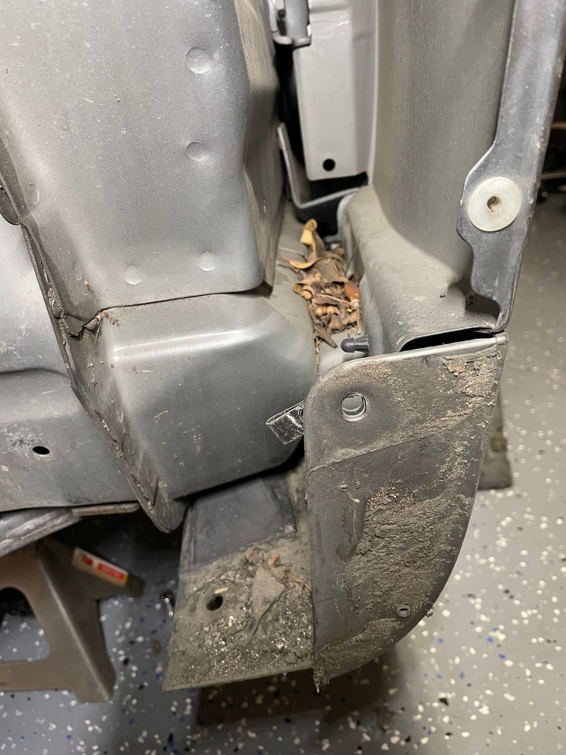

Rocker and Fender debris! A lot of it fell onto the floor out of frame when I pulled down the liner, believe me, it was bad!
Front wheels after IronX cleaning.
Rear wheels after IronX cleaning.

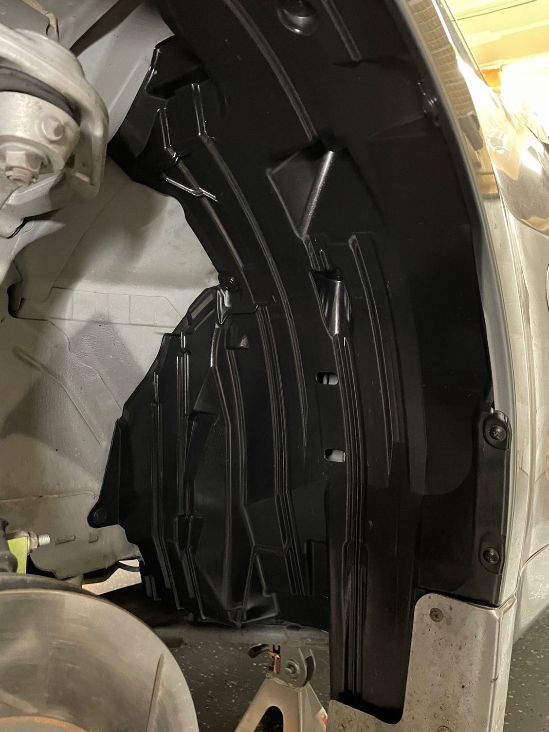

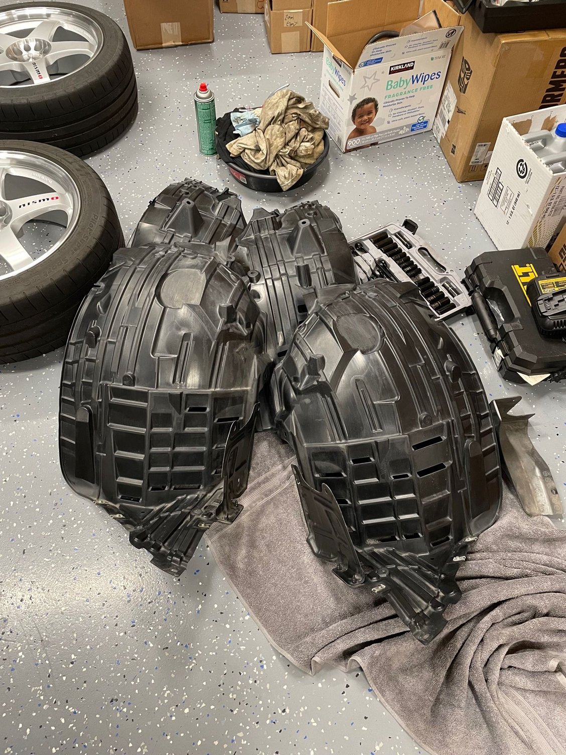

Front Fender Liners, cleaned, not treated. Showing the backsides, doh!
Rear plastics after cleaning and treatment. Looking fresh!

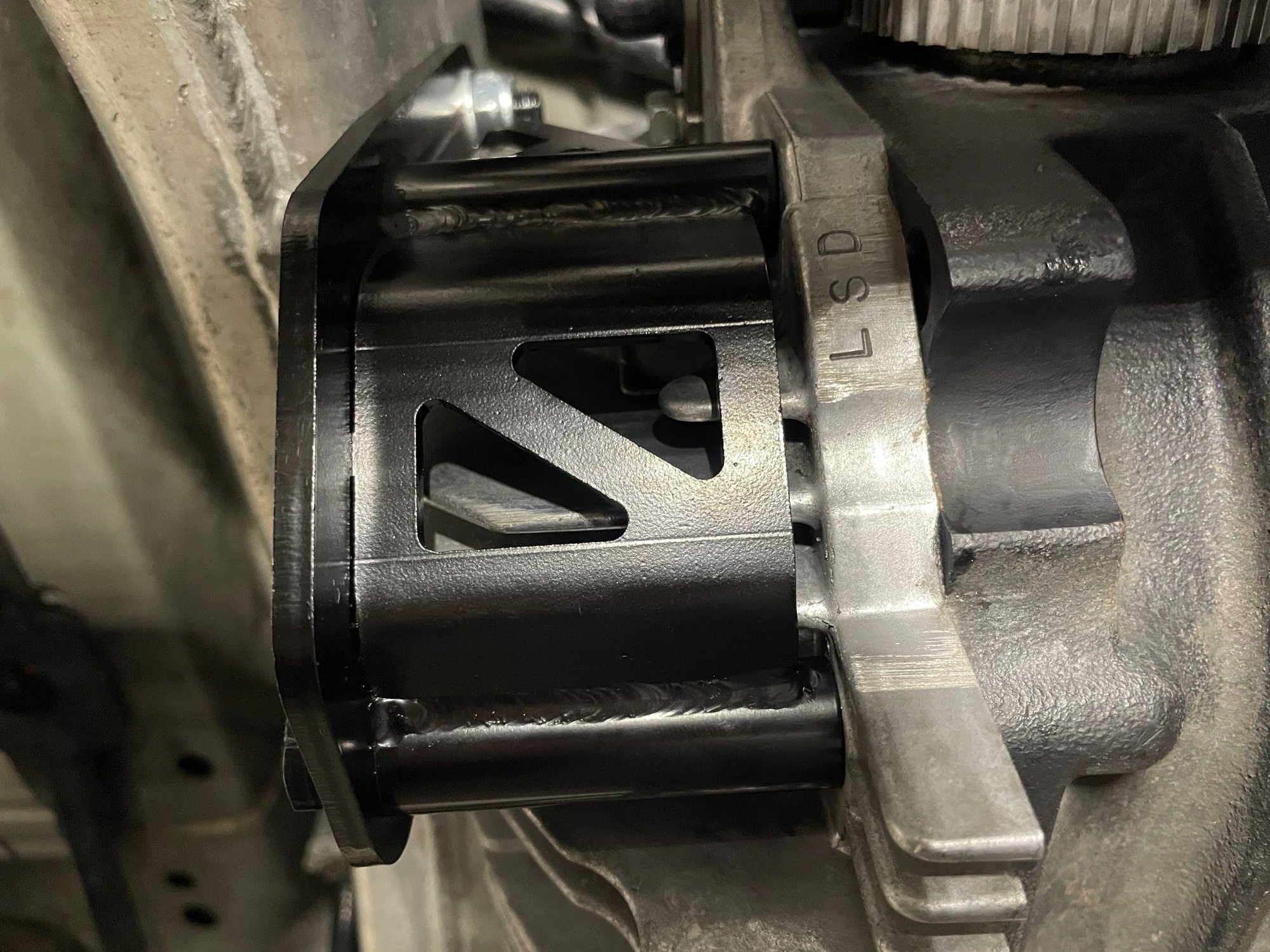

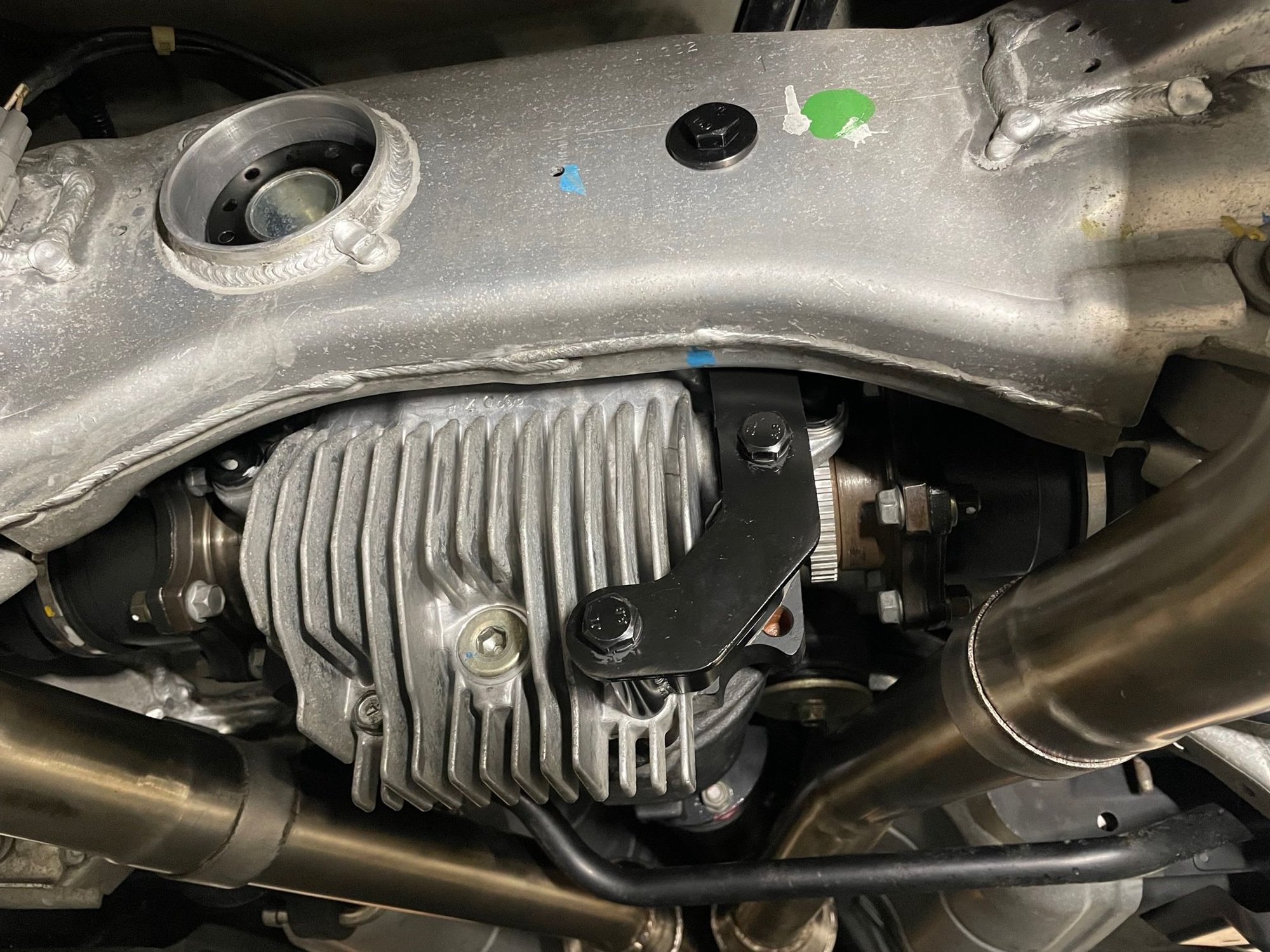

Almost forgot, GKtech diff brace going in. I'm curious to see how this feels. I'll sell it if it causes NVH.

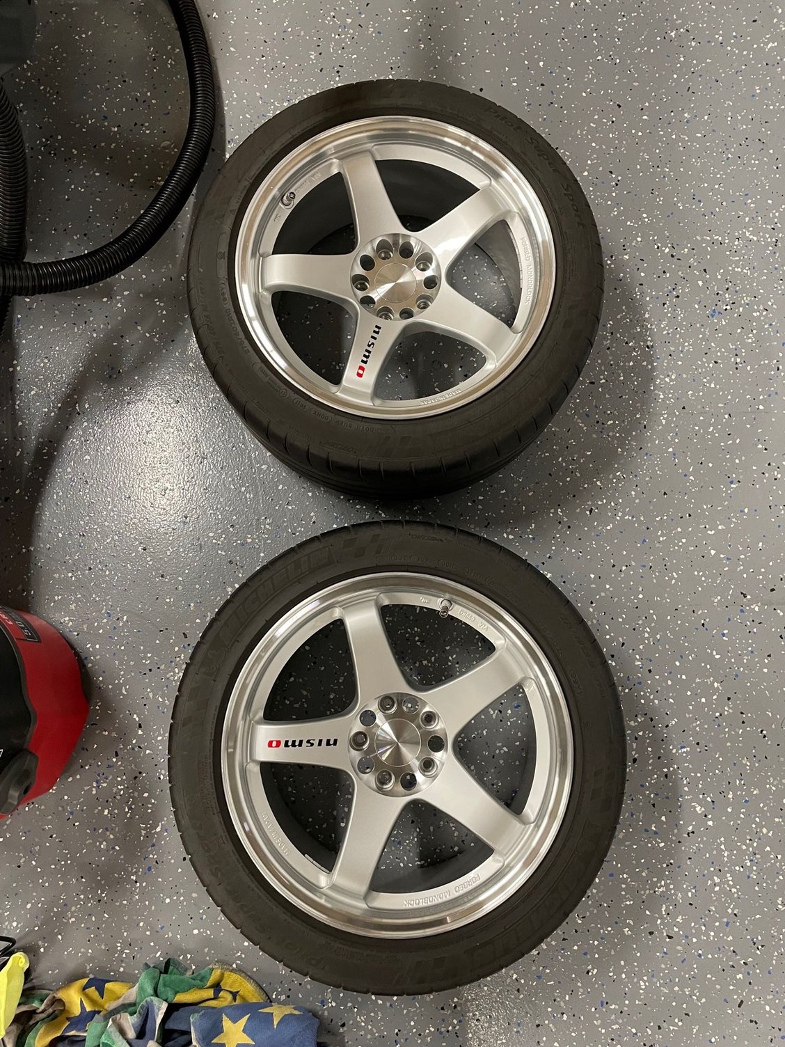

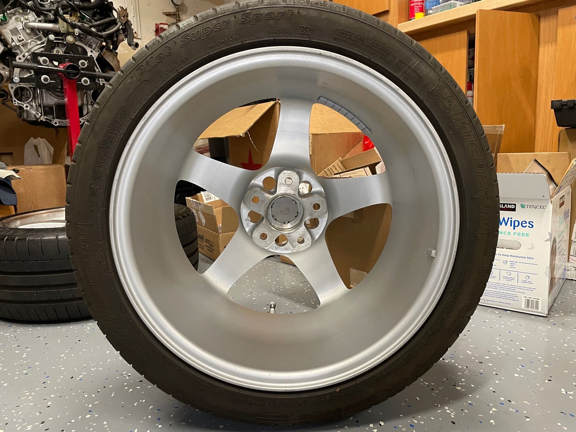

The wheels, tires, and liners are done! Looking super sharp! A lot of effort now will make future cleanings/washes super easy with some wheel woolies and ultimately save a lot of time. I didn't bother cleaning up the painted portion of the mud/rock guards since those will be getting replaced with new, freshly painted units. Unfortunately, I didn't have enough available time this weekend to get the Gktech diff brace or front sway bar bushings installed. I'll take care of that this coming weekend. Just wanted to show the amazing results I got from the wheel wax, consider this post a partial review of the product.
I was impressed with how easy it was to work with the Swissvax wheel wax. It goes on super easy with a foam wax pad and buffs off easy with a plush microfiber, leaving behind a very nice shine and buttery smooth surface. You only need a small amount of this wax, no need to go nuts with it. A single 50ml jar will last years if you only use it on your own vehicle(s). No joke, it made my wheels feel like a non-stick pan (as it should since the wax contains PTFE). It doesn't smell like chocolate as advertised, it smells more like Smarties if you know that candy. The only real detractor I can think of is the poor visibility (contrast) I had with the product against the color of my wheels. Seriously, this stuff is near invisible. The thin waxy film it leaves behind is very difficult to see. This makes it hard to know which areas you covered vs. those you haven't. So, either be very systematic about how you apply it, or run over the entire area twice for peace of mind. I used a combination of both! I had the most trouble seeing the applied wax when I coated the inner barrel and back of the spokes. There's no high-gloss clear coat on this part of the wheel, making it a satin finish. The front face of the wheel does have a glossy clear coat adding just enough contrast for me to see the areas I covered.
To get the same results I did, start with IronX and follow the instructions. Use a plastic razorblade or other type of non-scratch scraper to remove stubborn road tar/asphalt sticking to the inner barrel or outer dish. To further remove tar stains and grease, I used a microfiber with a dab of paint thinner. No joke, paint thinner eats right through greases & tar and will not hurt modern paints (To be safe, always do a test in a non-visible area 1st). Lastly, I did a final cleaning with 70% isopropyl before applying the wheel wax. I also used some of the wax on the outer faces of the Brembo Calipers, again this will make follow-up washes/cleanings much easier! The calipers really pop as an added bonus!
As I mentioned in my previous post, I like to use Tire Mud Gel from AMMO NYC for the sidewall dressing. After a few minutes of setup, it leaves a beautiful satin finish that lasts for weeks to months depending on road conditions and car wash intervals.
The wheel liners look great and do have that "wet" look even after a wipe down with a microfiber. In this case, I'm all good with it, no sling to worry about. Mud and other road sling won't stick hard on the plastic liners after this treatment, again saving time during future washes/cleanings. No longer having the faded liners really makes the wheels/tires/brakes pop!

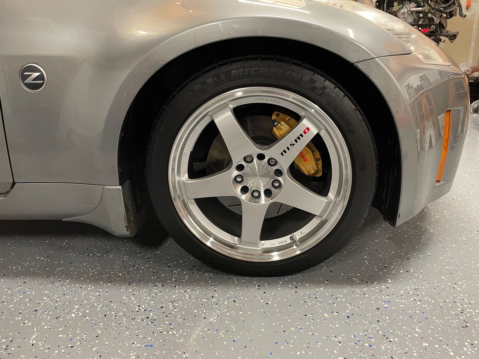

Front wheels fully cleaned and waxed with sidewall dressing.
Wheel barrel and spokes.
360 degree shot of the wheel barrel and spokes. Zero road tar. Imperfections left are pits, chips, or stains.
FL-F liner looking fantastic.
FL-R liner looking amazing as well.
RL liner with the same treatment.
FR wheel mounted and looking sharp.
The Z as it sits now with the new suspension. I haven't even washed it yet!

Holiday Special Z Refresh Update...
Well Christmas and New Years have come and gone. Over my two week break from the daily grind, I was able to spare some time to work on the Z. The new front sway bar bushings were installed, but it was a struggle. One bolt on the passenger side rounded off and had to be drilled out, then busted off. The single nut on the driver's side also rounded off and had to be cut and broken off. I'm usually extremely careful when cracking bolts/nuts free and you would think these bolts/nuts would be cake, but in my case they were all over-torqued. So much so, that all the frame threads have been pulled. These are M10x1.25 and sadly my thread chaser set does not have the 1.25 thread pitch (only 1.5 and 1.00). I'll have to purchase an entirely new metric set for this one size (doh!). The good news is that there's still enough meat on the threads for the sway bar to be safely secured and torqued to spec, things just don't thread on easily by hand.

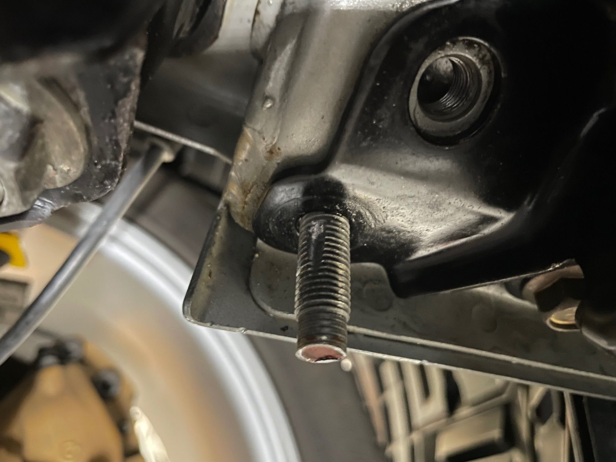

I also did some rust prevention on the front sub frame. Nothing crazy, I sanded and wire wheeled all the lose paint and rust off the engine support + brace and used some rust reformer primer and followed up with Satin Black paint (Both Rust-oleum). Sadly I didn't stop to take pictures during all that work. But the paint job finished up about as good as you would expect when using a paint brush instead of a spray can. I didn't want to risk overspray getting all over the place and using a spray can on your back doesn't work very well. But at least now I don't need to worry about more rusty paint flaking off and the underbody looks very clean front to back now.
I moved on to interior work since the weather here has been both wet and windy. I really wanted to get a wash, clay bar, polish, and wax in on the Z, but it wasn't in the cards for me, at least for now. So both seats came out and everything got vacuumed and steam cleaned. I used a Lilly Brush to take care of all the lint, human hair, and pet hair clinging to the carpet (If you have pets or shed a lot, these things are life changing!) There was quite a bit of hair left behind from the previous owner(s). I've had this car in my care for nearly 5 years and I never once detailed the interior, I promised myself I wouldn't give it that level of TLC until the serious mechanical issues were addressed.
The driver seat bottoms between the existing chair and my old chair were swapped (very easy to do, just 4x12mm bolts at the bottom of the seat pan/frame). Although the seat cover on the new chair is in better shape, the side bolster foam near the manual seat ***** is cracked/torn internally and needs to be repaired. This made long drives feel awkward and uncomfortable. Even though my old seat has seen more usage/mileage, I was always careful about how I planted my butt when getting in and out of my car, so the bolster hasn't deteriorated as badly. The interior carpet looks new and the seats almost as good as new. Pro-Tip, hot steam on your seat foam/cushions actually causes them to puff back up and rejuvenate them. It really works wonders for older seats that are starting to look saggy. Don't use hot steam if you have leather though! For the repair, I may take the bolster from my old passenger seat, the center section is unique on the driver's side, but the side bolsters are identical. I may sacrifice my old passenger seat to rebuild the driver seat, or look for a Z33 passenger seat bottom at the local Pick-N-Pull. Z33s are starting to show up in the yards now, never thought I would see that happen.
Now for the fun bit. The Z was taken into Z Car Garage on Thursday the 5th for a solid inspection, alignment, and dyno tune with Uprev Reflash. The inspection discovered two minor issues. One; The forward diff bushings were installed upside-down and two; Under load there was some minor contact occurring with my exhaust muffler assembly and the rear crash bar (where those unnecessary plastic bumper hangers are). The diff bushings surprised me, because I never altered the position of these. I simply removed the diff from my old chassis and it sat in my garage until I was ready to install in the new chassis. If the orientation was wrong, the original installer made the mistake, and that was ZCG. Glad that little mishap was discovered and fixed. I was extremely careful about the exhaust install to make sure nothing was making contact that shouldn't be and all pieces were hanging with adequate clearance. I think I know what happened. When I dropped the X-Pipe to fix the exhaust leaks, I may have tweaked the rear assembly during the re-install. Nothing important was injured, that plastic hanger got a tiny bit melted though. Post inspection, the Z got a 4-wheel alignment and it needed it. The car had a subtle pull to the right, even before I installed the new struts and coils, now it tracks like an arrow and feels great. Lastly, the Z got treated to a visit in the Dyno bay with Rob Fuller working his magic. I'm very pleased with the results, these are considerable gains and very respectable numbers for an NA Revup DE. I don't think hardly any more power could be gained without going FI or modifying things to the point of never passing CA's strict emissions standards (ART Pipes aside in my case, which are easy enough to swap out for OEM cats).
After getting the Z back home, I took some time to try installing the Gktech diff brace AGAIN. Yes, I tried installing this component the same day I did the front sway bar bushings, but the alignment was terrible. It would have required a lot of grinding to get it to bolt up nicely and I was so upset about the poor fitment that I threw it back in it's box and started on the front sway bar bushings (yeah...that was a bad car day). I'm glad I didn't modify things until after the ZCG inspection because the diff brace is in now! I did still have to grind about 1/16th of an inch off the center bolt guide (where it mates with the diff cover), but at least this time around, the bolts were able to all align and thread in cleanly. I probably could have used a dead-blow hammer to tape the brace in place without grinding any material off, but I don't like hammering steel against aluminum, bad things can happen.
The last thing I did to the Z before heading back to work, was an A/C cleaning (interior heater/evap core box), using Kool-It from Lubegard. I used two full bottles, and even after the 2nd bottle, the drained out detergent was still looking a little brown. But so far the Heat/AC shows no signs of stank, time will tell. Some history...this Z, has had a mildew odor from the AC vents since the day I purchased it. I suspect this was from the humidity in San Diego (where the Z spent it's prior life) combined with the fact that Z33s don't have cabin filters. I have already addressed the cabin filter issue by modifying the blower box and installing a proper filter meant for Altimas of the same vintage. If this attempt fails, I'll be pulling apart the passenger side of the core box (near the expansion valve), and getting at it with my steam cleaner. Not a fun task, but much easier than ripping apart the whole dash to fix an odor issue. If anyone has any suggestions or alternate solutions to this issue, I'm all ears.
Remaining Mechanical items to tackle on the Z...NONE.
Remaining Cosmetic items...MANY/VARIOUS.
I'll continue to post updates as I progress on the cosmetics and I'll try to make sure to get more pictures (before & after shots). I like to take my time when it comes to the cosmetics, and some of the issues I plan to address require a warmer season, but for now, I plan to enjoy the car when I can...at least until after these storms decide to let up for a few days! Sheesh! Been raining here almost non-stop for 3 straight weeks! (Unusual for CA).
Cheers!
-Icer
Drilled out sway bar Bolt.
Accidentally nipped the sway bar frame stud when cutting the rounded nut. Doh!
Lilly Brush FTW. Seriously get one if you have pets! Works great on upholstery!

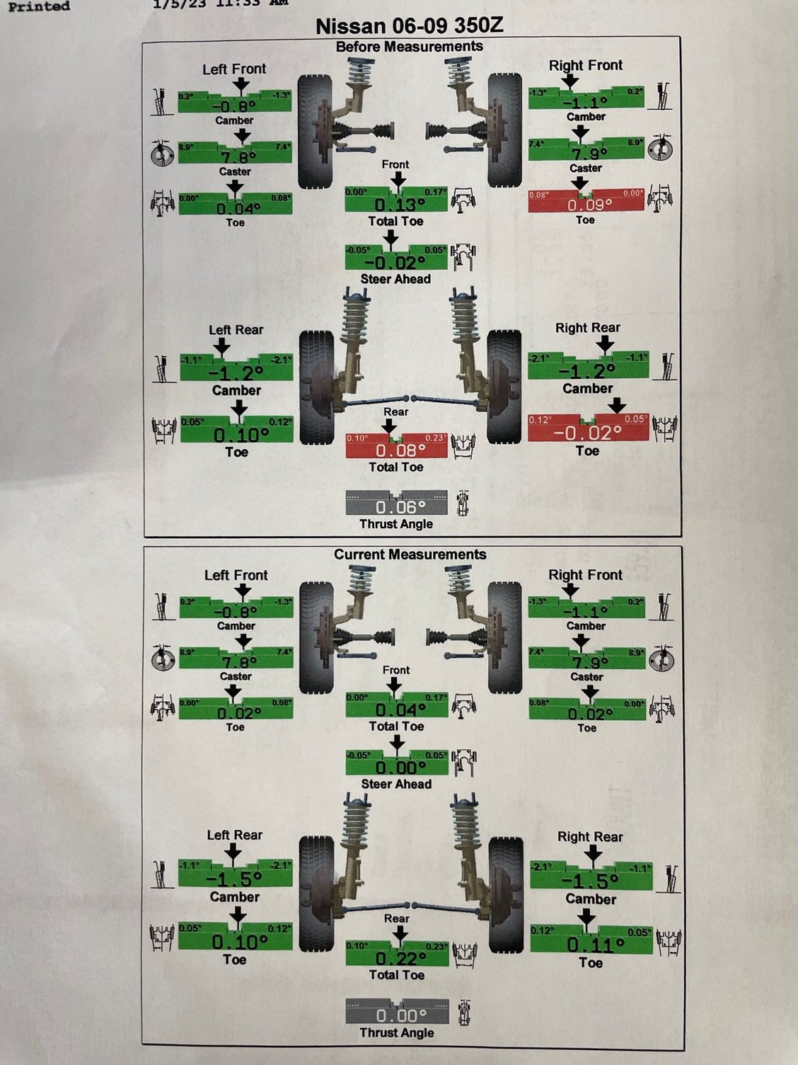

Alignment chart, before and after.
Old Dyno chart (2012) for comparison. Run on my old Z chassis when it was still mostly stock. Take with a grain of salt.
New Dyno chart, after all the work I've done.
Gktech diff brace finally in!
Side shot of the brace.
