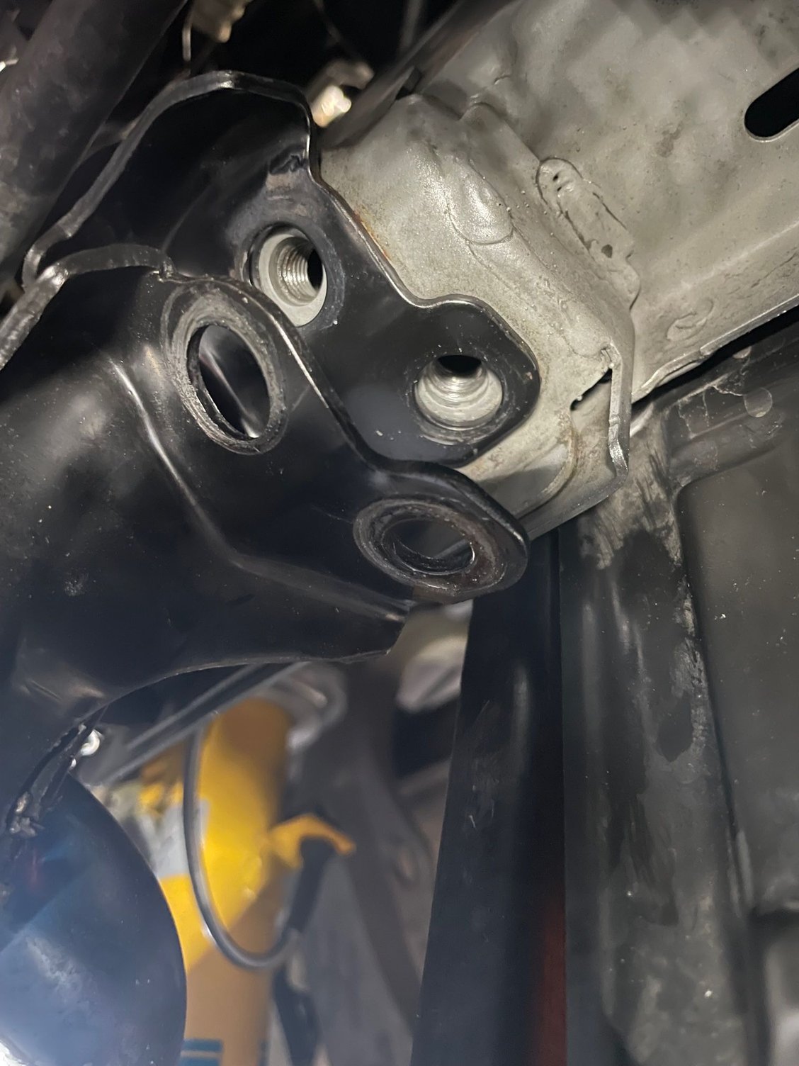

Z Refresh update....
Last update before I dropped the Z off at the bodyshop.
In one of my previous posts, I talked about the front sway bar mounts and how the threads in the frame were in a bad way. This past weekend I went back in there with a thread restorer/chaser. I had to purchase an entire metric set just to get the size I needed as my master kit did not include it. (FYI, that size is M10 x 1.25, this is used a lot on our Zs). I also purchased new OEM bolts and nuts since I suspect the original set may also have been compromised, either the threads on the bolts were also pulled or I may have damaged some of the hex heads during the 1st removal. Now I can easily thread all the new fasteners in freely by hand, none of them feel loose. Torqueing to spec was a breeze, also there is a specific order for removing and re-installing these fasteners, detailed in the FSM under the front suspension (fsu) section.
After knocking out the front sway bar, I went to the rear and replaced the rear sway bar bushings as well. These were not completely worn out, but I noticed after replacing the front bushings, that I could no longer slide the sway bar left and right by hand, it was very solid. The rear sway bar could be easily moved from side to side by hand until hitting the limiter rings. I'm not sure if that's normal or not, but I suppose wisdom would say the more solid the better in this circumstance. In any case, the bushings were the originals from 2006 and we all know rubber dries out over time, so I installed new OEM bushings in the rear. This only took about 15 minutes all said and done (setting up the wheel chalks, jack, and jack stands, etc). Now the rear sway bar is nice and tight.

Driver's side front frame holes after chasing/restoring them.
A quick note about sway bars. To work correctly, they should be able to move freely in their bushings. Most OEM sway bar bushings are too tight. With the end links disconnected, if you raise the bar and let it go, it should fall freely and not stay up. When setting up a race car suspension, I often place a washer between the bracket and the frame to space it out. This usually fixes the binding. Any binding is adding to the spring rate of the bar.

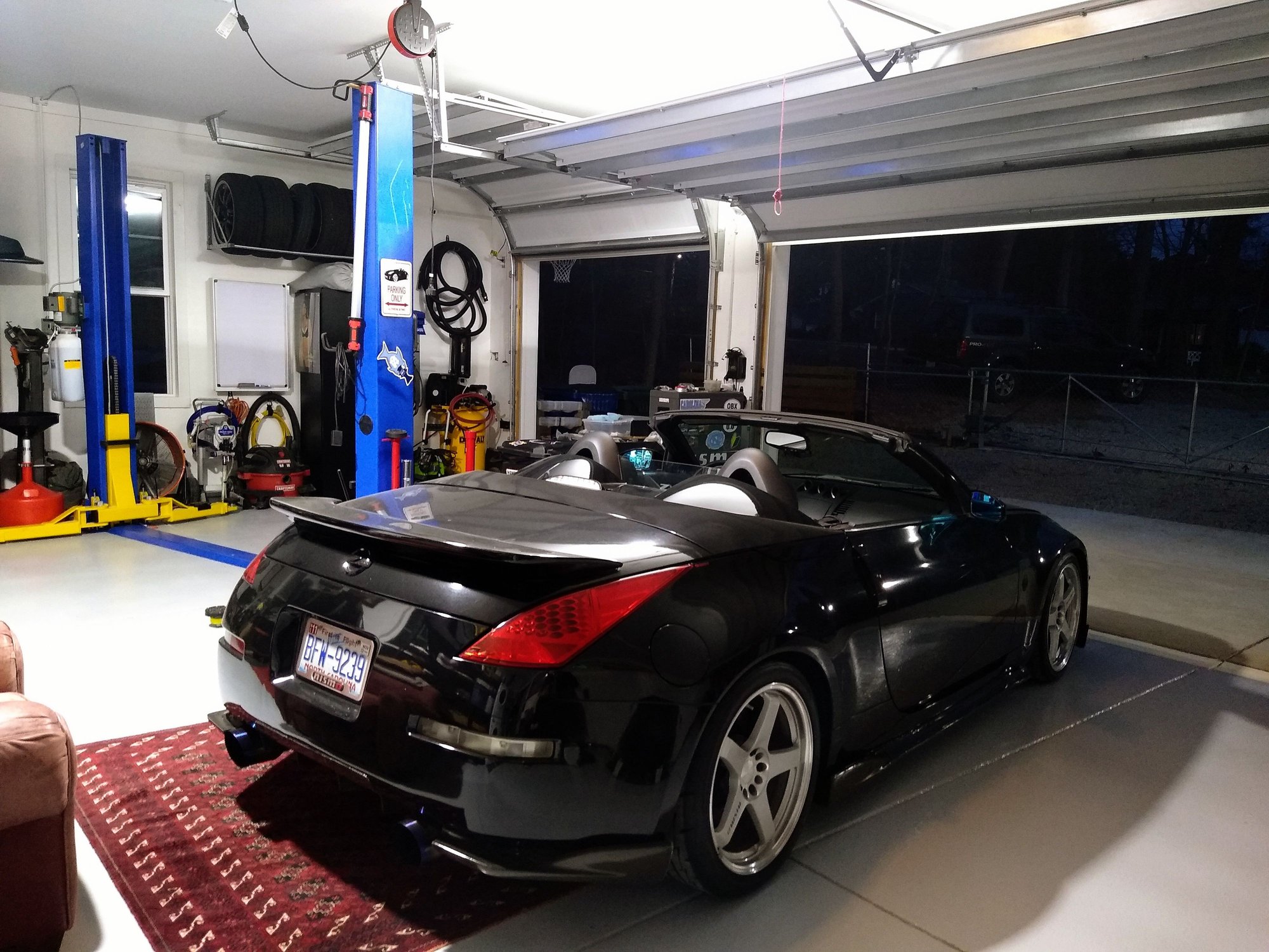

Unseasonably warm weather (mid 70s) demanded a quick cruise after work.
First time she's been out in a couple months.
Thanks cobra! I'll make sure to remember this. Always learning something new!

Heel, I love your garage setup! What's your ceiling height? I couldn't help but notice the 2-post lift and the high-lift garage door. I wanted to do something very similar in my garage, but a large support beam for the 2nd story is preventing me from installing the high-lift garage door (required for a mid-rise lift). I would need to reframe and shrink my 8ft garage door's width to clear the support beam. It's already a tight fit and I would lose about 4 inches total of clearance if I re-framed. Sigh. I may end up getting the Bendpak MD-6XP scissor lift or the Quick-Jack portable solution. If I buy a new house someday in the future, I'm making sure I have ample ceiling clearance for a lift!
The Z looks good. Nice wheels!

Hey Icer! Thanks for the kind words. The garage project was quite an ordeal and you can certainly read all about it from the link that i8acobra posted.
The ceiling height on the garage level is 10.5'. The doors are slightly larger than (nowadays) standard with the double 18'x8' and the single bay at 9'x8'. The jackshaft opener with the high-lift door was a must based on the lift.
When I was researching lifts, the shortest lift which fits a 9' ceiling is the Bendpak GP-7LCS. I'm not sure about your ceiling height, but maybe that one will fit. Just make sure you don't have any pesky expansion joints in the area where it would mount.
You have some good looking wheels, too
