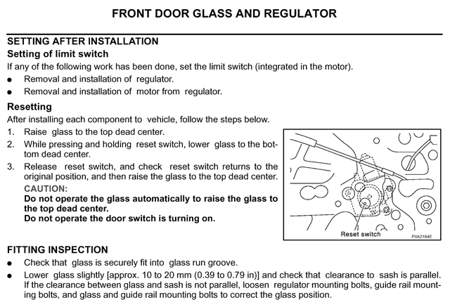

Do it yourself

I just tried doing that reset thing and it didnt work. When the window got to the bottom, it would not go back up. I finally got it to by holding the reset button in and raising the window. This did not fix the problem. It still only drops like 1/16". Will this cause any problems in the future?
